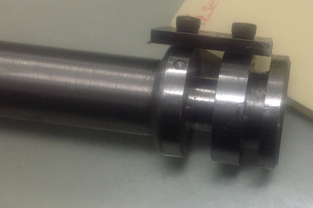

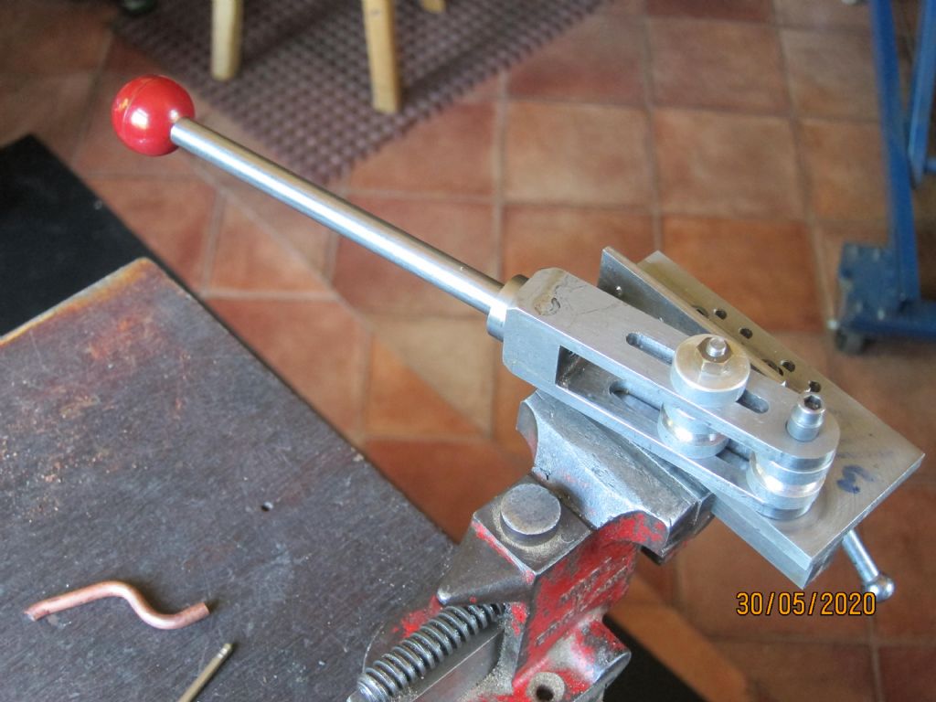

      Hi – I am having problems forming a smooth 'S' bend in 3/16" dia copper pipe (ex EKP supplies) for my boiler top feed arrangements. I want to put a bend in at one end of a relatively long pipe run, (24&quot in order to keep the number of intervening joints to a minimum but am having the usual problems of flattening on the inside of the bends despite using a conventonal pipe bender. With short lengths I would usually use a low melting point alloy which overcomes the flattening problem but this is not so practical on longer lengths of pipe. Any suggestions that might be improve my chances of success?

                            #476096
                            Greensands
                              @greensands
                              Photo of current pipe bender
                              #476099
                              Martin Connelly
                                @martinconnelly55370
                                I think at least you need a former on the back of the tube as used on plumber's 15/22mm bending tools.

                                              Emgee
                                                @emgee
                                                Greensands
                                                Do you keep the moving roller down tight to the fixed former when bending ?
                                                Do the grooves make a complete circular shape equal to the pipe OD ?
                                                If the above lines are true then with annealed tube you should get good bends at the radius required.

                                                #479711
                                                Simon Collier
                                                  @simoncollier74340
                                                  Make deep grooves with parting tool into which your tube is a very close fit. Anneal tube and bend tube by hand, with jig in the vice. This one is for 1/4 and 5/32 copper tube. The tube sides are constrained so cannot flatten.
