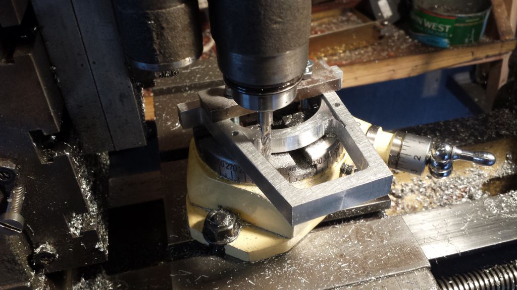

      20181004_150906.jpgI recently bought a mini rotary table. see photos
      Today I was milling a curve in the aperture of engine frame.

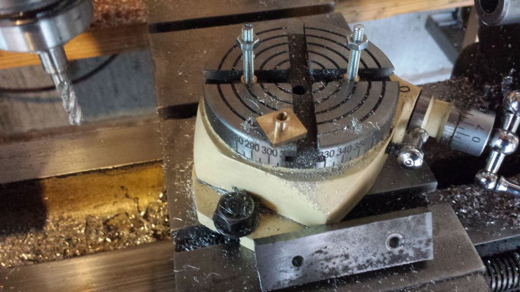

      My problem is that with the set up I had when I tightened the nuts the table became very stiff and it was really difficult to turn the handle on the table.
      As you can see i have brass tee nuts, 4mm thread, which accept 4mm studding. the bar which goes across the frame is 1/4" m.s.
      The more I tightened the nuts the stiffer the table. It feels like the tightening is distorting the table and thus creating unwanted friction between the table and base. That to me is illogical but I'm stumped for any other answer.

          If you place a clock gauge on the rotab and with the base on the mill as a reference, watch the clock as you tighten the clamps….if the pointer moves….
          #374537
            I can't account for that, but two thoughts:
            • check that the studding can't turn beyond the base of the brass T-nuts and press on the base of the table as you tighten up.
            • A nastier possibility is that the table has been damaged cutting the curve. Quite a few reports of bigger tables than yours coming to a sticky end when being used that way on steel – the gears inside aren't all that tough. If all else fails, you might have to look inside.
            Hope it's something trivial!
            #374551
              Where do you have the packing pieces that are lifting the work off the table? you are less likely to distort the table if they are directly below the points where your 1/4" clamping plate is placed. I would usually put something over the whole area that won't hurt the cutter such as 6mm MDF or a bit of rigid PVC sheet.

                Sounds a lot like the same problem that can occur when you tighten the T-nuts too much on a cross-slide Geoff (like a Myford for instance). The answer there (and perhaps to your rotary problem) is to make a sub-table. I have them for my lathes and mills – partly so I can attach things that don't normally fit the holes/slots – but also so I can really tighten work down to them (and sometimes to move work (& table) between machines without disturbing the work setting (by referencing the table).
                I haven't made any for my rotaries yet – but if I had this problem with one – I think it would the first thing I'd try. They don't have to be anything fancy and are very useful once made.

                geoff walker 1
                  @geoffwalker1
                  Hi All
                  Big thank you for all your replies, all of which are really helpful.
                  A little experiment last night revealed that clamping pressure on the outside of the rim causes the table to lock, when it's nearer the centre there is no problem. I set up a dial gauge as John suggested and you see the finger move as the table flexes, not much but enough to tighten it up. It's very frustrating, I'll have a good look at it this weekend.
                  Really like the idea of a sub table, I have one for my lathe cross slide, they are a good idea. It might help to even the load across the table

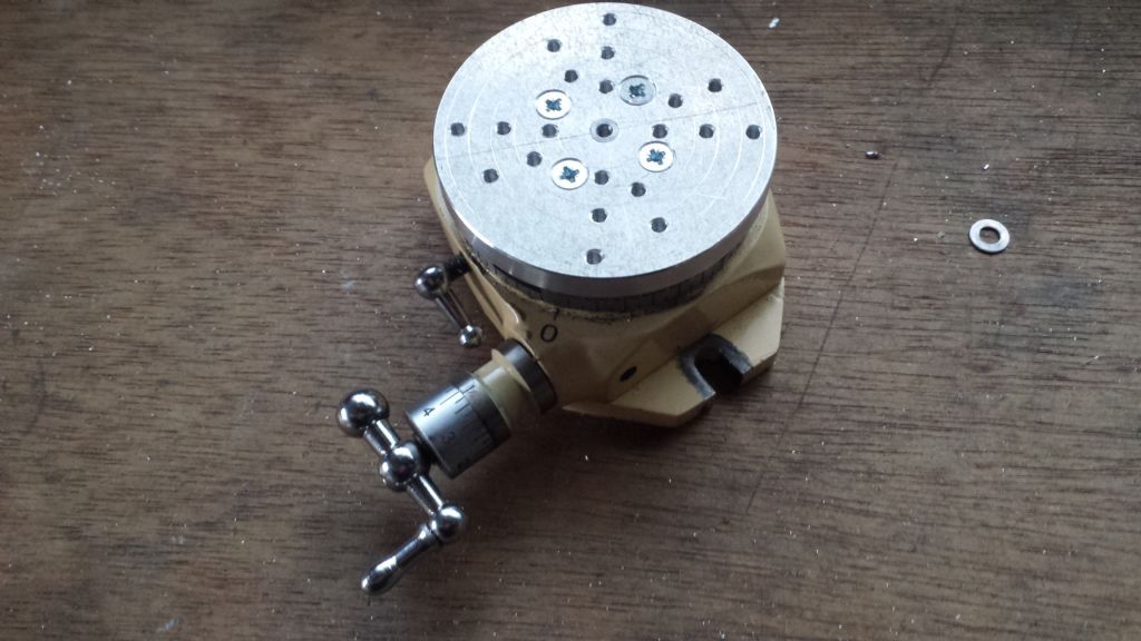

                  #375029
                  geoff walker 1
                    @geoffwalker1
                    Hi All,
                    I have to say I was really disappointed with this little table of mine.
                    I didn't expect to have the problem I had. Having said that it was "cheap as chips" so I suppose you get what you pay for!!
                    Anyway I took Ian T's advice and made a small sub table. This is secured firmly by 4 screws nearer to the centre of the table. The underside of the sub table is relieved 3/4" in from the perimeter so no pressure is applied to the outer rim of the table.
                    No binding or flexing problems now and it should be ok for the work I have planned.
                    Geoff

                      #375060
                      geoff walker 1
                        @geoffwalker1
                        Hi Ian, Michael,
                        I do remain intrigued as to the original 'failure mode' though …
                        It's not really a failure as such Michael. The unit is generally well designed the action is very smooth with very little backlash. The problem as I see it is the outer rim of the table has very thin section whereas the inner part of the table has a boss underneath which stiffens it up. If you look at the set up in the earlier photo you can see that the engine frame is bearing down hard on the outer rim. This combined with the upward thrust of the tee nut is causing the rim to flex, not much, but enough to create friction between the table and the base. It's a design fault, if the outer rim was a little thicker I don't think there would be problem.

                              If bolting a part to the table makes it flex, then either the table or the part isn't flat. I'd be bluing the table up to see if it was pringle-shaped first off.
                              #375097
                              IanT
                                @iant
                                A good point Pete – but even if the table is perfectly flat – the work usually isn't – and that's before you start applying clamps, straps & packing to attach that part to the table (or cross-slide etc) being used. Quite apart from the other benefits of using sub-tables – a lot of machinery designed for hobby use just isn't that "heavy-duty" in nature – sub-tables can help rectify this deficiency and reduce the possibility of causing damage (like to the T-slots for instance).
