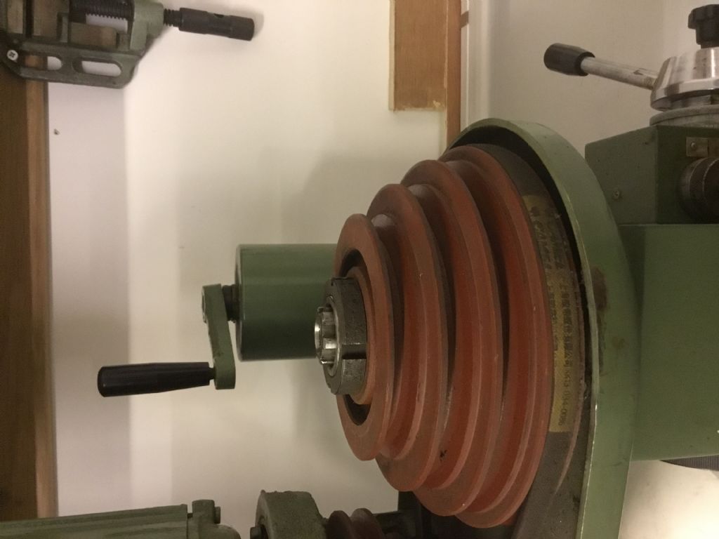

            Hi Russell wondering if you can help, not much info on these mill on the net. I get poor finish but think it is operator error, which I am working on, however noticed the nut on top of pullies was lose, I assume it is only to keep them on, but not sure if they do something else
            #335953
            Dullnote
              @dullnote
              Sorry thought I added photo done now2e8b7f06-678d-447e-9990-98e5cf2aade3.jpeg
              #335957
                My guess is that nut is what preloads your spindle bearings, so if loose it could be the cause of your woes.
                Check carefully before adjusting, they sometimes have a grub screw for locking and not loosening this will ruin the threads.

                    I don't think that nut is for spindle pre-loading. On my mill it is done up pretty tight. I have just loosened it to check and the spindle doesn't become loose so re-tightened it hard.
                    I must say that it is not a very rigid machine and I struggled to get a good finish at first. The single phase motor and short belt drive causes a fair bit of vibration. I replaced it with a three phase motor and VFD and get a much better finish. Really sharp endmills also help as do correct speeds and steady feeding.
