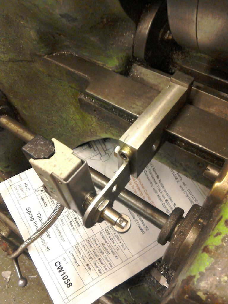

                I use a clamp on limit switch for negative Z axis moves. The option of using collets or a chuck makes a fixed one problematic as mentioned by John. I use this for homing/limits once the setup is done so that any error or overnight shutdown can be recovered from with minimal effort. You could easily mount fixed ones on the X axis and moveable ones on the z axis and then not worry about soft limits, just need to remember to set them up after things like chuck changes.
                Martin C

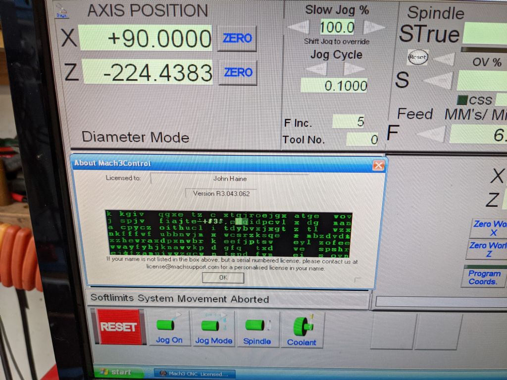

                  Well I just checked on my lathe which is in diameter mode and soft limits work on both X and z axes exactly as expected. This may be version dependent, I am using R3.043.062 which I believe is the latest recommended for Turn as it supports threading correctly.
                  Edited By John Haine on 03/04/2021 10:22:33

                      And looking again at your first post, note that your zero home position is at a soft limit. You need to make sure that the soft limit range brackets the machine coordinate zeros.
