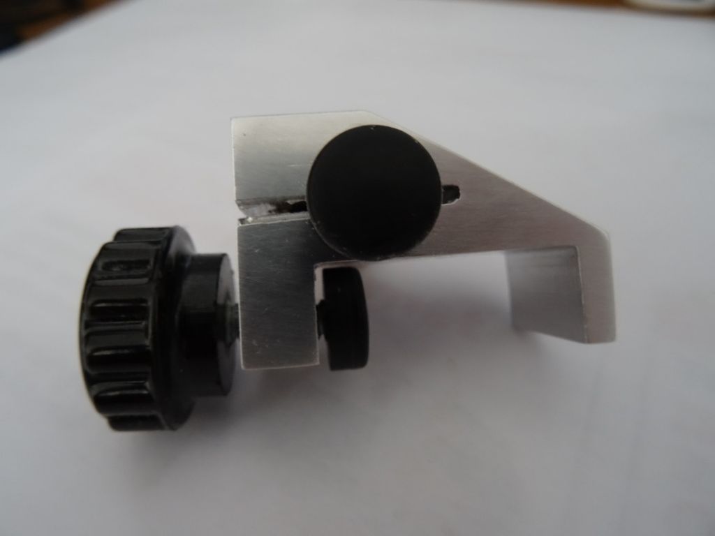

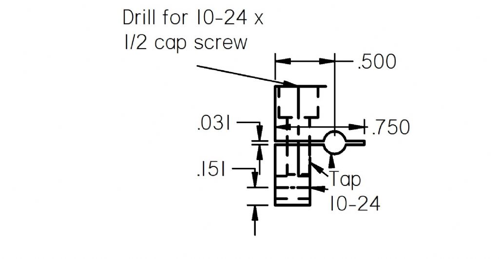

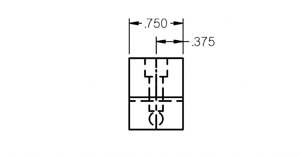

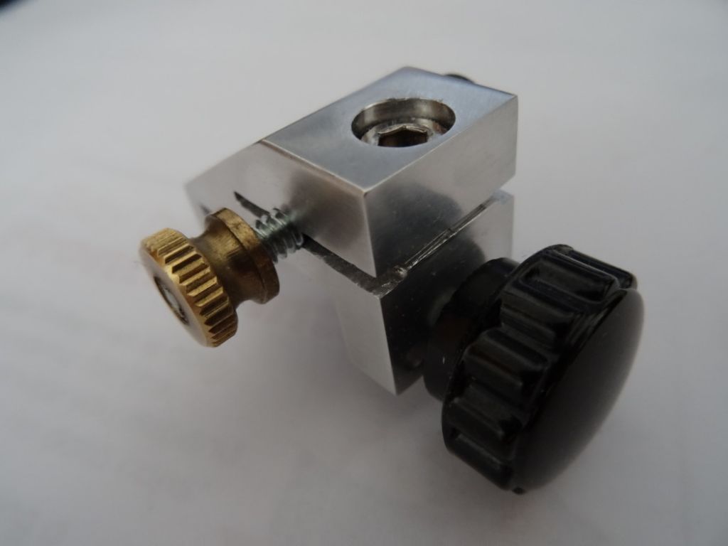

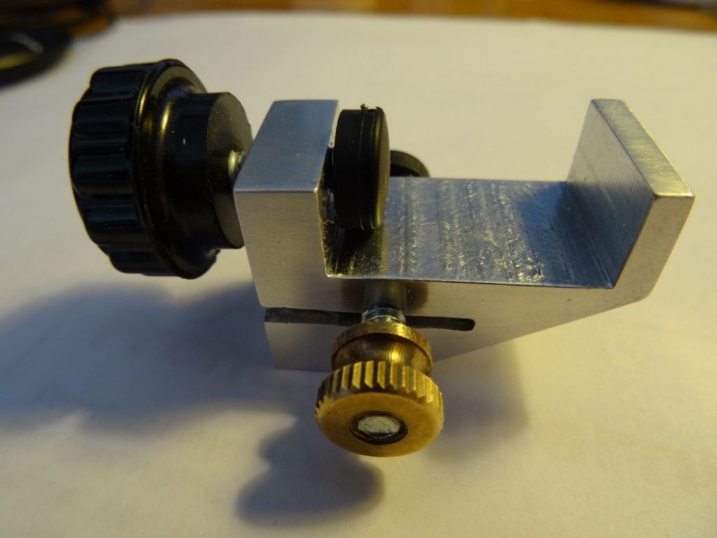

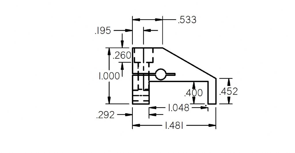

      prazi carraige stop3.jpgprazi carraige stop1.jpgprazi carraige stop2.jpgdsc00536carriage stop7.jpgdsc00532carriage stop5.jpgSo after making the handles it seemed time to make a carriage lock. Here are pics and dimensioned drawings.
      The round black locking pads are a very hard plastic that I tapped to accept 10-24 screws. After tapping them I put super glue around the edge of the cover and closed it so when they get screwed on to the threaded adjustment screws the cover won't pop open.
