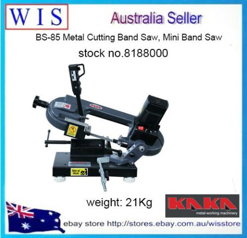

                                Paul Lousick
                                  @paullousick59116
                                  JA,
                                  I use one of these weekly and it will cut 4" steel. It is compact, sits on top of a milk crate as a stand and can be picked up with one hand.
                                  Paul.

                                      Paul Lousick
                                        @paullousick59116
                                        Hi JA,
                                        Not sure of the make. I biught it about 6 -7 years ago from an ebay seller in Australia and the name has come off. There are a few advertised on ebay.
                                        The round item in my pevious post is a tube of bees wax, used to lubricate the blade.  The saw had done a lot of work and still performs well. Only had to replace the blade guide rollers which are only standard ball bearings.
                                        I paid about A$350 but now they are normally selling for about A$650.  Just found this one advertised for A$396.
                                        **LINK**
                                        Paul
                                        Edited By Paul Lousick on 27/08/2020 23:31:56
