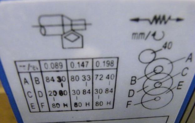

      I have used my lathe before for threading by adding the correct drive wheels and engaging the half nut.
      I was wondering if it was possible to fit the drive wheels in such a way to just give you a constant slow feed for facing cuts.
      Hope this makes sense.

        Ady1
          @ady1
          Very useful, gives a nice finish
          set your changewheels for 100+ TPI kind of thing, experiment on a bit of scrap
          use your tailstock centre for best results

            The answer for most lathes is yes. Some have a selector for fast and slow travel, it depends on the lathe and its features. If you identify which lathe you have you will get a more accurate answer.

              Assuming you still have the same lathe as the one in your album, isn't that the second photo tpi2 ??

                  As Peak says if you still have the lathe in the photos set up the gears as per the top chart for feeds, I'd try the 0.089mm/rev first

                      The one in the photo does not have power X-feed so just set it up for what turning feed rate you want and face by hand.
                      Thats the good thing about the 250-280-290, the front lever gives you 3 rates of shaft rotation which equates to two facing and two turning without having to change the gear train.

                        Yes, I still have the same lathe as the one pictured.
                        I was wanting it set up to turn the outside parallel and hopefully get a better finish. I would face off by hand.

                          Just set it up as per my post earlier using the top chart on the front of the lathe

                            Ok I will try setting it up as you suggest.

                                For finish turning, the feed rate / rev needs to be as small as possible.
                                Think of it as for cutting a screw thread with the finest possible pitch. So the 0.089 mm /rev will give a feed rate of 0.00352 / rev in Imperial units, equating to a little over 285 tpi.
                                A carbide tip may not like such a fine feed combined with a shallow depth of cut. A HSS tool, especially with a small radius should produce a good finish.

                                        Thanks for the replies.
                                        All the time I have had this lathe and it never dawned on me up till now that the numbers of the change wheels in the top set of figures are for cutting speeds. What a numpty I am.
