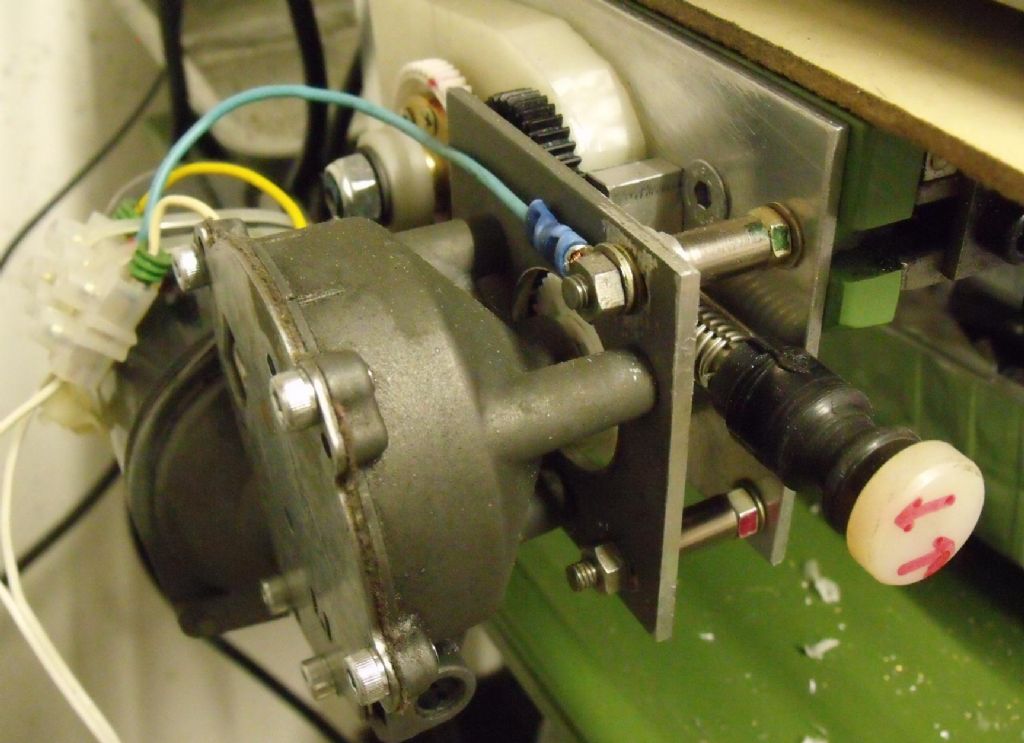

            John Baron
              @johnbaron31275
              Hi Guys,
              I made a mill table drive using a salvaged car window wiper motor. It can easily be powered from an old computer PSU. Using the gearing that I used, at 7 to 8 volts it takes about 2 amps.
              The white knob pulls back to allow direction changes with a neutral position in the middle. It is a simple dog in a slot mechanism. The wiper motor is dual speed, not that its needed since I actually use a variable voltage PSU and can crank up the voltage to 30 for fast traverse if I need to.
