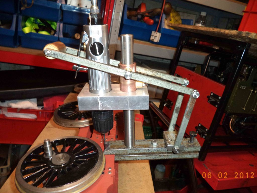

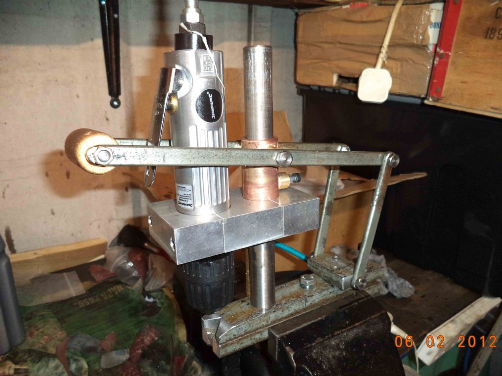

Just completed this clamping drill.
You can clamp the complete unit to a large work piece the idea is that I can use it to drill the frame of the 5" loco i'm building giving me greater control of the drilling operation.
It just comprises of a windy drill/die grinder attached to a large toolmakers, it slides up and down the pillar via a lever mechanism.
Cheers
