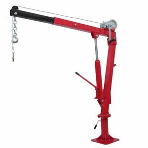

      Just browsing on the net and on eBay saw thus hoist. I just thought it may be useful to some members at a fairly low cost. It does need a good think about the base load fixing but there are ways round this but I can see it lifting a chuck or rotary table etc.
      Vidal truck hoist £199.99. Not connected to seller etc.
      David

        Clive Foster
          @clivefoster55965
          Hi David
          Thats an interesting device but waay to big and heavy for in workshop use. Basically its an engine crane on a rotating pillar. Looked at one like that for a project sometime back. As I recall things it was good for something over a ton at 5 ft jib extension.
          Realistically its made for the American "Good'Ole Boys" truck market so mostly overkill in Britain. We looked at it to mount on a trailer to help loading but dropped the idea as it all got too permanently engineered. Fit when needed being more appropriate.
          As I mentioned in a previous thread a lighter device, hundredweight + capacity or so, on a work cart would seem more appropriate. The work cart giving stability and mobility as well as being useful in its own right. I have a potential design roughed out but am stuck for the cable or strap winder. The inexpensive winches are too big and cumbersome. The crane needs to fold up neatly and not get in the way. A ratchet strap is an appropriate size but those only work one way. What I need is a 1/4 scale or thereabouts come-along.

                                Howard Lewis
                                  @howardlewis46836
                                  The device shown has only a small baseplate, so the load, via the baseplate imposes a large vertical tensile load onto the floor fixings, Depending upon the orientation of the load, the load could all be borne by only one fixing.
                                  So it bis imperative that the fixings are securely fixed to the floor, with ground anchors, such as Rawlbolts, in concrete floors, or with a reinforcing plate beneath a wooden floor.
                                  Needless to say, the fixings should be the largest diameter possible and of the highest grade.
                                  My choice would be to fit thick load spreading washers under the bolt heads and nuts, as an additional safeguard..
                                  The conventional garage type of crane carries nearly all the load on the wheels at the front of the long legs, so is preferable, if space allows.
                                  Howard (aka fat Fingers )

                                      Jeff Dayman
                                        @jeffdayman43397
                                        If anyone does want to mount a plate mount hoist like David posted the pics of, just be sure of your concrete slab. I have seen some that were large in area and 6" to 8" thick. Obviously they would hold a huge bolted plate load if good slab mounting bolts as mentioned were used. However – I've also seen a few that were 1" thick where the owner thought they were 6" thick. The thin slabs would not be safe for a bolted plate load.
                                        If you have a look in youtube there are a number of videos about collapsing car lifts bolted to slabs. There are many things that can cause a bolted plate joint to pull off a slab.
                                        The engine hoist type of lift on rollers does give good flexibility for home shops. No risk of plate mount pulling off the slab with that.

                                              Paul Lousick
                                                @paullousick59116
                                                Lots of talk about CE markings and not being covered by insurance which is true. BUT like many posts on this forum, we have wanderred away from the original purpose of this post.which was a way of lifting a chuck or rotary table onto the mill table.
                                                These truck hoists are designed to lift in excess of 400kg. A rotary table or chuck (for home use) would be less than 40kg. The safety factor of it failing is very low. Is it any more dangerous than making your own hoist or using a block and tackle system in your workshop ?
                                                Personaly, I would not use it, not because it would be unsafe but because it would take up valuable floor space and prefer a ceiling mounted rail or swing type hoist which has a moving trolley. The truck hoist can only lift and swing in an arc. There is no axial movement to position the load after lifting.

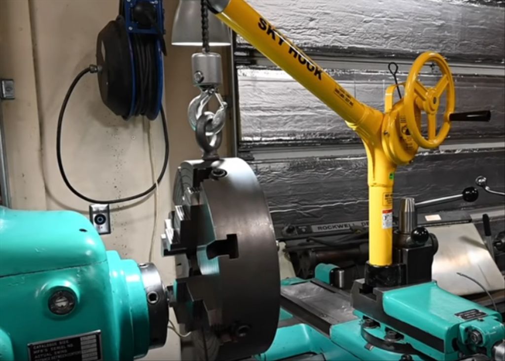

                                                Paul Lousick
                                                  @paullousick59116
                                                  Another idea for a compact hoist for lifting chucks or work onto a lathe or mill. Lifting capacity would be limited to the size, weight of the lathe or mill and how securely it was mounted.
                                                  Paul.

                                                  Hopper
                                                    @hopper
                                                    Not sure if I'd want that sort of stress on the topslide of my lathe or that T slot though?
                                                    Maybe a large base that clamps to the main bed ways like a fixed steady might spread the load to more solid parts of the machine?
