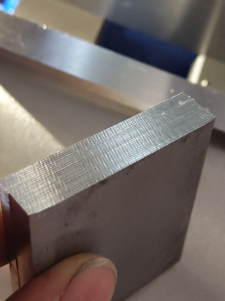

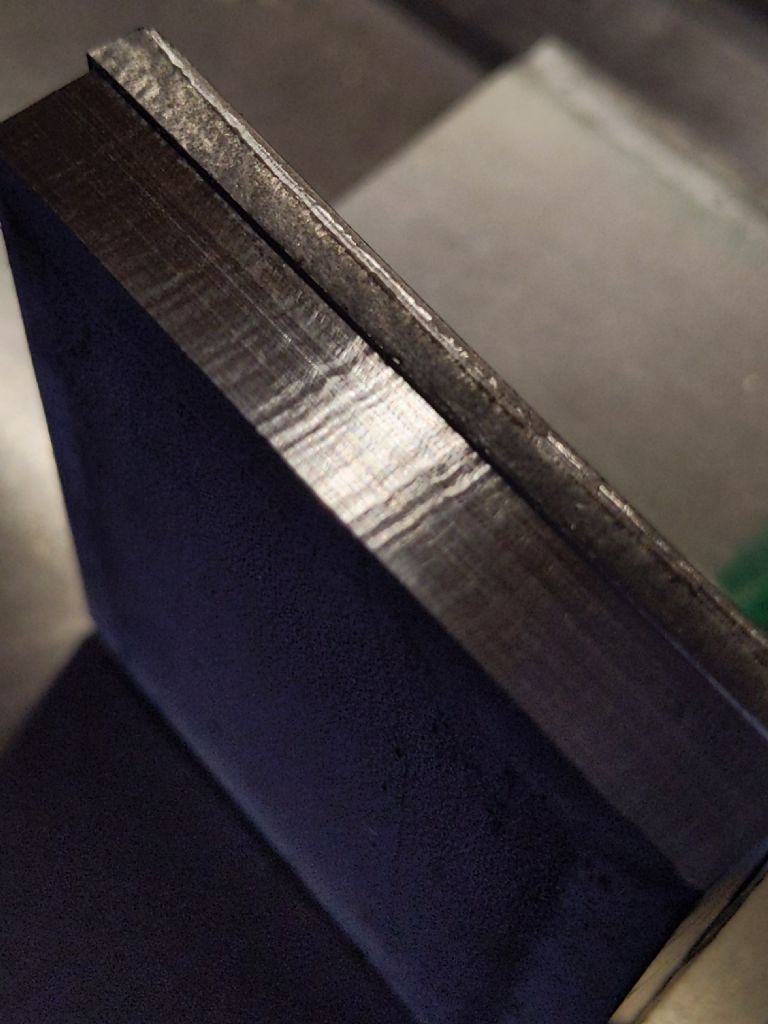

      Is it possible to achieve smooth surfaces when cutting with the side of an end mill in stainless steel (316)?
      I have been able to get very acceptable smooth finishes on the lathe, but the finish on the mill is very uneven – reticulated might be the right word to describe it, and difficult to sand out. I'm not sure if this is user error, chatter or perfectly normal?
      I'm using as little tool stickout as possible in an ER32 collet, one was a 10mm the other a 5mm end mill.
      I also tried eliminating the vice but had similar results with the work bolted direct to the table.
      The only thing I've noticed is a knocking from the upper part of the spindle with it in neutral and rotating by hand, and some flex in the column of about +/-0.075mm at the collet pushing it by hand. No idea if either is normal or not.
      Perhaps my expectations are too high?
      Here are some pics
      Another piece after a quick sand to see how deep the lines are.pxl_20230704_113744183.jpgEdited By s d on 04/07/2023 12:56:22

          A few more details would help such as vertical height being cut, amount of sideways depth of cut, spindle speed and feed rate for both cutters as well as hss or carbide and number of flutes and also what mill is it.

            Posted by JasonB on 04/07/2023 13:02:45:
            Edited By JasonB on 04/07/2023 13:03:38
            Yes of course…
            Chester v30 Mill, similar to Warco WM18 I believe?
            4 flute end mills
            10mm is 30 degree helix AlCrN coated HSS
            5mm (actually it was 6mm) is 30 degree helix TIAIN coated HSS
            (I do have some in carbide which I haven't tried yet)
            Speed about 2000rpm, but it varied it and it didn't make much difference.
            Manually feeding cuts about 8-12mm vertical, depth of cut maybe up to about 0.3mm, again it varied.

              Of the austenitic stainless steels 303 and 316 machine very well, but for some reason 304 is a pig. It is possible to get a good finish on 316. However I can see a number of potential issues.
              First what is the provenance of the cutters, manufacturer and supplier?
              For a 10mm HSS cutter 2000rpm is way too fast, should be more like 500rpm, and that's based on recommended speeds for industry.
              Work hardening is a real problem with 316. Taking a relatively shallow depth of cut means you need to feed faster than one might expect due to chip thinning.
              The play in the column seems excessive to me.
              I suspect the mill simply isn't rigid enough to take the cuts especially with conventional milling where the cutter will be rubbing at the start of the cut. Which is death to the cutter and the finish. It helps to climb mill, although I don't know if the smaller mills will be up to that?
              Andrew

                Great info, thanks Andrew.
                I haven't tried anything near 500 rpm, so I'll test that next.
                The mill is about 260kg. I was surprised about the amount of flex too. It's not in the spindle or collet or tool (measuring from the head housing to the tool), that all seems very rigid. But measuring off the table, it doesn't take much human effort to flex the column, pushing either the spindle or the top of the column itself.
                Experience is in short supply here, so accounting for workhardening is going to be a tricky for me to manage. Need to put in the hours (and days and weeks)!
                I tried climb milling and did get slightly more consistent finish, but still the reticulation. Could it be not enough flute engagement? Not taking deep enough cuts to keep a constant pressure causing the tool to bounce?
                Milling seems to be much trickier than turning.
                Tools are from ARC in the UK, their own branded stuff. Maybe I should look at getting better cutters.

                                SD's photos show, I think, the result of work-hardening. Rather than cutting, the cutter is rubbing and bouncing along the surface. Rubbing hardens the surface so effectively that HSS struggles to penetrate and is rapidly blunted, the end.
                                All is not lost! The finish can be improved by using an inexpensive Belt Sander like this example as a Linisher:
                                Not sure what others find, but in my workshop milling and lathe cut surfaces often benefit from a mild abrasive touch-up. Depends on the material, but ordinary mild-steel usually gets a licking because it's a bit smeary. Leaded mild-steel, 6082 Ali and Brass are more likely to come clean off the machine.

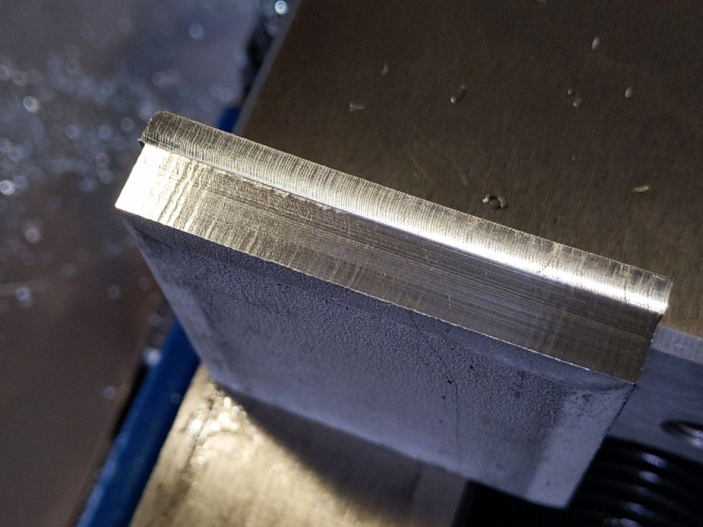

                                            Probably to be expected but face milling produces clean results (well, acceptable enough as a starting point).
                                            EDIT: buried the 6mm to the top of the flutes and got the same result. Cutting on all three passes in 316.

                                                s d
                                                  @sd79178
                                                  So here's the facing vs side milling. I'm happy enough with the face finish, those ridges are fairly even and the surface feels smooth. This is with a 10mm rougher (the side milling was with the 6mm HSS 3F I think).
                                                  The rougher doing side milling is better than the other tools, it's much more regular, but still has those vertical dents.
