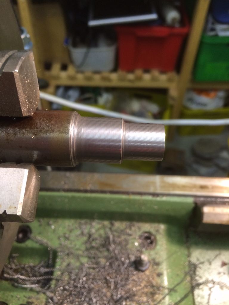

        image.jpgHi all,
        Today I finally got to set up my new (bought last May but only just installed) Warco GH1232 lathe. I spent quite a long time levelling the lathe then decided to put a piece of 1" mild steel in the 3 jaw chuck and have a play.
        To cut a long story short I am getting an odd spiral surface pattern on the workpiece as shown in the photo. The best way to describe it wouldn't be like the appearance of the red & white spiralled signs that you occasionally still see outside Barbers shops.
        I have tried a newly sharpened HSS tangential tool and also a new carbide insert and both give similar results. I've also tried substituting the mild steel with brass but still get a similar result. Changing speeds, feeds and depth of cut seems to make little difference. Gibs all seem correctly adjusted, tool securely clamped in a heavy duty QC tool holder and set nicely on centre height. The spiral pattern shown occurs when using power feed but a similar but not so regular finish occurs when feeding the tool manually with the saddle feed wheel.
        The piece of stock shown is approx 1" diameter and the finish shown was with the HSS tool running at 300rpm 0.003"/rev feed & 0.010" depth of cut. Any ideas as to how to improve the finish would be gratefully received.
        Regards, Martin.

          Is the pitch of the helix pattern on the work-piece the same as that of your leadscrew ?
          My Myford was doing something similar exept the pattern was a series of rings on the same pitch as the leadscrew but not a helix, I messed around with the leadscrew and halfnuts for ages with no improvement. It eventually turned out the saddle gibs needed adjusting and the problem disappeared.
          The helix pattern suggests some vibration, maybe in the head stock bearings ?

            Martin, I bought a 1236 in January and upon taking a half decent cut I experienced serious chatter and similar patterns on work. This was all due to none of the gibs and slides being adjusted correctly, in other words they were all loose and the problems dissapeared when I got it adjusted correctly. Hope this helps.

              I had exactly the same problem when I first got my Boxford ME10. The problem was caused (at least in my case, by motor vibrations through the drive belts. I found that if I slacked of the tension the helix pattern disappeared. But then there was insufficient power to the spindle. I read a suggestion that the linked belts, NutLink is one brand, gave a smoother transmission than the solid belts fitted as standard. Fitted the link belts and problem gone.

                    Well, I've spent this evening checking jib adjustments, headstock bearing adjustments and various combinations of slack & tight drive belts and cannot get the surface finish to improve although the pitch of the helix changes between a slack or a tight belt. I have even tried running with just one belt instead of two as one appears to be slightly tighter than the other when fitted together. I've tried both manual and power feed with the saddle and neither makes any significant difference. Running my DTI across the helix shows a difference in depth from crest to trough of just under 0.001".
                    Any further suggestions would be gratefully received. In the meantime I think I will phone Warco tomorrow and see if they can shed any light on the problem.

                          I had similar marks on MS and aluminium when I had movement in the spindle on a home made lathe. I was wondering though if you would get the same pattern if you take a cut with your compound slide?
                          …or whether the gearing on your saddle might be meshed too tightly with the rack causing a slight flexing as the teeth mesh along the rack?

                            Yup. spindle trubbles
                            Looks just like engine turning

                              The problem is we've all seen that pattern, as it can be caused by a multitude of issues – anything that causes the cut to vary over a regular interval.

                                                  It may be a bit of a last resort but I'm wondering if that could be 'single phase motor vibration' – a pattern from torsional vibrations feeding through from cogging. Bit impractical to suggest trying a three phase alternative but as per this PM thread:

                                                    It’s definitely cyclic.
                                                    Could you not work out the frequency from the diameter, rpm and spacing of the pattern ?
                                                    If it’s a multiple of 50hz, then I would have thought – like Bikepete – it was motor related.
                                                    Or… another idea…. a off centre cog somewhere in the feed gear train ?

                                                      Thanks again guys for all the suggestions. Further to my phone call to Warco last week it was suggested that I tried turning something between centres to see if the pattern was replicated using that turning method. So, with that in mind I set aside Saturday afternoon for a play. I started by fitting the new 5-3mt reducer into the cleaned headstock taper and then fitted a brand new centre into the reducer. On turning on the lathe there was a visible wobble at the tip of the centre, my DTI registered a run out of 0.005" so I set over the top slide and skimmed the centre until it was running true. I have a centre drilled & surface ground test bar which I put between centres to check the tailstock alignment. Applying the DTI to the top of the bar highlighted that the tail stock centre is higher than the headstock, rising by 0.003" over 6" of travel towards the tailstock, not sure what I can do about that but that's another problem for another day.
                                                      Anyway, whilst the DTI was set up, I decided to mount it at the rear of the test bar and check for any movement of the needle as I ran the lathe at its slowest speed, happily there was only a barely perceptible movement of the needle, well below 0.001". I then decided to apply powered feed ( 0.003"/rev) to the carriage to mimic the path of the tool and immediately the DTI needle went crazy showing deflections of around 0.010-0.015" so rapidly that the needle was almost a blur. Disengage power feed and the deflection stopped, feeding the carriage manually caused the needle deflections again, infact just turning the carriage hand wheel to the point of taking up any backlash without actually moving the carriage gave the same result.
                                                      It appears to me that the motor is causing a severe vibration which is somehow transferring to the carriage when it is set in motion. By this time I had run out of available spare time to continue experimenting but have in mind to check the saddle gib adjustment again and perhaps to remove the motor belt completely and see if the problem replicates with just the motor running on its own. I am not sure that this phenomenon would cause the helix pattern on the work but it does seem a step in the right direction! Any comments would be gratefully received!
