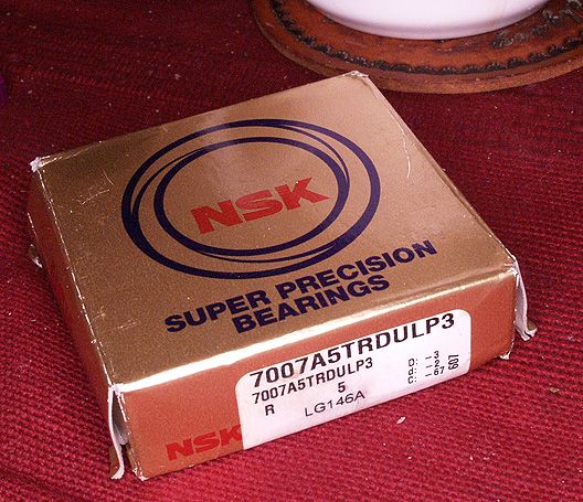

                  By the way, I would be interested to know where you were able to obtain NSK 7007A bearings in the UK. I couldn't find any but bought mine while passing through Hong Kong. I was offered two types, both marked NSK 7007A. One had a pressed steel cage like the Myford originals and the other, for the equivalent of a pound or so more, had a beautifully made machined brass cage. I chose the latter and went to the trouble of machining a thin wall tube to press the outer races in without subjecting the balls to any damage. They are totally silent in operation, unlike the steel caged bearings in electric motors.

                    Andrew: They were indeed difficult to find! As I recall, the problem was the 30 degree contact angle, which seemed to be out of fashion amongst the major manufacturers. 7007B (40 degrees) and 7007C (15 degrees) were more readily available, but I wanted to stick to the Myford original design, and didn't want to use bearings by some unknown manufacturer. I got the bearings from this company:
                    http://www.compassbearings.co.uk/
                    They're not far from me, and say they specialise in finding obsolete bearings! Well, they did find them:
                    but they were a) much higher precision than I wanted/needed, and b) bloody expensive – but I did get a very good discount, so not too bad! I too made a bearing puller to install them in the headstock.
