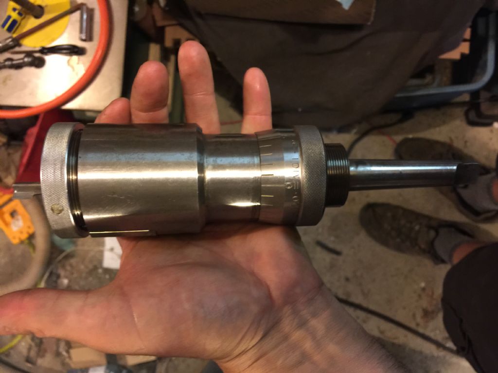

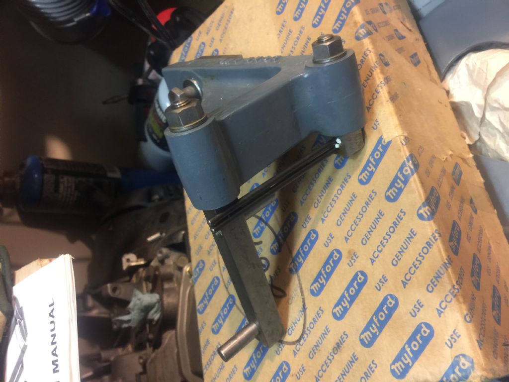

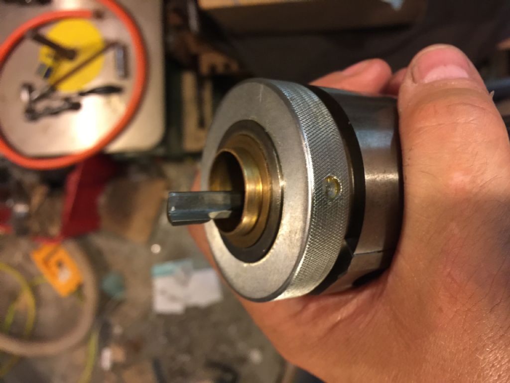

        Hi, I recently won these tools at an auction where I bought a lot of Myford stuff. There were box lots and I am not sure exactly what these tools are. Any help would be kindly appreciated.
        Wayne

          The first photo is the auto feed bracket from a Dore boring head ,the photo here shows the auto feed in operation ,hope you managed to get the boring head as well a useful piece of tooling to have.

            The other tool resembles an internal grooving or recessing tool. The flat end rests on the surface of the work. The pilot centers it in the hole. As the rotating machine spindle is advanced the cutter moves outward to cut a groove. Cogsdill is one source.
            https://cogsdill.com/products/recessing-tools/ar-series/
