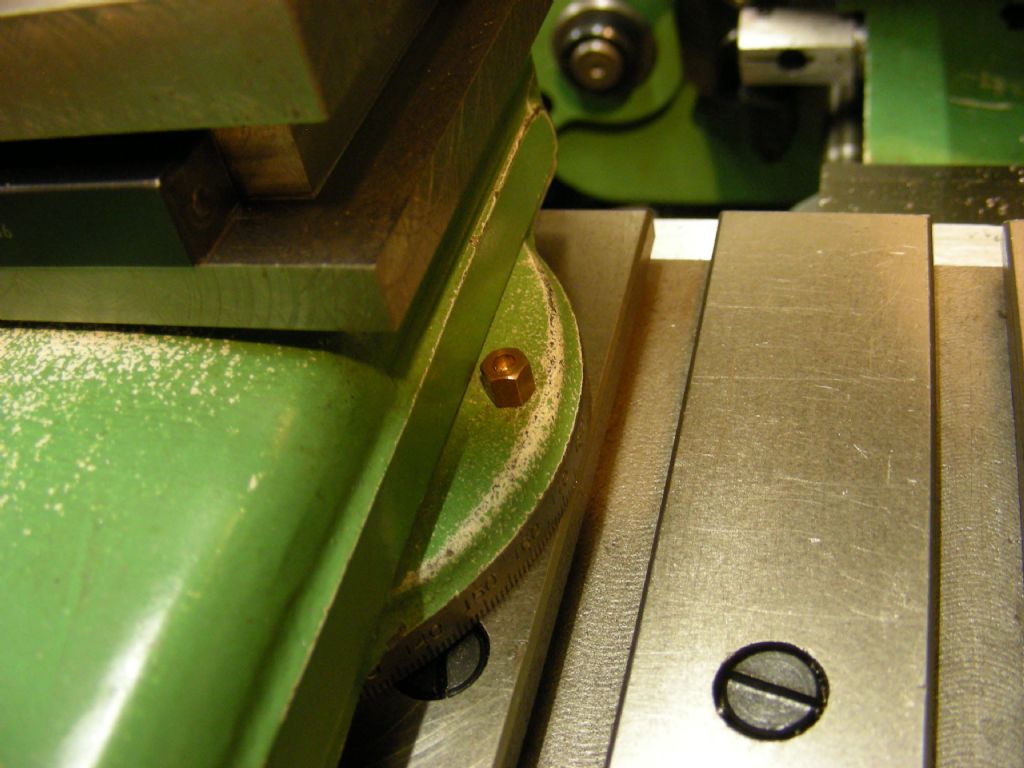

                  You mean one like this – has been on my 60 year old S7 for a long time. These days pliers are needed to remove it, hence gnarled appearance! The white bit is plastic channel to keep swarf out of the unused T-slot.
                  I would recommend you buy the proper tapered plugs to lock the topslide though.

                        The plugs are available from Myford – **LINK** for the right hand one – don't forget they are handed left and right.
                        Probably just as effective would be a bit of brass round bar, say 3/4" long of 3/8", with the end cut off at a 60 degree angle. But is it worth the trouble at the price?

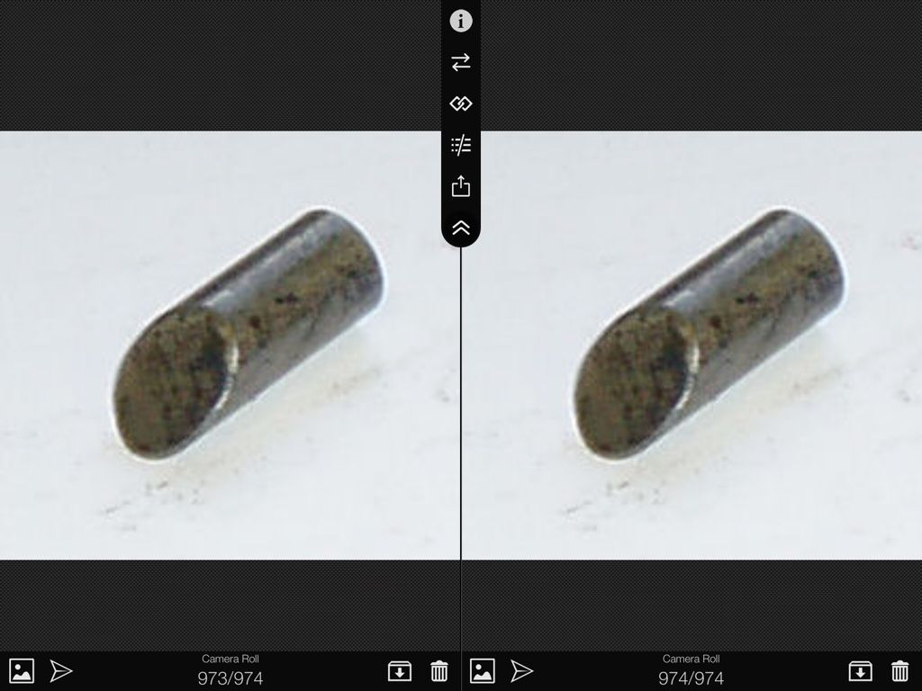

                          #315279
                            O.K. … I have to ask:
                            Is there really a difference between the Left and Right versions of this item
                            … or is it like having a left-handed teacup. question
                            Myford lists two items, and uses pictures with different file-names
                            … but the two images are visually identical.
                            [with an ML7R, so innocent in the ways of Super 7]

                                    "Is there really a difference between the Left and Right versions of this item"
                                    Yes there is. Not visible in photographs, (and even difficult to see when you've got one in your hand) but there is a slight curve across the face of the plug, slightly diagonally, so that it seats on the topslide spigot properly. So the diagonal on the left hand is opposite to the one on the right hand. Because of the taper on spigot and plug the plug not only presses against the spigot but draws it down so the topslide is pressed against the crossslide.
                                    What looks like a simple plug is quite cleverly thought out.

                                    #315299
                                      Posted by Nigel B on 05/09/2017 08:40:06:
                                      … It has been a while since I had mine apart, but I seem to recall that the ends of the clamp pads are cut differently – the use of one photo for two part listings is probably laziness, as the original Super 7 parts list has them as different part numbers and describes them as handed.
                                      Thanks for that, Nigel [and Robbo]
                                      … it says a lot.

                                          Here is my version of the taper pinned topslide:
                                          I think I got the idea from Sparey's excellent book but couldn't find the reference just now. My small taper pin is rather fiddly and I have been meaning to install a larger one (the "meat" here is rather limited, however).
                                          My machine is about the same age as Robbo's but is mutton dressed up as lamb; I went for Myford green when refinishing many years ago.
                                          I, too, think that the thrust pads are handed and made the point about not inadvertently swapping them in a post in an earlier thread. The pads contact the male taper at a tangent, as it were.
