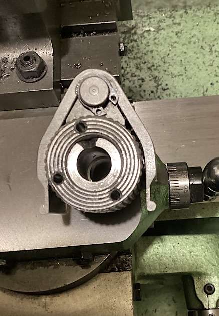

      A bit of advice please, I have made a new post for the Multifix size Aa on my Myford and as I didn’t use the steady pin initially I thought I would do it as I have it apart, underneath are three equally spaced holes although I only need one but am not sure how to get one in the correct place in the compound if it’s slightly out the holder won’t be square to the headstock , I know the Multifix will tour but it could be possible to get the hole half a hole out so if anyone has a suggestion or has already done it would be much appreciated , hope that makes sense.

        I forgot to add picture it is the underneath.IMG_2324

            Do the three holes go all the way through to the top? Or are they blind holes?
            Could you make one of them into a through hole, at reduced diameter (maybe 1/8″) if necessary?
            With a through hole you can put a short transfer punch into the larger blind hole, turn the toolpost over and align it. Push a piece of 1/8″ rod through the small hole from the top and biff it with a hammer so the transfer punch makes a mark where the pin should be.
            Make a thin sheet metal template of the bottom of the toolpost complete with one hole. Loosely dowel it to the toolpost. Fix the toolpost down and align it. Clamp the template to the compound so it does not move and remove the toolpost. Use the hole in the template to tell you where to drill for the pin.
            #714141
            Dell
              @dell
              They are blind holes and it would be difficult to drill a through hole because it is very hard.

                      Edit: in Dell’s picture above, the leftmost hole is the 1800 one in my words above.

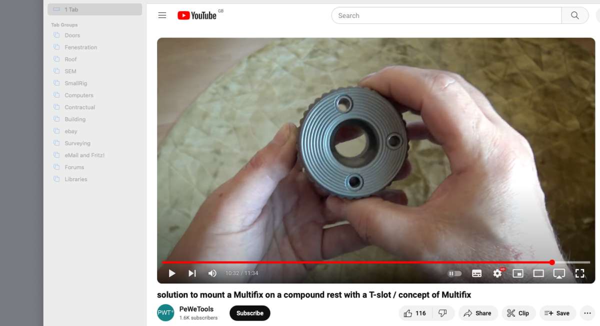

                      #714179
                        Video, from Herr PeWe himself:
                        https://youtu.be/4NKDlcb_Ysk?feature=shared
                        … the last couple of minutes clarify it all

                            The holes on the part in the video are through holes.

                            #714304
                              Blink and You’ll miss it, but here’s the frame:
                              Screenshot 2024-02-14 at 16.46.17
