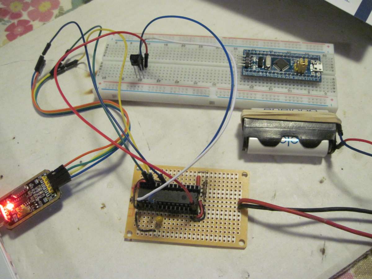

        Hi Duncan, there’s a pin on the PET (pin 4) which selects either RS232 or TTL output.  Obviously the RS232 isn’t to voltage specs but anyway you want TTL which needs +5V.
        Then you need a serial to USB converter of which there are many around, I can’t recall which make I got but I’ll have a look tomorrow.  It’s a little board with a 6 (?) way female header so you can plug it onto a pin header on the board carrying the picPET.  Once I realised that the data out on the PET (p3) needs to go to data in on the adapter it sprang into life.  Powered over the USB connection which I plug into a Pi.

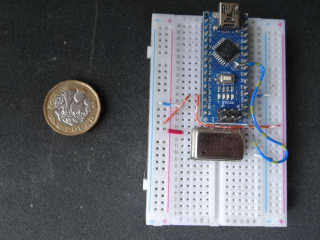

                This is what my ardPET does.  It’s a precision event timer implemented on an Arduino.  Several advantages over a picPET and a few disadvantages, but:
                • runs on Nano, Uno, Leonardo, microPro and Mega2560
                • Programmed in C using the Arduino-IDE, source code here
                • serial interface on USB
                • 2 to 4 PETS available per chip
                • other functionality can be added – the PET function can be a sub-part of a larger project.
                Like picPET, accuracy and precision depend only on the quality of the resonator, several options available.  In the example below I cut the nasty ceramic resonator off the board and wired a 20MHz TCXO instead.  It provides twice the resolution of a 10MHz picPET. (Thanks again to the forum friend who sent me the TCXO!)
                A bog-standard Leonardo gives reasonable results because it’s resonator is a quartz crystal, if that’s “good enough”.
                DSC06911
                The main advantage of ardPET is it can be extended.  Though I recommend it highly, picPET is only a Precision Event Timer, with limitations such as no USB!   My experimental clock, based on a Nano, implements two PETs.  One measures the actual frequency of the Arduino’s oscillator relative to a GPS second, AND uses the second PET to measure a pendulum’s period relative to the Arduino’s GPS calibrated resonator.  The Nano also detects beam break AND impulses the pendulum AND displays date-time AND reads temperature, pressure and humidity AND logs everything to a PC.   A Mega2560 can support up to 4 PETs.   Main disadvantages are Arduino modules being more expensive than picPET, and the owner has to operate the IDE.  Of course picPET costs rise if a pic-programmer has to be bought, perhaps £20, and that has a learning curve too.  Also, picPET requires a 10MHz oscillator, so some additional electronics needed – not difficult.

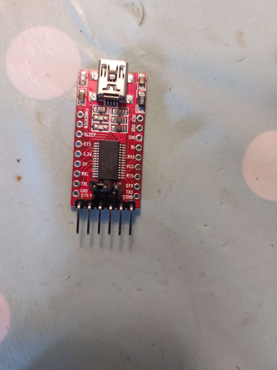

                  I’ve got 2 of these, which are used to program Arduino Pro Mini. The chip says 1412G, B8908572, FT 232RL. It communicates both ways, so one can program the chip and then serial print output to the Arduino IDE. Is it the same thing as above?

                    forgot the photo1000003208

                      The pro Mini has the same microcontroller as the Nano, Uno and Leonardo, so should run ardPET with no bother. It compiles and uploads in the same way as them.
                      Never seen a pro Mini in the flesh!   It’s designed “for applications and installations where space is premium and projects are made as permanent set ups“, meaning pins may have to be soldered on both sided of the board.   The space saving soldering is a little beginner unfriendly, but shouldn’t be difficult.
                      The other side of the board has the resonator, with luck it’s a quartz crystal.  The documentation doesn’t say!
