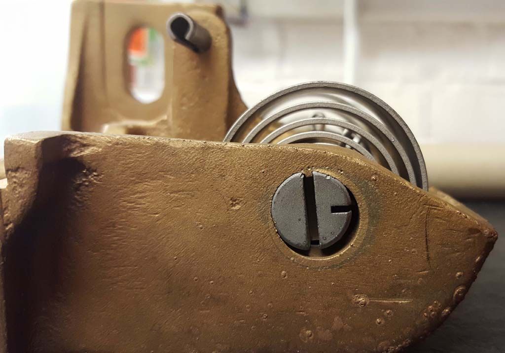

        I have been given a job to do from a pal of mine.
        He has a phosphor bronze casting with a steel pin in it. The holes for the pin have become worn and he wants me to make a couple of bushes, machine the casing and fit the bushes.
        What sort of interference fit should I go for?

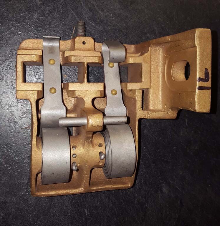

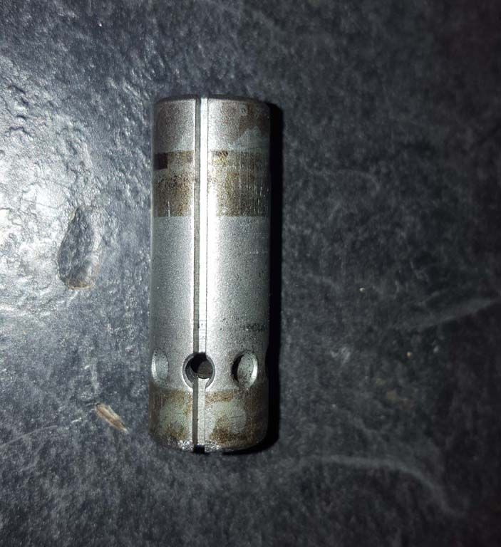

                  petro1head
                    @petro1head
                    Its a brush assembly for an electric traction motor off a train,
                    In the second photo you can see how the pin has warn into a repair that was done a few years ago.
                    The third photo is the pin which holds the spring in place and tensions it.
                    I was thinking about putting the bush in the freezer
                    Hope this helps
