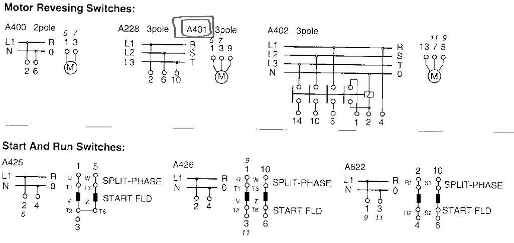

        G’day all
        I’m looking for any hints, tips, general or specific info on the Perfecto (powered) shaper. I have used a much larger version, years ago. in an evening class workshop but the Perfecto doesn’t quite fit into that category!!
        An additional, unrelated query – I wish to fit a reversing switch to a Worden grinder motor. The Worden build notes give good detail on the motor mods required and I now have a five core cable to wire it up. However the switch (Kraus and Naimer) wiring diagram is (to my untutored eyes) obscure – to say the least.!! My ‘wiggly amps’ expertise runs to standard 3 pin plugs with Live/ Neutral/ Earth annotations. The ‘Connecting diagrams’ for this switch offer six different versions (none for this model, specifically) and with connections marked, variously as L!, L2 , L3 and N. Is there a simple translation for these markings, please?
        TIA
        Bill

            Those connections are numbered for 3 phase! (Live 1,2,3 and a Neutral.)
            Somewhere in the book of words will be a wiring diagram to wire the switch for single phase and to reverse the connections to the capacitor.
            Look for a diagram that has Z and AZ  which are the capacitor connections and should tally with the motor, and that will be the one you need.
            I  assume you are connecting single phase.

                Unfortunately there is no ‘book of words’, just some 20 plus diagrams which give connections for all sorts of uses and various models but none of the motor connections are for this particular switch model number. Methinks it’s back to the seller for more info.

                      Jack you should find 5 connections on the motor.
                      You will have L.N and E or possibly U1 and U2 and an earth..
                      You should find 2 more marked Z and AZ or Z1 and Z2  These will be capacitor windings. For single phase one direction running you should find, in the connection box a metal bridge between one of the U connections to the motor windings, and one of the Z capacitor windings.
                      You may find a little plate on the motor with those symbols, or inside the connection cover.

                              If i could support Les on this.
                              A switch is a switch. Just because its marked up for 3 phase simply means its industrial grade. All you need to do is wire it right. Because you are simply making one contact against another.
                              I have a Brooks contactor for my Myford and that can be set for 3 or 1 phase. I had a separate rotary reverser and that could be used for either. And that is true of almost all htese industrial no volt release switches. For single phase you just don’t use some of the terminals.
                              Whoevers switch you use, all you are doing is taking off that link to  U1 in the motor and “replacing” it in the reversing switch. So I wouldn’t discard what is almost certainly a good switch and go buying a new and expensive one for no gain, especially when the new one is likely to be marked L1 L2 L3 etc and have a bit of paper with 20 diagrams!

                                Thank you again, gentlemen- particularly for your patience. I have scanned the diagram sheet (hopefully, the relevant bit) and will attempt to attach it. I have tried to highlight the specific model area with a (badly drawn) box. If you feel that you can translate it into terms suitable for my limited expertise, I would be very grateful

                                  Hi Bill & Meyrick,
                                                                 Bill I can see why you find the diagram confusing as the switch in the diagram has its connections numbered 1,2,3,5,6,7,9,10 and the switch you have is numbered L1,L2,L3, N (Plus I think there must be more than those four connections.)
                                  I have had a look at Kraaus & Naimers website and there diagrams show their switches with just numbers for the connections. Here is a picture of one of their three position switches showing the connections for both a single phase and a three phase motor.
                                   Are you sure the switch is made by Kraaus & Naimer ? I am not sure if the links between contacts that do not have connection numbers are accessible or are internal links. Are there any part numbers on your switch ? If there are we may be able to get more information. One other possibility is if you bought the switch from RS or Farnell etc then their stock code would help with finding information. By the way bill you did well attaching the image. I did not realise it was so messy to do on this website. I thought I could just copy and past the image to the reply. (Or click an attach button.) It took me some time before I realised the image had to be uploaded to the website first.

                                                      Things are now becoming clear. The 10 connections suggests that this switch has 5 sets of contacts. This is enough to reverse a three phase motor with the windings fully isolated in the off position. I am pretty certain this switch would work in your application but with only 5 sets of contacts neutral would be still connected to the run winding in the off position. This is not good practice from the safety point of view so I would not recommend it.  If you do decide to use it I will try to describe the tests to make with your AVO to identify which pairs of connections have the reversing function. One input will go to the same output in forward and reverse positions.
