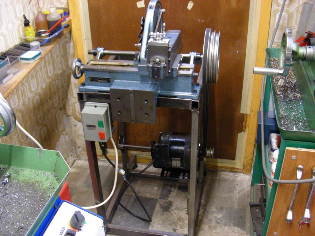

              I have the powered version and am in the process of setting it up on a stand:

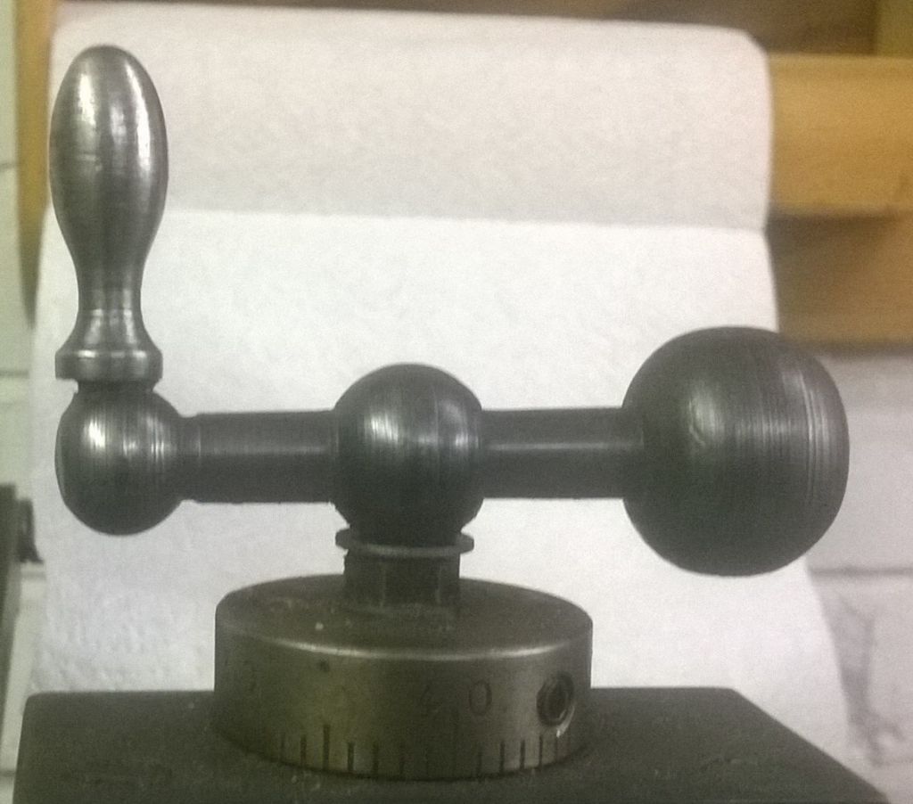

              Some time ago I replaced the original tool slide handle with a Myford ML7 type which I thought was better-looking than the original; I also made a new end bracket.
              If you decide not to make your own you will be welcome to the original if I can find it.

                  There you go, Mark – two better offers! But just in case ega's handle has gone permanent walkabout or you don't fancy a Myford one, I've made a quick sketch of mine. I have had to approximate the radii of the twirly bit as I didn't have an easy way to measure the curvatures, so you can suit the design to your own requirements. I've done the dimensions in decimal inches, too, so that I can use my calipers. (I normally work in metric.) It looks like your graduated dial is thicker than mine (at 0.385inch)  so that might explain the shortened appearance of the attachment thread.
                  HTH,

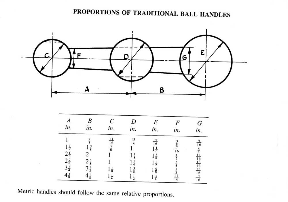

                      It was good of John to go to the trouble of measuring and drawing his ball handle. Mine is quite rusty and needs cleaning up but every time I look at it I am offended by its sheer ugliness, perhaps because the balls are not actually spheres, as shown in John's photo.
                      Tubal Cain gave us some proportions for nice looking ball handles:
                      Stay well,
                      Rod

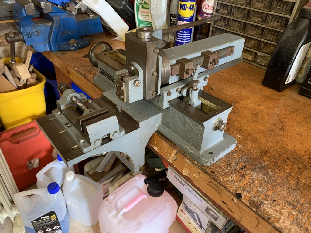

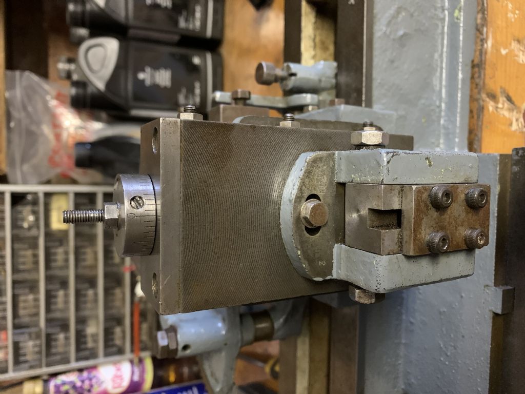

                                    Your latest photo incidentally shows the clapper box construction; a neat solution to the problem of making an accurate square hole. I assume the slot is sized so that a standard tool bit is just gripped by the bolted-on strap.
                                    I think the answer to NDIY's point about the pivot point of the clapper box is that given the overall dimensions of the parts it would be difficult or impossible to have the tool point trail the pivot.

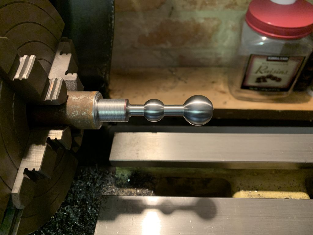

                                      Made some good progress today working from your drawing John. I don’t have any form tools or a tooling jig for producing sphericals so what I did was formulate coordinates using Excel. I calculated horizontal dimensions at 5 thou radial increments. This then smoothed out nicely as shown below.
                                        haperSlideClapperBox.jpg">HERE is one method of arranging a single point cutter to cut beneath the clapper box (pic from Wiki). There are also opportunities with cranked one-piece cutters.
                                        I’m not entirely sure of the optimum cutting edge position but many diagrams show swan-neck cutters as preferable.
