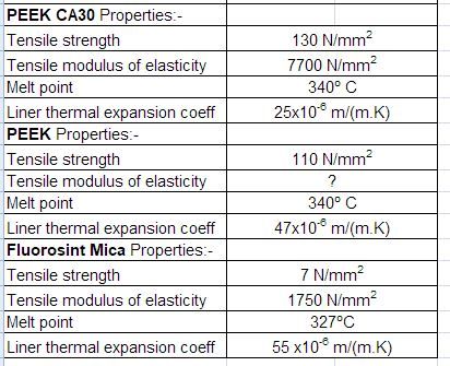

                      The usage of a high-performance polymer (HPP) like PEEK, impregnated PTFE etc for piston valve bobbins led me to many hours of research.
                      Expansion is the problem. If you bear with this brief narrative about piston valves, it might aid your thinking about PEEK for slide valves altho' of course the situation is different.
                      If you machine a HPP bobbin to slide nicely at ambient temp then it WILL seize at steam temperature. Keith Wilson and many others have reported this. Advice is the tedious process of putting the whole casting in the domestic oven set to the temp of the steam your boiler pressure will produce. You are then supposed to keep skimming the bobbins – a thou or two at a time – until they slide at this elevated temp. Well….yes, that's good except that at ambient temp, there's damn-all contact between the bobbin and the piston valve bore. So that means you'll never get the engine to run on compressed air and starting up on steam will also be problematic.
                      John, you don't write whether your valves are to run on CI or GM. I found that carbon-fibre impregnated PEEK "PEEK CA30" had the best properties in terms of relatively low linear expansion and wear resistance at moderate superheated steam temp. It is not cheap and judging by how quickly it blunts a HSS cutting tool, I'm a bit apprehensive about use on GM surfaces, but it should be OK with CI.
                      This offers some comparative data:-
                      I purchased the PEEK CA30 from Davis Ind Palstics and found them very helpful.
