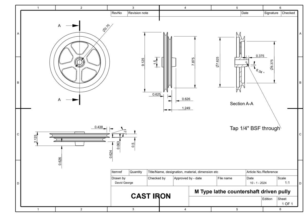

      Alebre Atom 3D creating PDF files of drawings I get a clipped drawing on the right hand side and wondered if it is a setting I have on my PC or is it the PDF software on my PC
      David

        What PDF writer is Atom3D set to use?  The ‘Use built in PDF writer’ option should work well.  That’s in System Options -> Drawings -> PDF.

                Thanks for replies’ I decided to print to PDF and the result was a full page drawing  but when I published to PDF it came out cropped so I will have to print to pdf for further drawings.

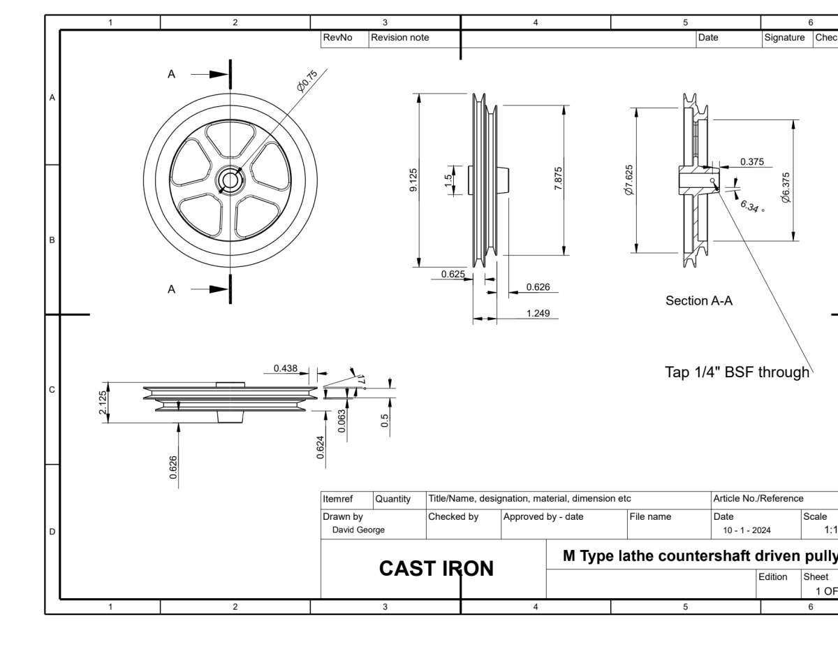

                    New image printed to PDF .
                    M Type lathe countershaft driven pully drawing_240110_155748

                      Check the scale is correct!  A likely cause is one of David’s PDF programs defaults to print at actual size, whereas the other  defaults to resize the drawing to fit within the physical page margins of whatever printer and paper size his computer has selected.
                      The first attempt may be correctly at 1:1 scale and clipped because the drawing is too big to fit on a real sheet of paper.  Looks wrong, but it’s right.  The second attempt may have rescaled the drawing to fit on the page, which is usually what’s wanted for non-technical work.    Looks right, but it’s wrong if a technical drawing must be actual size.

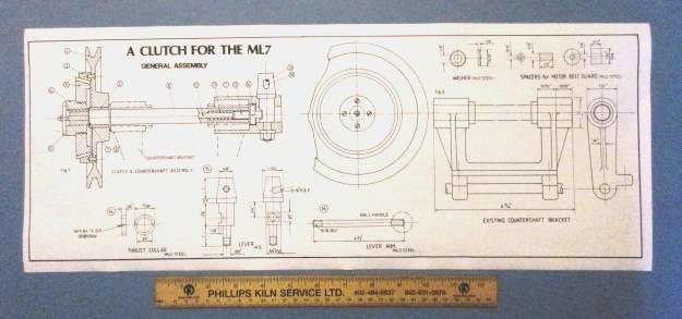

                              As many will know, I scanned all the early free plans that came inside the early copies of MEW, these were all saved as TIFF images @ 300 dpi making them around 30 MB in size and to the original physical size, which was on a 787 x 297 folded up sheet inside each issue, so you would need a large format printer to print them to their full original size. My Canon Pixma pro9000 can print a maximum sheet of 23″ x 14″ (584 x 355 approximately) and does make a reasonable size drawing of these plans.

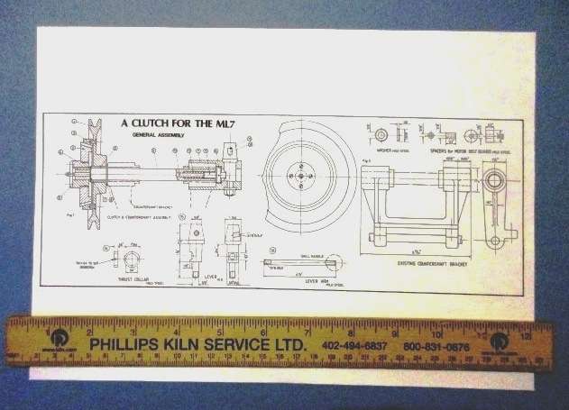

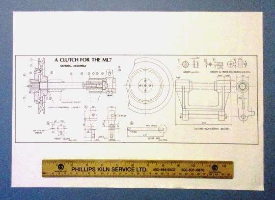

                              I have converted most of these to PDF’s, using Fox Tab PDF converter, and so I’ve printed one of these on a 23″ x 9″ sheet, one on an A3 sheet and one on an A4 sheet, and they all retain the same shape, although different sizes. Now you would think that they all had the same aspect ratio, but the 23 x9 one was different. According to an online calculator, the original drawing has an aspect ratio of 11:4, and so did the A3 and A4 ones, the 23 x 9 one though has an aspect ratio of 190:69, but if you divide 11 by 4 you get 2.75, but if you divide 190 by 69 you get 2.75362> which is near enough the same, which I think would be hard for anyone to spot the difference, photos of the prints in order 23 x 9, A3 and A4.
                              23 x 9
                              A3
                              A4
                              The paper sizes were set by my Pro 9000 software
                              Although the A4 one being just under a quarter the area of the original, I can read it without any difficulty.

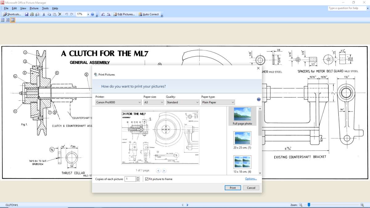

                              My Laptop has a PDF printer installed, but has limited paper sizes to choose from, and doesn’t include a custom setting, but I still needed to make sure in the printing pane, that the “Fit picture to frame” was unchecked for all three of  these prints, otherwise you get what you see.
                              Screenshot (14)
