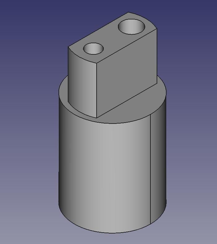

Your job is a bit different in that the 'clunky' bit extends just about the whole way. So once you've moved over to the mill, I think I'd stay on it and just cut them off as other have suggested.
