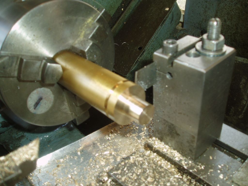

                              As a lad I worked on a ward 2a capstan .parting from the back . the lads on the lathes  sometmes used to borrow my M/C to part of some of there components.Please see photo parting 1&1/4 brass on my myford S7 MK1 as Terry d suggests  the post is direct on the crossslide . As you can see Its quite away out of the chuck but it parted off  fine
                              Regards Nobby

                                Not really a fair test Nobby in brass, you could do this with a butter knife and have no trouble.
                                I regularly part off 3″ brass with a front tool and the only problem I have is the lathe won’t run fast enough or feed fast enough.
