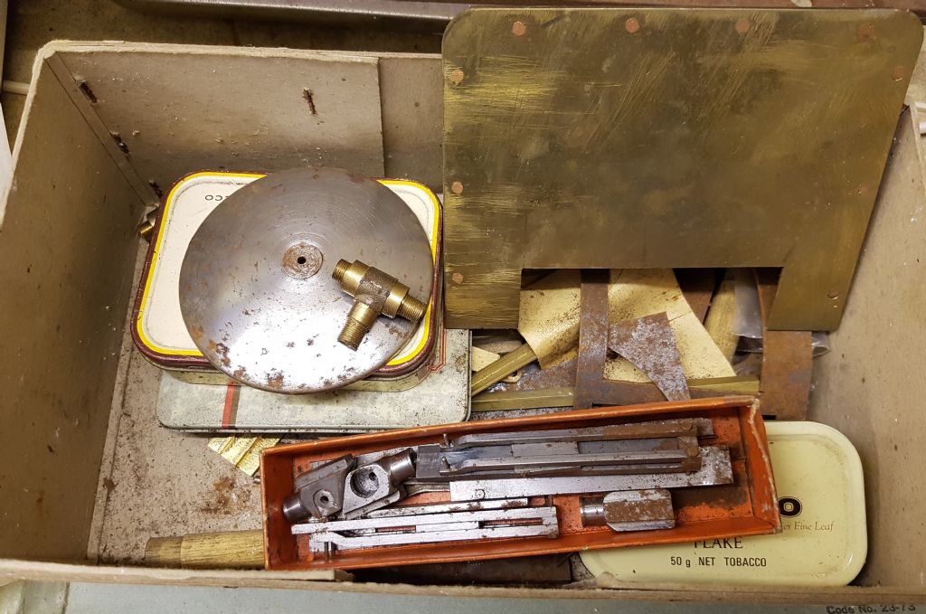

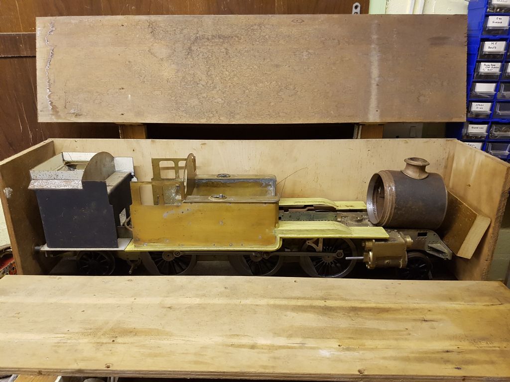

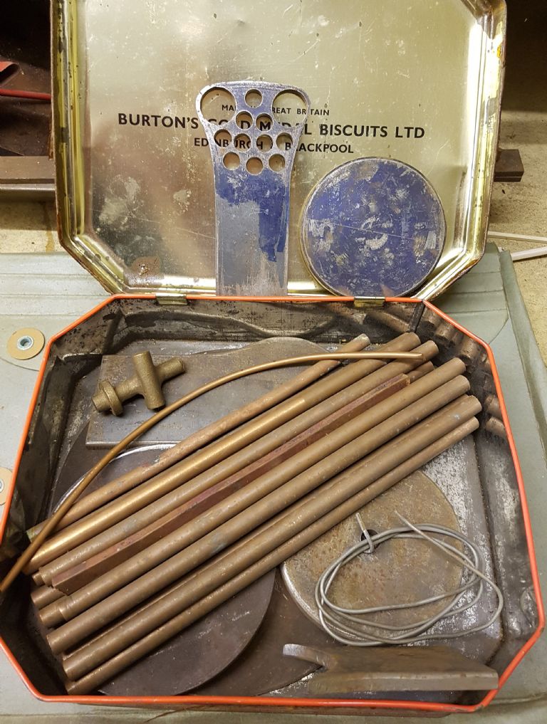

      Hi
      My father has part built an LNER V1 2-6-2T locomotive which we are looking to sell. The trouble is we have no idea as to it's value or where the best places are to sell it.
      I have some pictures that show how far he got, along with other components that have been made.
      Can anyone help?
      Thanks.

          I am not a steam or loco man but ask the question. Have you come across any drawings ? From what I see it looks like a scratch built job to his own design. If there are drawings there may also be some cast parts.

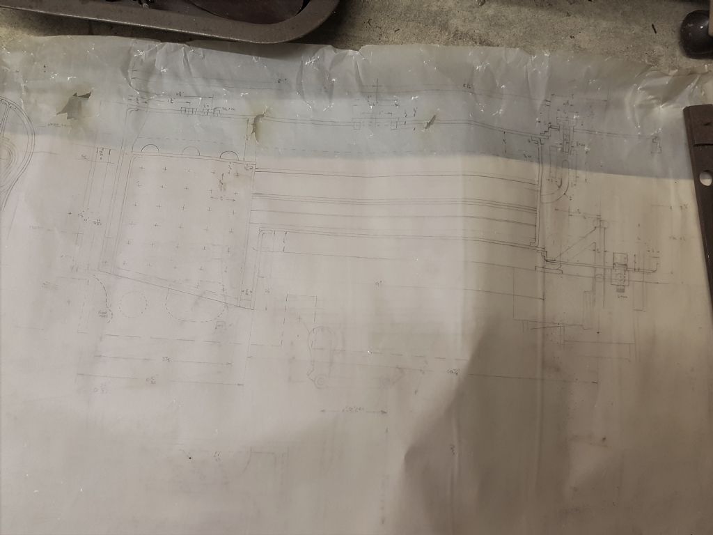

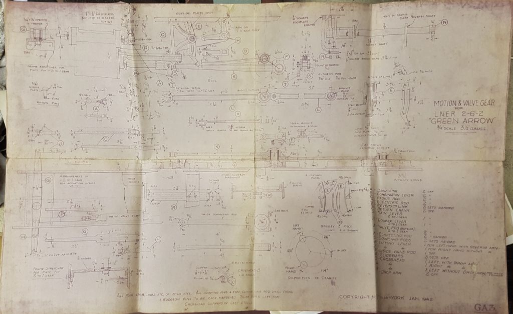

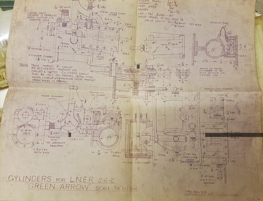

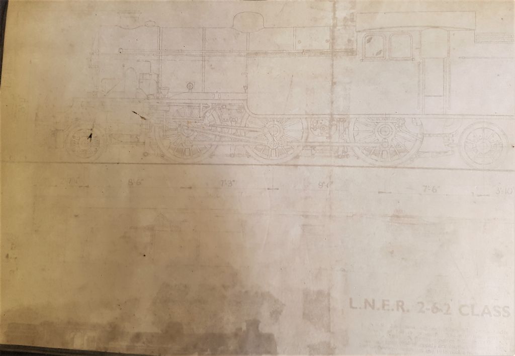

            Yes, there is a set of drawings:
            The only bits we've found are what are in the pictures, and we've cleared out the rest of the workshop (apart from his lathe, which I need to get rid of too).

            #313851
            julian atkins
              @julianatkins58923
              Hi Evelyn,
              Your father was building rather a rare loco in miniature – a LNER V1 or V3 2-6-2T.
              He appears to have based the chassis on the Harry Jackson of York drawings for the 3.5"g Green Arrow.

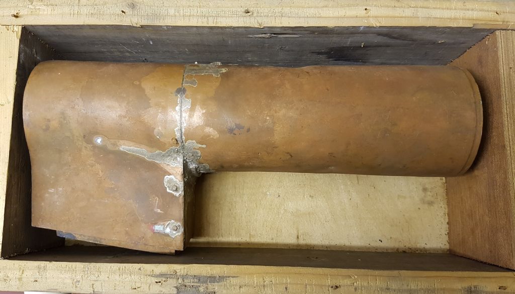

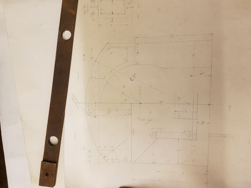

              Your father appears to have designed the boiler himself. If this could be shown to be a close copy of a published and proven design then this would assist considerably otherwise we are into the realms of a new boiler design and all this entails these days.
              I hope you wont take this the wrong way but your father appears to have made a bit of a hash of the silver soldered joints on the partly made boiler. This may be why he did not progress further. It is difficult to say from a few pics whether the boiler shell joints can be rectified.
              The Jackson/Clarkson drawings for the chassis are not for the faint hearted or beginner.
              However Martin Evans designed a 5"g V1 'Enterprise' and his drawings would no doubt be of use in completing your father's 3.5"g version.
              Whereabouts are you located?
              Cheers,
              Julian
