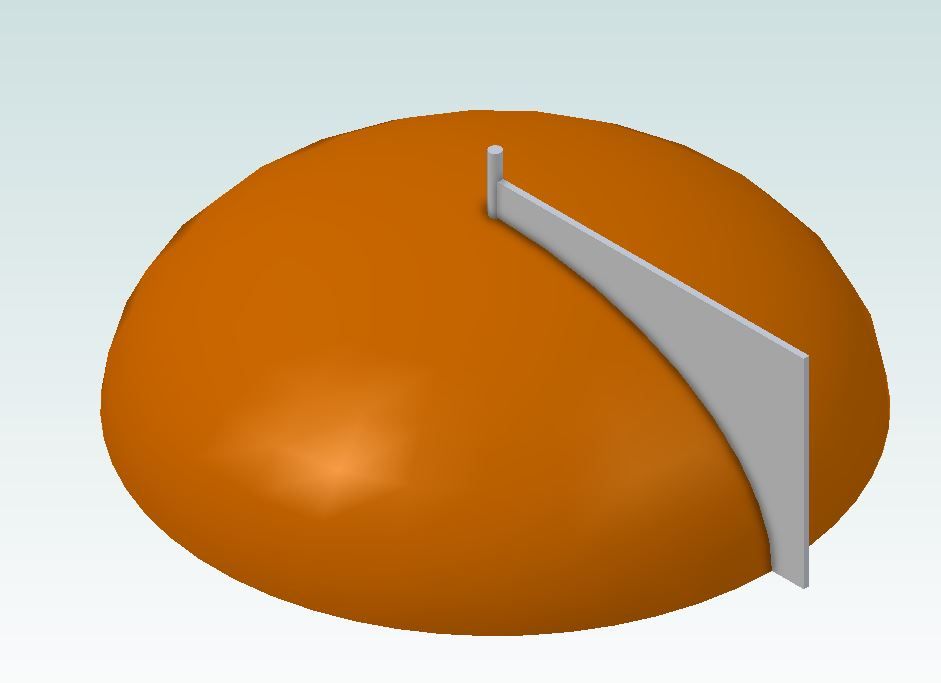

          If you cut a template of half your dome from a bit of flattened out oil drum and hold the top of it to a peg in the middle of your mould you can simply rotate the template to shape the surface of the mould. The subsequent layers will then follow that shape. Same way a decorative plasterer makes a ceiling rose with a sled

                Middle eastern 1/4 dome roof gives a good clue to shape.
                Although arabic architecture has many dome type roofs the platerers method would work for them all, just cut the template to suite profile and rotate that to refine shape of earth mould. Potters do similar with templates too.
