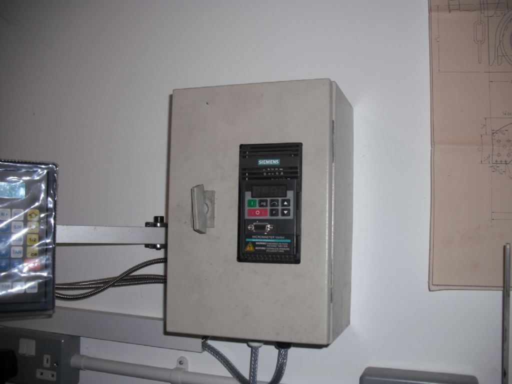

                                        Bob Brown 1
                                          @bobbrown1
                                          dscf0078.jpgThis is how I set my inverter up with a filter and have not had an issue with RFI, did have a little interference till I added the filter. Put it in a cabinet to keep the connections covered and away from swarf.dscf0076.jpg
                                          Edited By Bob Brown 1 on 27/04/2016 10:12:19

                                              Muzzer
                                                @muzzer
                                                Posted by Bob Brown 1 on 27/04/2016 10:11:01:
                                                That looks like an industrial quality installation, with screened and terminated cables, metallic enclosure and grounded inverter. If only this were the norm!
                                                Inverters are designed to be capable of meeting most "normal" installations by following good practice like this – and have filtering incorporated to get them in the right ball park but every installation is different. However, if you assemble a complete cabinet as a standard product (for sale etc), you would be expected to make it meet the EMC requirements at the cabinet level.
