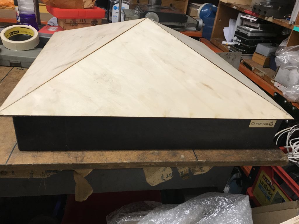

                            Vic
                              @vic
                              I spent some time researching and then correctly mounting my granite surface plate, including a case and cover. It now sits with lots of stuff on it and I invariably use the cast iron table of my vertical bandsaw instead.
                              **LINK**
                              #567655
                              Dave S
                                @daves59043
                                Which is why the cover I made for mine is this shape:
