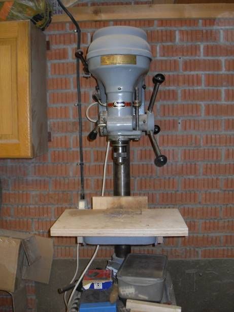

      Hi all,
      I am in need of some help with an old Pacera (meddings) pillar drill I have in my garage/workshop.
      The quill leaks and I have tried to find a seal for this but I've not had any luck. Wondering if anyone knows where I can get one as apparently meddings don't sell them anymore.
      Thanks
      Damian

          #242216
          damian
            @damiannoble34800
            Just managed to sort out a pic so everyone can see what I'm talking about. As far as I know it's a Pacera MB4

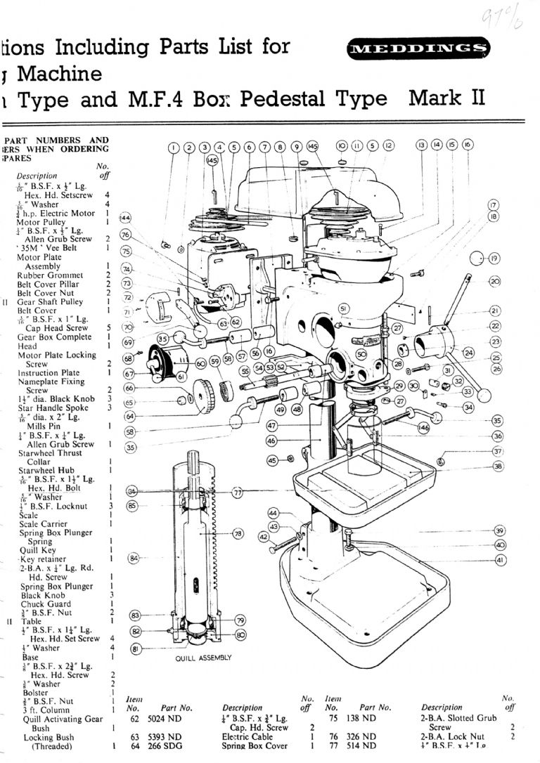

              #242305
              Robbo
                @robbo
                Damian,
                If you look at the Quill Assembly part of this page from my Meddings opins/manual you will see the bottom seal part number 80.
                This has, in the original, a lip on the outside of the quill.
                Instructions are " Lower Quill Seal" : item no 80 is replaced simply by prising the seal housing out of the quill with the aid of two screwdrivers and inserting new assembly….."
                If the seal has been replaced with a non-Meddings one then more digging required as there won't be the outside lip.
                Edit: the illustration is an MB4
                Edited By Robbo on 11/06/2016 09:45:22
                #242349
                damian
                  @damiannoble34800
                  Brilliant Robbo I shall take a look at that. I think I had the diagram somewhere but no instructions as to how to remove it
                  #242420
                  damian
                    @damiannoble34800
                    After a bit of further investigation it looks like the root of the problem is actually the gearbox oil seal.
                    Need to strip the gearbox out and source a new one.
