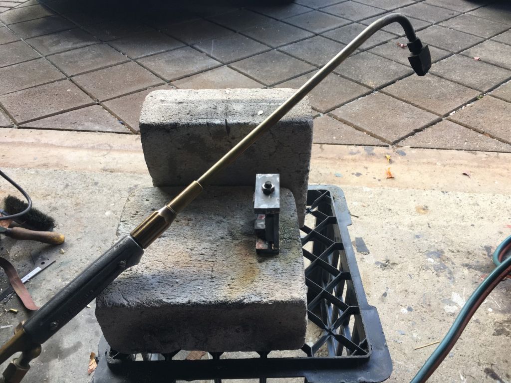

                              Oxy-Propane does not just produce a small concentrated hot flame if you have the correct nozzle.
                              I recently was silver soldering some bronze parts with a Benzomatic torch on Mapp gas (Mapp gas is hotter than propane) but had a problem heating the part. I gave up after 5 minutes and tried an oxy-propane torch with a heating nozzle. The nozzle has a row of holes that produces a wide flame and even with gas turned down low took less than 1 minute to heat the part and solder the joint.
                              Paul.
