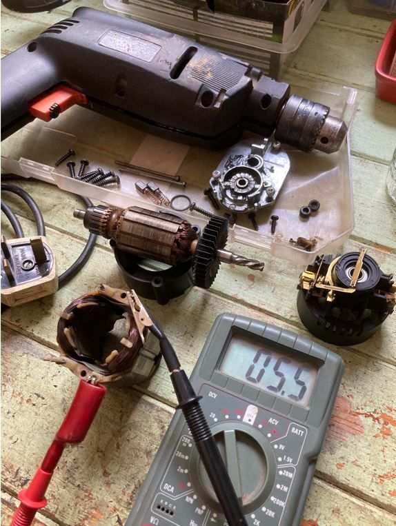

      Tea Room as I'm presuming this is a lost cause! I overheated a handheld power drill last week through impatience with some DIY, causing some smoke and eventually blowing the fuse.
      Once it had cooled down I found that it would no longer spin, just hum – dismantling showed some melted and resolidified wax/resin substance had jammed the armature. With this pared away and drill reassembled it turns again under power but only slowly and gets hot again very quickly.
      Waxy stuff looks to have come from stator windings; I tested continuity of both halves of this while it was apart and got around 5 – 6 ohms each so not completely burned out but I suspect internally shorted (?)
      Can anything else be done/checked apart from learning some mental relaxation techniques?

          I suggest you recycle it, not worth the effort and risk of trying to mend it.
          #560502
          Howard Lewis
            @howardlewis46836
            Sadly, I fear that at least one of the armature windings has gone open circuit.
            Because of this, it runs at low speed, and does not generate enough back EMF to reduce the current draw; hence the slow and hot running.
            If you want to investigate, start checking across diametrically opposed commutator bars, you will probably find some that are open circuit..
            If you can get a new armature, it may be repairable (Economically or not is another matter )
            If the gods smile on you, it is possible that, but unlikely, that it has merely thrown the solder off some of the armature / commutator connections, and a few minutes work with a soldering iron will restore life..

              Right, thanks, much as I suspected. I shall put it in the rainy day pile for a bit and then perhaps test the armature.
              Job was drilling through about 2ft of rough stone grumpling which kept jamming the bit, even using hammer mode. Would an SDS be a good upgrade for it's replacement?

                  The majority of the time if an armature goes then a machine is destined for the scrap pile as they seem to be the most expensive part of any electrical machine.
                  SDS drill is a better option always buy a replacement that is rated for the size of bit you intend to use don't skimp on this, if you drill say 25mm most of the time then pick a machine that caters for this and the size is in the mid range of the machine therefore you are not drilling at the maximum capacity.
