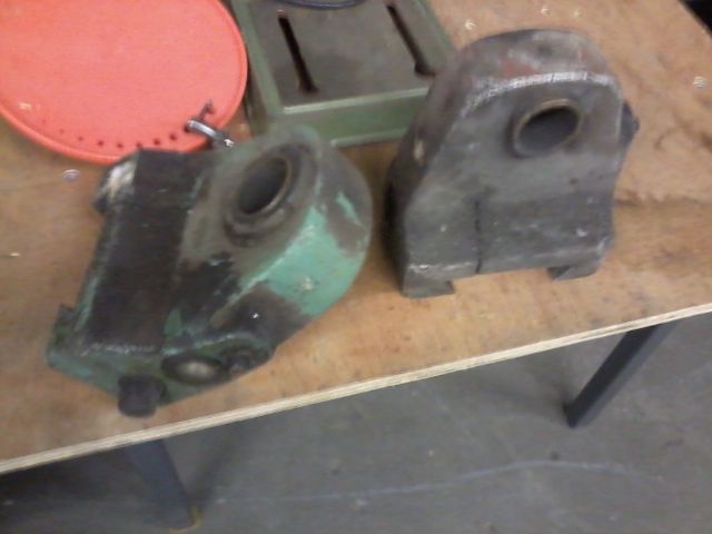

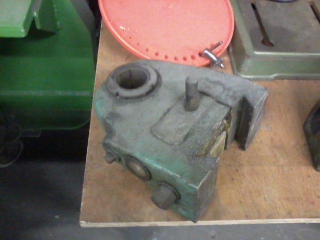

      Hi
      Can anyone cast light on what these supports might be from? I acquired them along with a lathe purchased last year, no use for them and want to know if they are of use to anyone.
      The body is aluminium, each one has a sight glass for an oil reserve and a bronze sleeve bearing, they obviously tighten on to a vee way I assume on an overarm support but I could of course be totally wrong…. Approx 250 wide and 250 high – just guessing here not got them to hand nor have I actually measured them.
      Thanks Pete

        #221249
        Chris Evans 6
          @chrisevans6
          They are off a horizontal mill. No idea of the make/model though.
          #221250
          John Stevenson 1
            @johnstevenson1
            Look like a Victoria, with the sight glass and plunger oil pump.

              Pete Hill
                @petehill80830
                Thanks for the responses, David, they were I think both green just my poor photography, and they are both identical. I will have a closer look but I think John is correct.
                Thanks for the help
