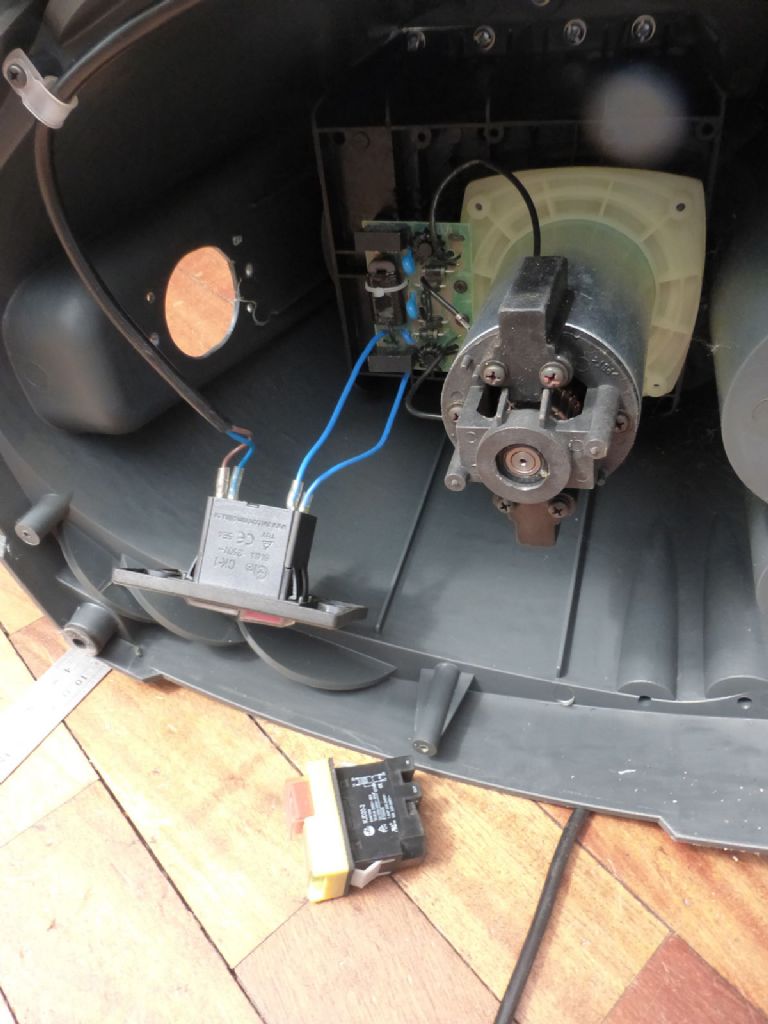

        HI, I was busy using the sander today and then switched it off . When i went to switch back on ,no power. From experience its usually the crappy nvr magnetic on/off switch these things are usually fitted with.
        So tried another but remembered it was broke.
        Decided to use one out of a cheap grinder but still will not work,the switch rumbles when pressed but will not start.
        Any suggestions as i get sick of replacing these cheap chinese switches .Or is something else wrong. Brushes look fine. They are the KJD  switches or similar the one in the machine was unmarked (just 250V 6 amp)

                  Thanks , but still puzzled why the working one from the bench grinder doesnt work on the sander . (It definitely works on the grinder as i just checked again.)
                  The only thing between the motor and switch is this board, which i havent a clue about.
                  Edited By mark smith 20 on 27/05/2020 15:49:39

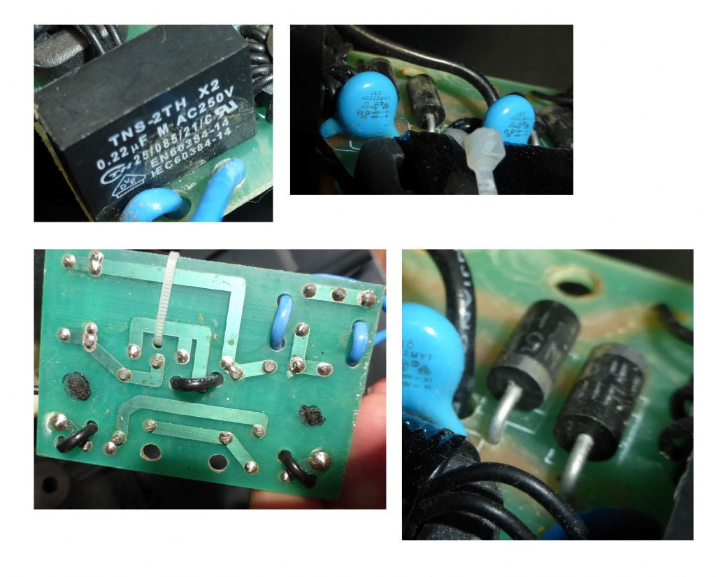

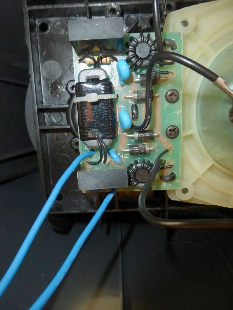

                      The PCB looks like a 4 diode rectifier with suppressor chokes / capacitors and a couple of VDR's.

                          Posted by Anthony Knights on 28/05/2020 07:35:21:
                          Anthony has it – that board is just a suppressor board -common mode/series inductor chokes and bypass capacitors. The AC is rectified and that seems to be what feeds the motor – Maybe a diode is duff?
                          Check the diodes, check there is no bad solder joint/wire connection on the underside of that board, and then, if all OK, bypass the magnetic switch momentarily and see if the motor runs- If the Grinder switch works on the grinder and not the sander, I doubt it's the switch – more likely there is insufficient current flow to keep the switch active, which means either faulty diode(s), bad connection somewhere, open winding on armature/stator, bad brushes/connections..
                          Joe
                          Edit – one other thing – those blue blobs – sometimes those are capacitors, but sometimes there is a device in series with the supply line that is used for short circuit protection – said device often looks like a capacitor – these devices are basically a resettable fuse –  when cold ( room temp) they are close to zero ohms resistance,but if there is a short, the high current heats it up and the resistance climbs rapidly to megohms, effectively opening the circuit. When cold, all is well again..unless the device has popped open-circuit.
                          Do you have an ohm-meter/multi-tester? Try to determine from the PCB layout if the one device, the smaller one, lower left in your picture, is in series with the power lines and if so measure across it to see if it is opencircuit. If all those blue devices are ACROSS the power lines, they are capacitors, to be ignored for now..
                          Edited By Joseph Noci 1 on 28/05/2020 08:05:53

                                Mark, lets first be sure those blue jobs are capacitors – can you read the text on them at all? It should be fairly obvious if they are caps. Also, there appears to be some legend printed on the board, seems partially under the components? What is the legend under those blue jobs?
                                The diodes as you measured seem fine.
                                The larger black inductor – the one tied to the PCB with a white tie wrap – measure with your ohm-meter from the lower left black wire to the upper left black wire in as seen in your image below – then measure from the lower right to upper right – each measurement should show low resistance – if not, try lower left to upper right, etc.
                                If all low res, that common mode inductor is ok and not open circuit.
                                Lets take it from there..
                                Joe
                                EDIT – not clear in the photo, but it appears that there are 3 black wires from the PCB to the motor – where do they connect on the motor – I would expect 2 ? Is one a ground connection?

                                  The blue things are marked
                                  JD222MY1 400v- X1 400v -Y1
                                  The black wire in the middle of the photo going to the right is the earth (screwed to motor casing)
                                  Tested larger inductor.
                                  lower left to upper left 0.4 ohms, lower right to upper right 0.4 ohms (lower left to upper right etc reads OL)
                                  Upper the blue caps it says C4 and C3.
                                  The blue caps measure 4.52nF from the back on the solder joints but dont know if accurate as some solder joints touch others.Cant get to the caps legs from the front.
                                  Edited By mark smith 20 on 28/05/2020 12:32:46
                                  Edited By mark smith 20 on 28/05/2020 12:36:47
                                  Edited By mark smith 20 on 28/05/2020 12:39:22
                                  Edited By mark smith 20 on 28/05/2020 12:46:07
                                  Edited By mark smith 20 on 28/05/2020 12:50:40
                                  Edited By mark smith 20 on 28/05/2020 13:02:18

                                    Ok Mark. Just to be clear – all THREE blue jobs are marked JD222MY1 400v- X1 400v -Y1 – correct?
                                    ie, they are identical?
                                    If so , they are all three capacitors and will not be part of your problem. They are 2.2nf 400V class X1/Y1.
                                    The only two components left are the two toroids – upper and lower right – Measure across each coils wire ends for low resistance.
                                    Then, instead of measuring all wires/cables for continuity, can you apply mains power safely, bypassing the magnetic switch? The wires end in spade terminals – This trick works – BUT BE CAREFUL – THIS IS NOT RECOMMENDED PRACTICE – PLEASE BE CAREFUL…
                                    DISCONNECT THE UNIT FROM THE MAINS SOCKET _ PULL OUT THE PLUG ETC…!!!
                                    Take two paper clips (!) and press the ends into each of the spade terminals of your cable, ie, in place of the switch. So, using a paper clip as a shorting jumper, connect the PCB end of the cable to the end of the mains cables, in place of the switch. Do this for LIVE and NEUTRAL. Check that the connection is good and firm.
                                    TAPE EACH KLUDGED JOINT UP INDIVIDUALLY WITH GOOD INSULATION TAPE. Make sure there can be NO accidental contact with this thing!

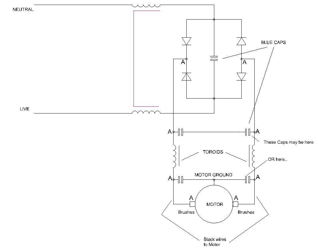

                                                    Now who's not reading…!!! Sorry…I did not see that you got 250VDC at those two points! The comments went onto a new page and I missed that.
                                                    It is sort of good news, but with some confusion…the points across which you measure the 250V DC ( GOOD NEWS) should be the same point that the two motor brush wires are connected to.
                                                    Attached a cct as I understand of your PCB ( I have omitted the two black capacitors acros the input and output of the large inductor)
                                                    At each of the points marked A-A you should measure the '250V-DC'. If it is present at the two black wires on the toroids, then it must be present at the start of the wires ( on the PCB) going to the motor brushes.
                                                    Measure across the toroid inputs and then the toroid outputs to be sure. If you measure 70V at the actual motor wire ends on the pcb , then there is a break in the PCB track, or a wire solder joint there is bad.
