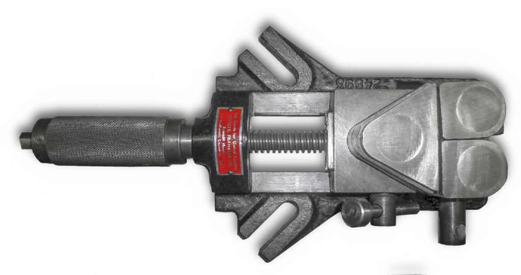

      Several years ago I acquired this old vice at a club auction. The name plate states "Sole UK Importer – Spencer Franklin Ltd" (who are still an active company). The 12" long vice has substantial fully moveable jaws consiting of 3 x 4, thick plates which are locked in position by the 2 cams around just about any shape. Lower plates can provide a flat register and the top plates used to grip a taper, which how it gets most use – when machining tapered loco rods. There's no maker's name or indication of country of origin or it's age. As one of the most useful items in the workshop; any info would be of interest. (I've yet to contact Spencer Franklin as given it's age would they have any records?).

          They are Swedish vices made by a company called SEVO, Spencer Franklin are just the agents.
          Beyond that I can tell you very little more except to agree that they are very versatile and will grip very triangular parts as well as other odd shapes. I was lucky enough to acquire one some months ago, having seen another in a friend's workshop. Mine was a trifle sad and needed TLC but it came up a treat and is used often
          I was impressed by the quality when I had it stripped out, most of the work needed was only to polish off rusty marks, oil and rebuild it with a light touch from Scotchbrite where it was needed. A new paint job completed it

              Brian, Clive – thanks for your replies. I haven't yet found the Indian source but discovering the manufacturer was SEVO prompted a Google search. In 2016 this sorry-looking specimen was on Fleabuy:-
              **LINK**
              Also good to learn there's another satisfied user ! The only hitch to it getting more regular use is the spacing of the 3 bolting-down lugs – they don't line up with my mill table slots, so an adapter plate is necessary. Nevertheless, it is a superb bit of kit, however old.
              Edit: Looks like it could be worth more than I thought ! Found this smaller, 3 piece SEVO from Germany for 350 EUR (exc VAT). https://www.machineseeker.co.uk/Machine-vise-SEVO-Sevo-2/i-1796888

                  I acquired 2 Sevo 2 vices with my milling machine some years ago, they don't see a lot of use but are invaluable for those odd shaped pieces and having 2 identical makes holding longer pieces a doddle.
                  Had to make up a new cam locking bar for one of them but other than a bit of grime they are both in great condition.
                  Only downside is they are bl**dy heavy!

                    Fowler's Fury and I have the smaller SEVO 1 models, that size suits my workshop very well indeed. In that size they might be described as solid, the 12 inch versions as you have will be heavy.

                            Well I looked and found two of them in the same dealers, one absolutely brand harry spankers with the protective grease still on it. Bought it for £100 which I was well pleased with, brilliant for holding non parallel pieces.
