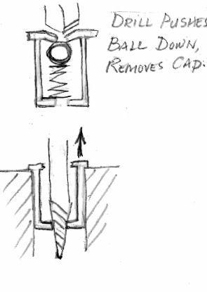

                            Terryd
                              @terryd72465
                              Hi John,
                              The Oilers we had, had small bottom hole i.e. (not as rude as it sounds embarrassed)
                              Here's my sketch.  Don't blame me – you started this sketch thing wink 2
                              I see the advantage of your approach though and would recommend it.

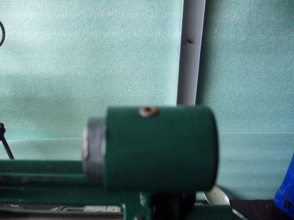

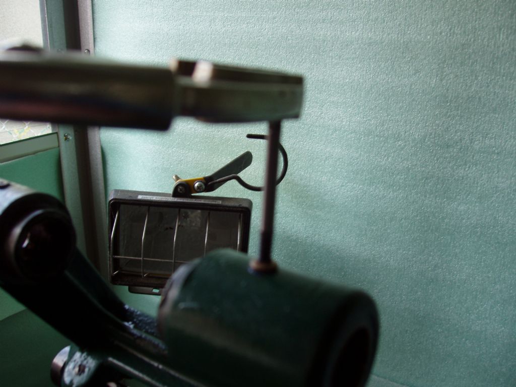

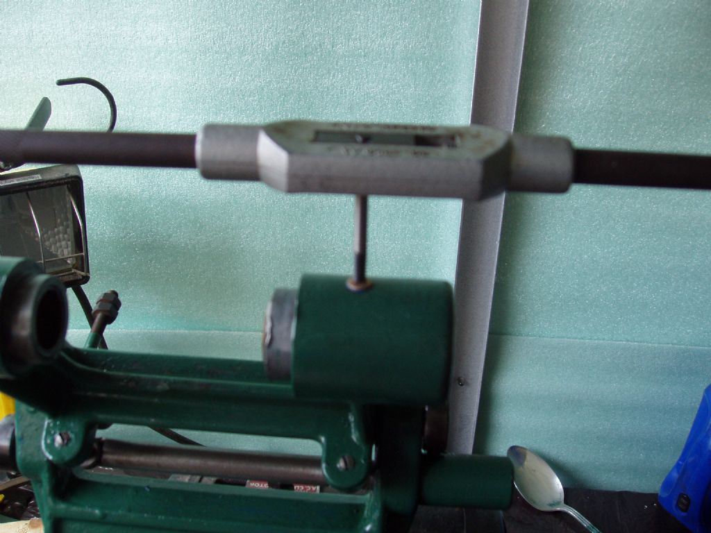

                              Charly
                                @charly
                                I have a couple of photos of how I did it. Don't know if it will help anybody, but it came out very easy. With the first oiler the ball was already out, thus the reason why I want to replace it. I tried to clean it and I pushed a bit too hard. With the second oiler I just tapped the ball down with an appropriate sized allen key.
                                To remove the oilers I turned the smallest extractor into the top hole, probably 5 to 6 turns and then used a vice grip (sorry, can't remember what you call it here, that's what we call it in South Africa), gripped it and tapped the bottom of the grips with a small rubber hammer. It came out as easy as pie.
                                Photos are a bit blurred, sorry.
