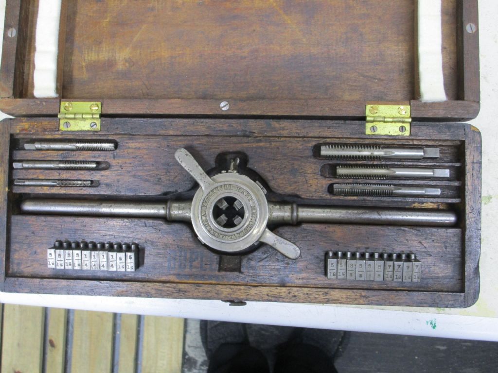

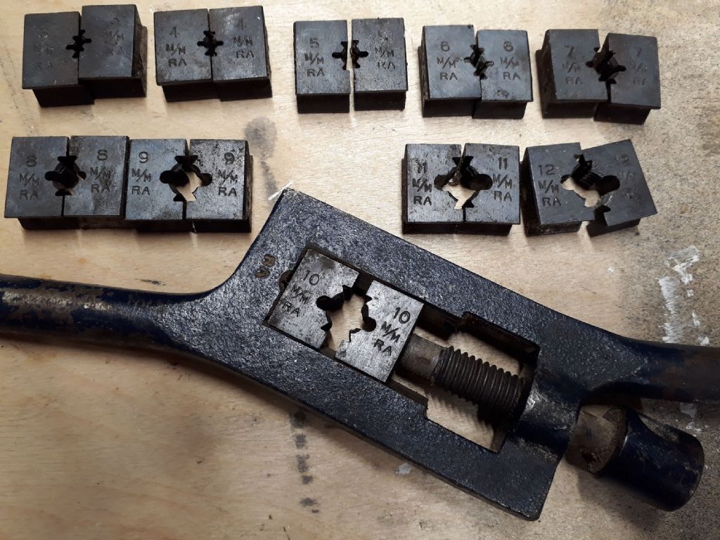

        My brother in law has kindly given me this die set which was part of his father's tool collection. Metric sizes from 3mm to 12mm (including odd ones 7mm & 9mm) marked "RA" but no other identifier, I've never seen one like it before. Is it a common type? Operation seems self explanatory but is there anything to watch ou for?
        Thanks, William.

                        Big problem with this form of die set is that there is no easy way to set to the correct size. The split sections are narrow enough to easily close up to well below the official core diameter.
                        I suspect the correct method is to close them up on a rod of core diameter to set the spacing.

                                One good thing these can do which the usual die can't is to start off in the middle of a thread, if you have a bolt or stud which has the first threads damaged you can start the die off below the damaged section and work backwards.

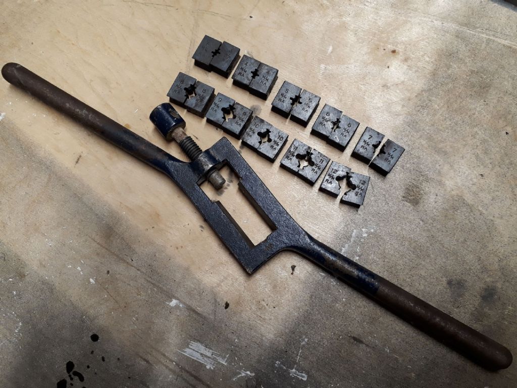

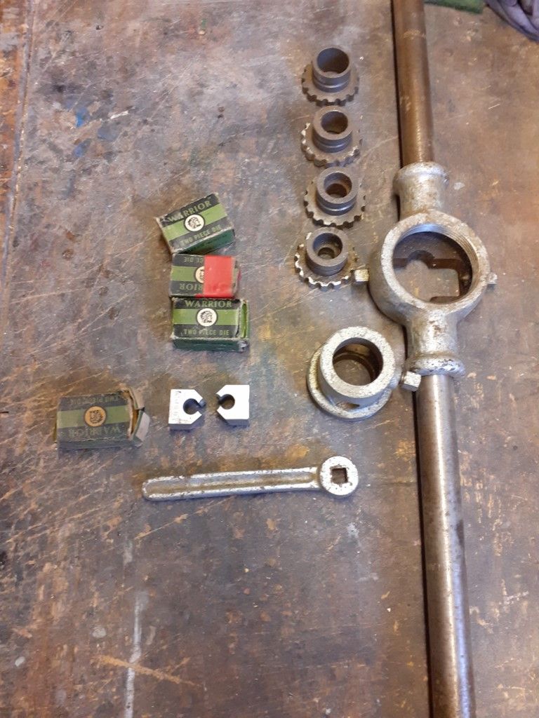

                                        I have a similar set of split dies but not in metric as can be seen the name Warrior. The holder as can be seen is of a round design rather than the square one you have.

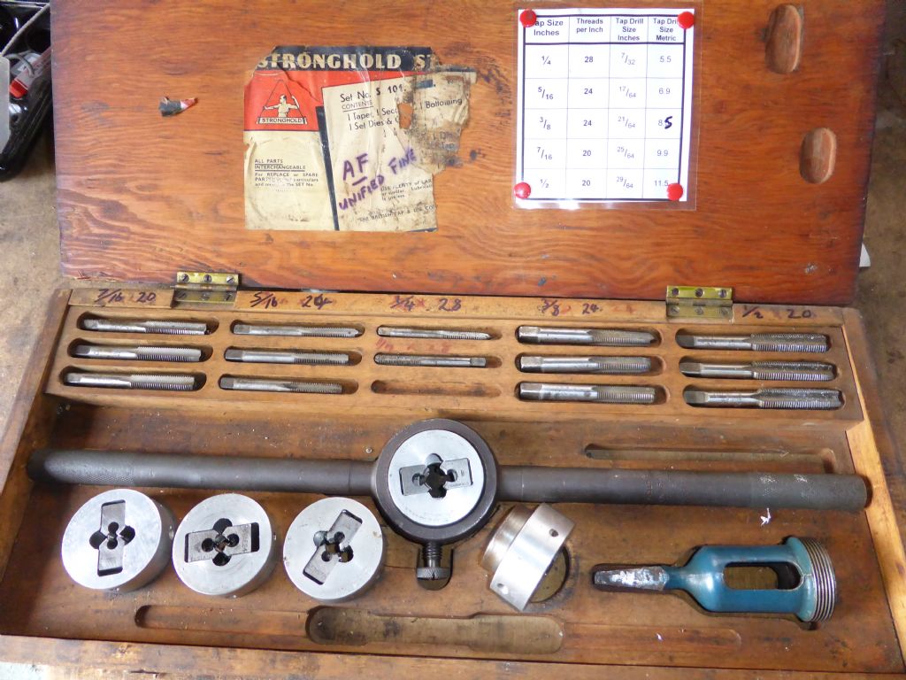

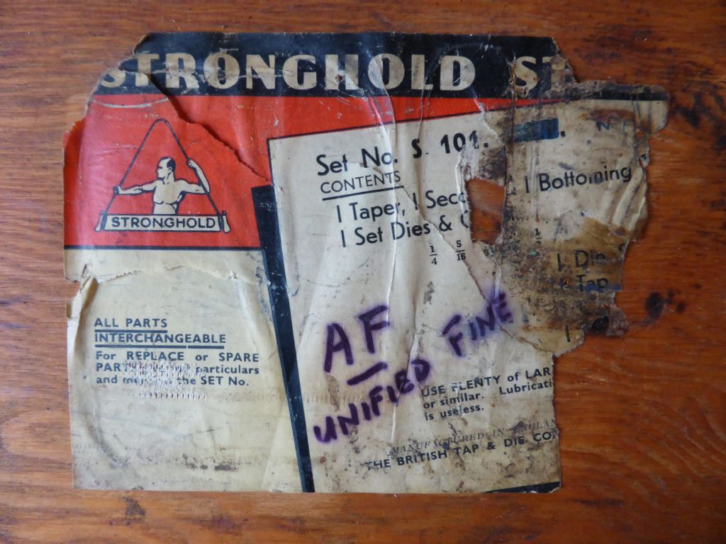

                                          This set was given to me by a friend before he went abroad about 15 years ago. As you cab see by the label it was made by a firm called Stronghold. The smaller print at the bottom states that it was made by "The British Tap and Die Company, England"
                                          Has anybody any idea of it's age?

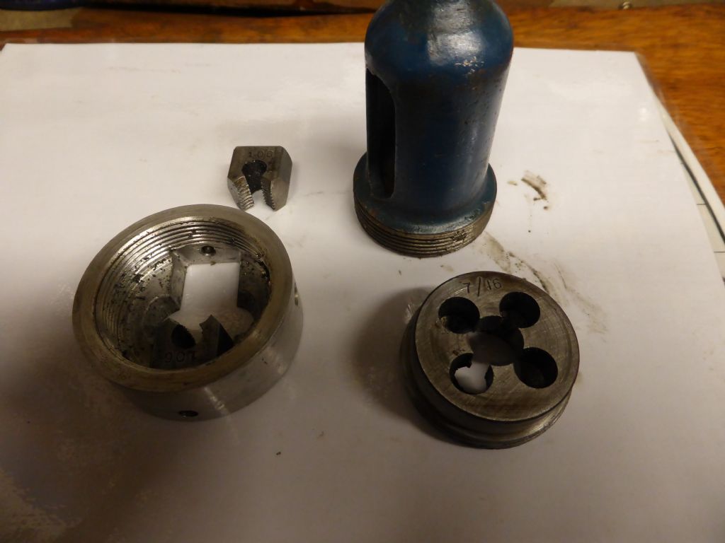

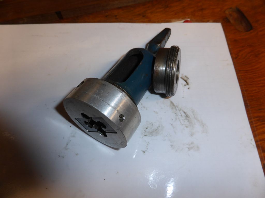

                                            I assume that the blue fitting is used in conjunction with a carpenter's brace but how, exactly?
                                            Not clear to me how the split dies are adjusted in the circular holder?

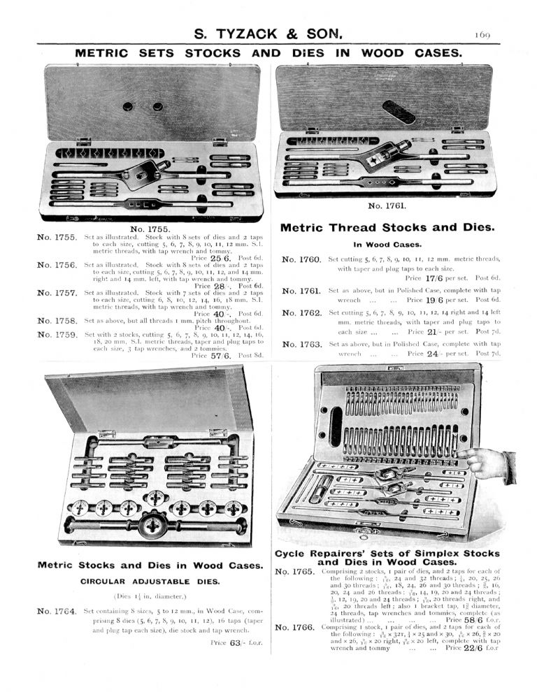

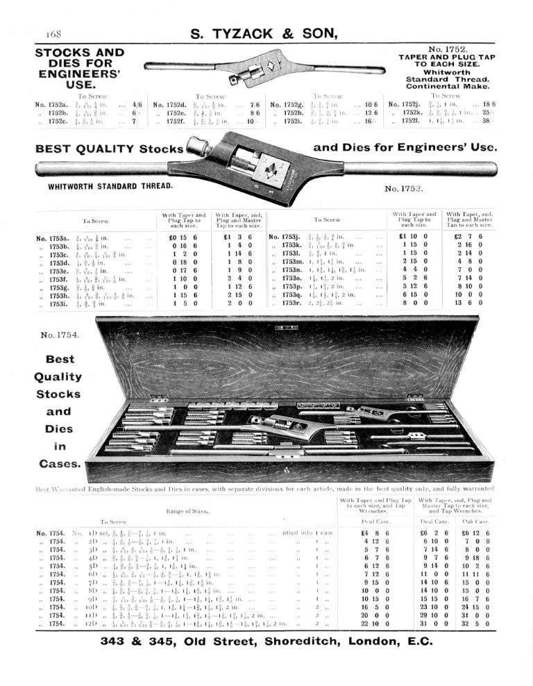

                                                Here are some relevant pages from S. Tyzack's catalogue of about 1908.

                                                  As you can see from the photo the backplate at the rear of the die holder unscrews and the blue holder screws into the the holder instead of the backplate. The dies are adjusted by two grub screws that you can just see in the picture.
                                                  #505875
                                                  ega
                                                    @ega
                                                    Terry B:
                                                    Thank you for the photos and for taking the trouble to explain.
