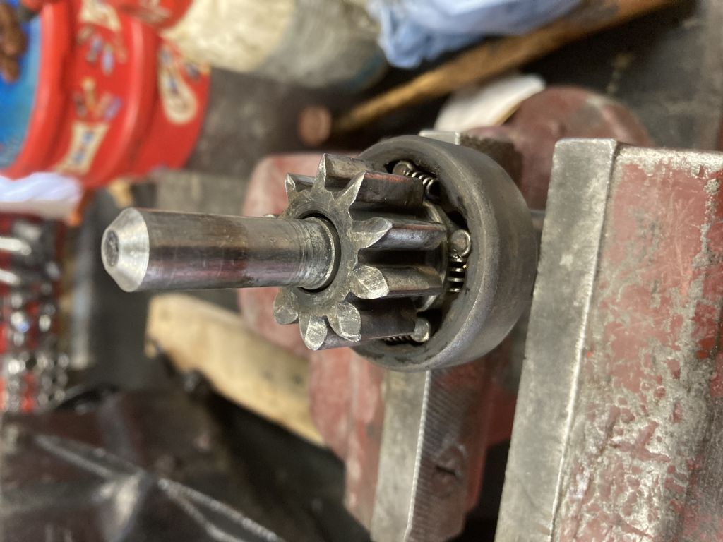

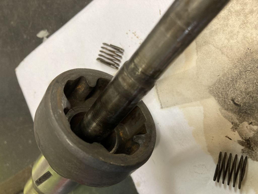

        Oily Rag
          @oilyrag
          I recently made a 3/16" 'sprag' clutch using 5 off 3/16" rollers 1/2" long. Fairly easy to make with a rotary table offset from centreline to generate the roller ramps. This was to replicate a starter system on a Jaguar XJR15, I was unsuccesful in discovering the original suppliers but suspect it was an American helicopter part (it utilised a 'helicopter shaft' coupling to connect the remote mounted starter motor to the Bendix starter gear)
          Pictures to follow

                  Here are the photo's as promised!
                  I see you maybe looking for something a little less robust than this unit though, it transmits about 3 hp!
                  This is the original .unit, my replica is virtually identical but has some modifications and is made in EN40B and nitrided

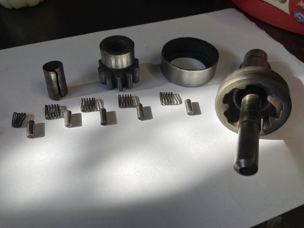

                  Oily Rag
                    @oilyrag
                    One more photo showing all the components stripped out:-
