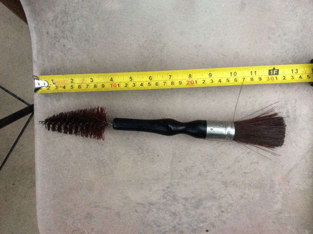

              Philip – That looked like a really expensive brush ! I have some brushes like Davids, also use the simple artist's craft brushes. Never leave the brush in the coolant over night, just lay it in the swarm tray.

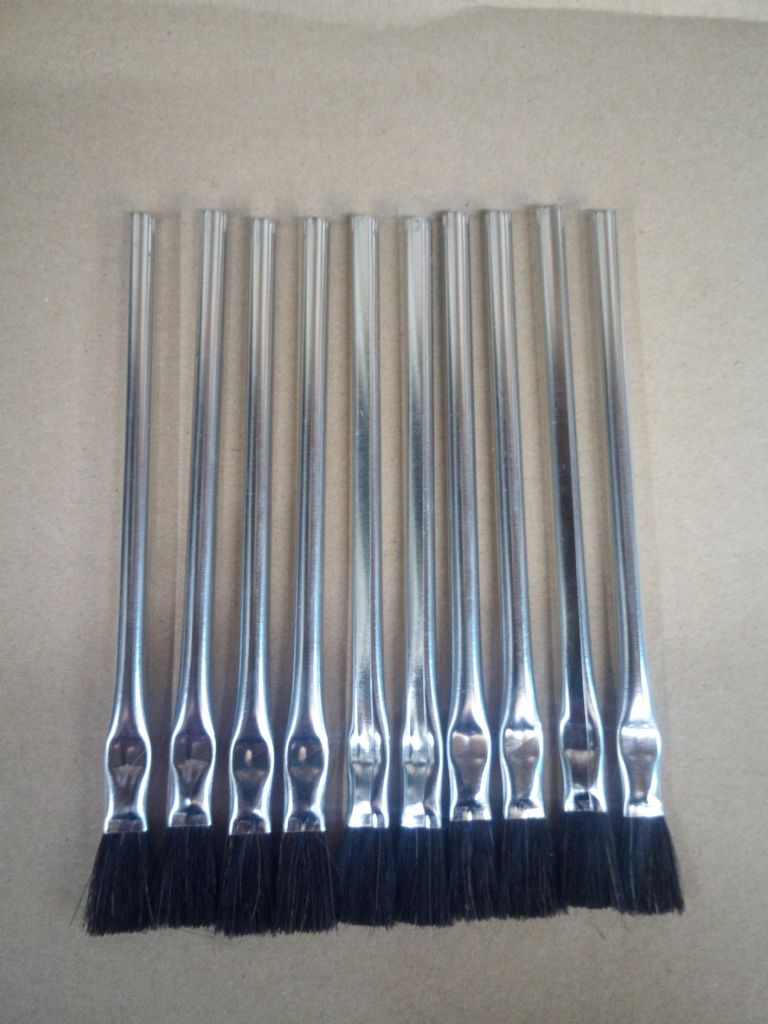

                img_20200524_101630.jpgI too had this and took action. I ordered a load of "acid brushes" (I think acid in American is flux but may be wrong) These are a metal tube with horse hair bristles and work brilliantly for brushing coolant.
                I do sell them in my eBay shop but in the spirit of Christmas will send a few out to anyone that PMs me (UK only though)

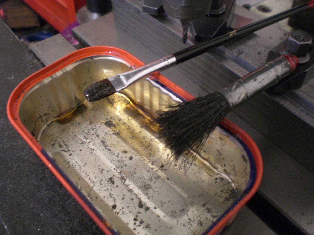

                              Hi Dave, there is nothing that can't be changed given the right circumstances, but luckily for us, many things are beyond our mortal achievements.
                              As far as brushes are concerned, this is a photo of what I use on my mini mill and lathe, the thin one is from a pack of cheap artists brushes bought from Tesco's some years ago, which I use to brush cutting fluid on, of which I squirt  a little into a tin, currently WD 40 cutting fluid the larger one with a broken handle I use for brushing away swarf and cleaning down the machines.
                              A few bristle have been chewed up when caught on the cutter, but I have had it for a good while.
                              Regards Nick.

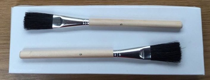

                                        My solution to the problem was a set of these:
                                        **LINK**
                                        Harris 100% natural bristle brushes.
                                        Rod

                                                  I purchased 10 brushes from David Colwill (A1 Factors, Nottingham). They arrived this morning and for less than 50p each, they are excellent. Just been using one and can confirm David's claim.
                                                  Andrew.
