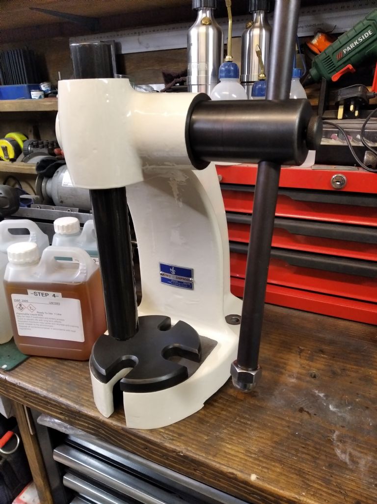

                                Pete.
                                  @pete-2
                                  If you search for the thread I posted on a cold blackening kit, you'll find the info for a UK supplier of a 4 part kit, it worked very well, all the bare metal on this J&S press I restored were done with the kit.
