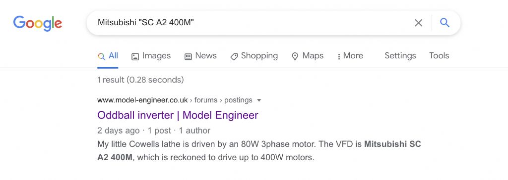

                Cannot find that drive on internet – do you have the manual?
