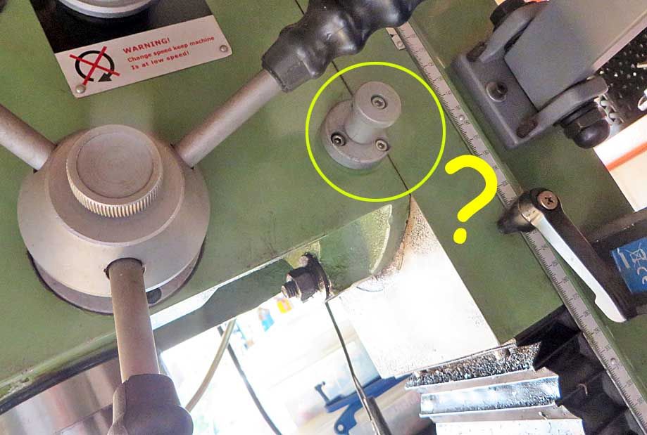

        Hi All,
        I have not used my WM18 for a few days after doing some light drilling on a few odd jobs.
        Thought that I would spend some time on a part for my linisher project using a water jet cut hole as a rough datum. Set up my co-axial indicator and it took a LOT longer than usual to dial it in and something just did no look right.
        Took a step back and suddenly noticed for the first time that the mill column was way off vertical; put an 8" piece of drill rod in the chuck and it was 1/8" out over 6"!
        I have NEVER had to move the column in all the time I have had it and do not recall having any catastrophic issue recently!
        I loosened the two bolts which were extremely tight and re-adjusted against a good quality square so all is now good; just cannot work out how this happened.
        Also I have never noticed the item ringed in the photo, what is it please?
        Cheers, Martin
        #591455
          Odd, I expect it's been moving due to vibration.
          The ringed item is the vertical lock, which is pulled to allow the column to swivel. I've decided swivelling the head on this type of mill is more trouble than it's worth because retramming the head can be a right fiddly job – when the bolts are tightened right at the end, there's an annoying tendency for the tram to shift at the last moment, and the air turns blue. Good example of a cost-cutting measure on a hobby machine. The feature works, but is a horrid time-waster.
          Re-tramming, the swivelled DTI shown below gets far better accuracy than a set-square.
          The tram is adjusted so the DTI reads as close a possible to zero on both the right and left hand side of the table, when the DTI is turned through 180°. The arm provides a long baseline. Arrangements like this have to be used with care because the slightest slop gives misleading measurements. The picture is posed – in practice I stiffen it up by not using the arm at maximum extension.
