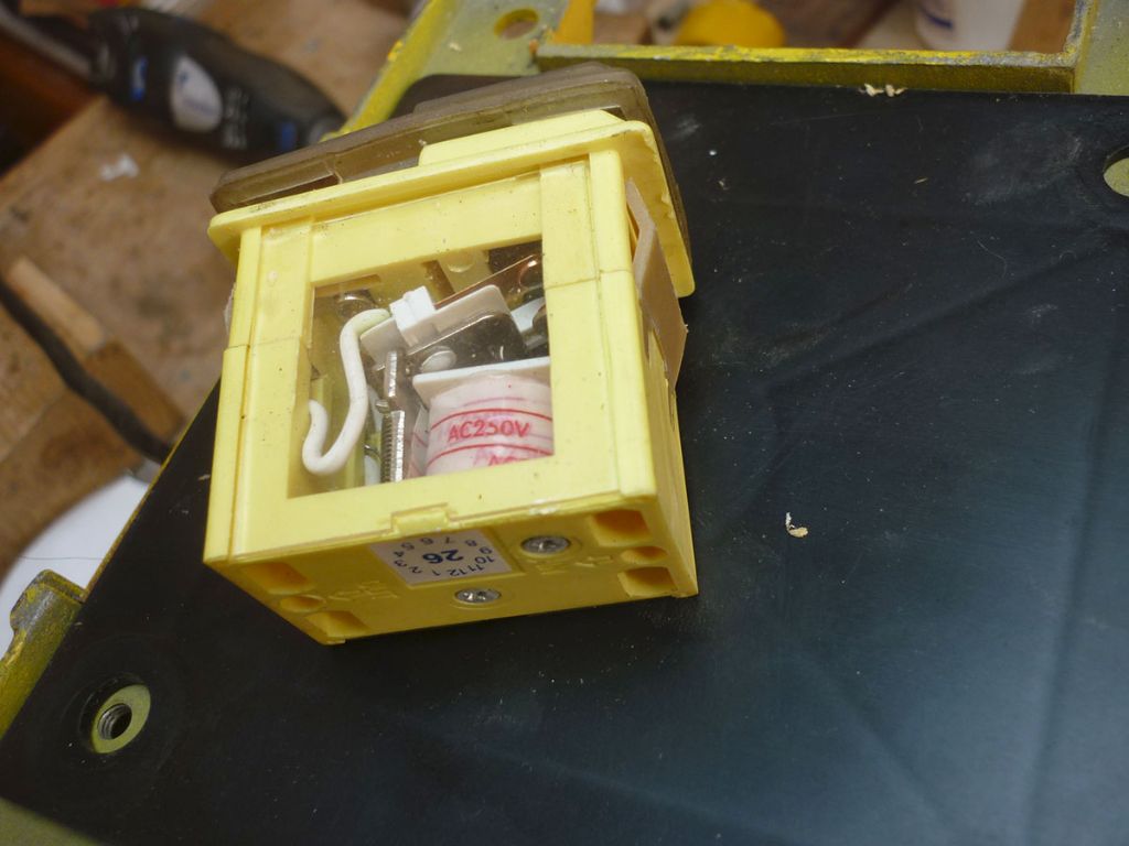

        Hi,
        I have this dismembered Perform brand  cheap wet and dry grinder ,im wanting to use it just to attach some diamond 6" flat lapping discs i have . Problem is the switch has decided to stop working.
        It powers on but as soon as you take your finger off the start switch it stops.
        I was wondering if this is the right switch from axminster?? is there cheaper anywhere?
        **LINK**
        dimensions of cut out are slight less on the axminster replacement .The original switch is around 42-43mm x 27mm. There is nothing written on the broken switch . The grinder is 250 watts.

          The last NVR switch I bought was from an epay seller. I didn't buy the cheapest available, but it was less than that one. Works OK.

            I’ve used the Axminster switch on a grinder without problem – it used to be quite a bit cheaper when I bought it – you can certainly get ones with the same (?standard) fitting for about half that price – often these cheaper models have the additional feature of a link that allows wiring in other safety switches eg gear covers in lathes

              Thanks for the replies so the specs on the axminster one will work fine on the 1/3hp grinder ??

                Posted by mark smith 20 on 29/10/2017 15:16:08:
                Hi Mark, yes, provided that you don't have an emergency stop or other fail safe switches to wire in.
                Regards Nick.
