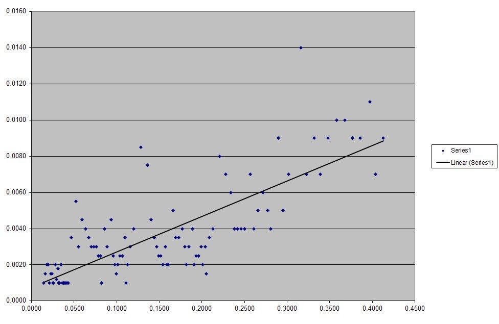

                        I have been looking for years and it seems the origin of drill letter and number gauges is lost in time.
                        The series shows no obvious logical progression, this graph shows the gap between successive drills. As you might expect it gets bigger towards the larger drill sizes, though there are a few big leaps at apparent random.
                        Someone patient might want to see if the actual sizes have individual purposes (e.g. different fits on various sizes of stock or wire).
                        More likely, someone, somewhere was making drills drawing the wire though dies made to no particular standard, some more worn than others. The irregular succession of sizes became the de-facto standard, perhaps?

                          If you plot size in mm agaionst number you see distinct discontinuities at or near round figures of mm. this indicates it the larger sequence was the drawing together of several pre-existing sequences with a bit of filling in the gaps. This would tie in with the multiple thread size sequences in use in watchmaking in th e19th century.
                          When the UK industry created a demand someone pulled together a number of sequences to make an overall list probably only to make their catalogue easier.to order from. Railways and communications in mid C19 was making centralised production and supply of standardised parts and materials more common.
                          It is quite likely that some sizes were only included to fill in the table and were never commercially made except to make drill sets!
