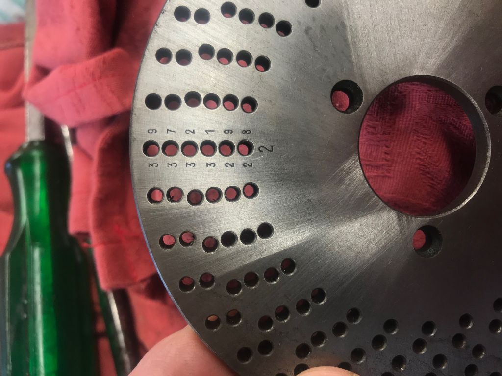

        2 questions on number punches for dividing plates: 1) Where is the best place to find a good quality selection of both font and sizes? 2) can a better result be achieved lining up carefully under a hydraulic press rather than hammer or is sharp impact critical?
        #481128
        Adam Harris
          @adamharris13683
          2 questions on number punches for dividing plates: 1) Where is the best place to find a good quality selection of both font and sizes? 2) can a better result be achieved lining up carefully under a hydraulic press rather than hammer or is sharp impact critical? I am thinking for a tidy alignment where 2 numbers straddle a hole, better to clamp two punches together with a spacer between, and use a press rather than risk a non-perpendicular hit with a fat hammer, or is that not a good idea?

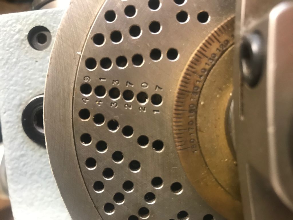

              Thanks Tim but I am definitely NOT going down the road of making my own punches! One set of plates needs 2mm tall numbers punched astride a 3mm hole as in the font of the 1st photo, but another set of plates needs 2mm tall numbers as per the font in the second photo which is very different and looks finely engraved rather thanSV13- 900
              punched – would any punches fine enough exist somewhere?

                SV12-82

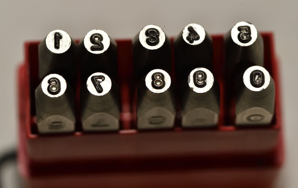

                  I don't think there are many 2.0mm punches around. We used to use Kennedy interchangeable punches in hydraulic punch setups to number parts at the same time as punching holes, so I looked at the Zoro website and saw this set from Pryor. I suspect you would be better off making your own holder, perhaps with a central pin to engage in the holes in the plate?

                    Brian thanks and using the hole for a centralizing locator is very clever!

                        Brian, I've just bought those Pryor 2mm ones and I will let you know how I get on with the hydraulic press. Many thanks,  Adam

                              I have the 2.0mm Pryor punches. It's worth checking them over and make allowances for off-set characters.
                              Some of my numbers are not central to the punch body.

                                Oh dear! Well I I have bought them now so I will just have to keep my fingers crossed. They were reassuringly more expensive than most I've seen at £27. I see you bought their cheaper "steel hand stamps" punches, whereas I have bought their "Interchangeable Steel Type Set" which are designed specifically for uniformity of type size and space size and blank size in order to be set up in a block type holder so I am hopeful they may indeed be more uniform.  Do you know of better?
