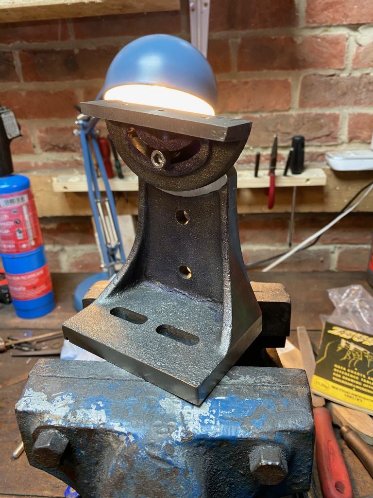

      I recently decided that it was time to do a "proper project" on my little mini lathe after years of just using it to make knobs and prototype small aluminium parts for work.
      After far too much deliberation over a good first project I decided upon a sawing and filing machine from Hemingway Kits

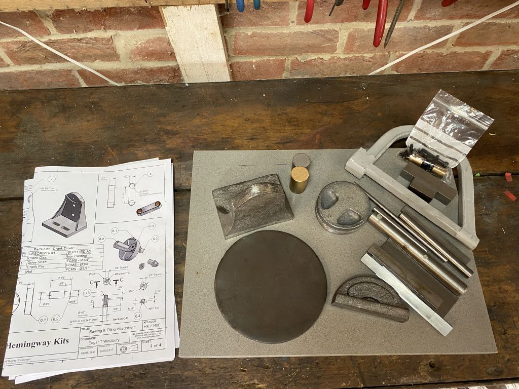

      Well, I placed the order and the castings arrived within a few days, all nicely packaged and with great instructions.
      original castings
      Despite being intimidated by the size of the castings, and never having machined cast iron before, I decided I'd better make a start on the first casting.

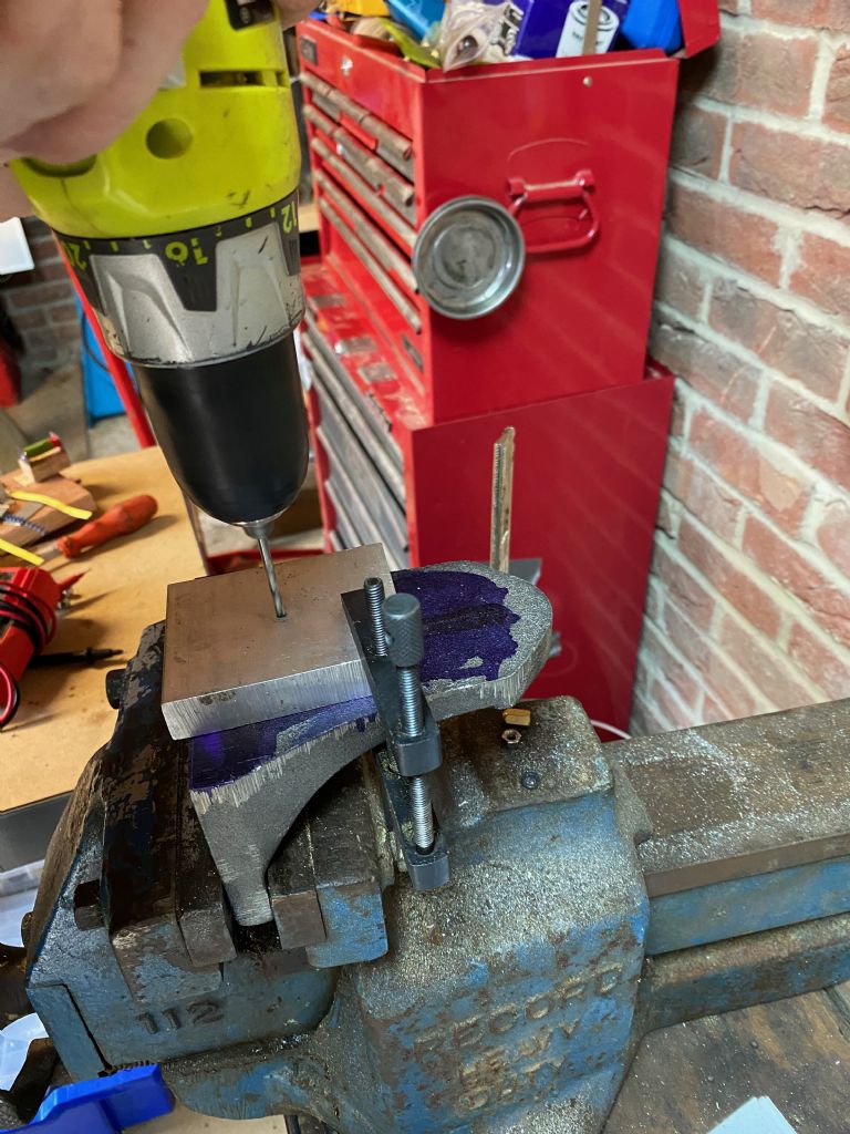

      The first job was to drill a couple of mounting holes on the standard.

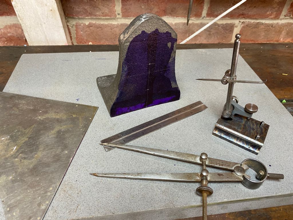

      marking out
      I marked them out (using an off-cut of granite worktop as a surface plate) and then realised that I would need the markings on the other side of the casting in order to drill the holes.
      I couldn't work out how to lay out the centre line on the other side of the casting as the bottom angle was in the way, so after a ponder and a cup of tea I made up a drilling guide and used it to drill 2 (almost perfectly square) small holes using a cordless drill, before enlarging the holes from the other side on the pillar drill
      transferring holes

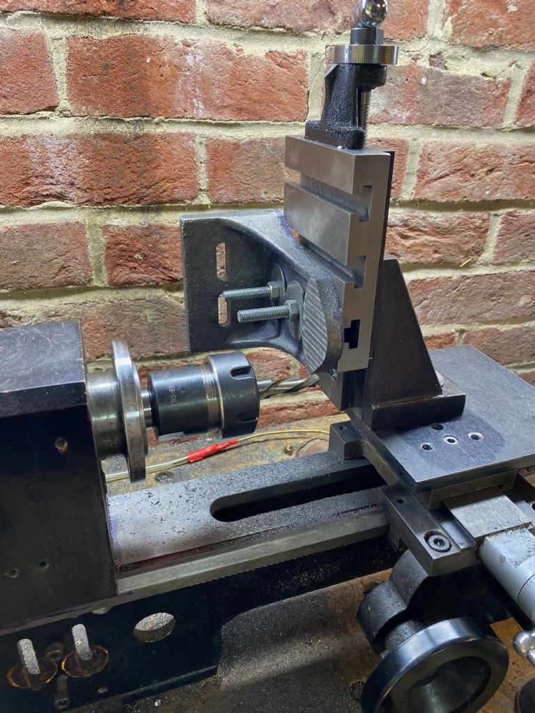

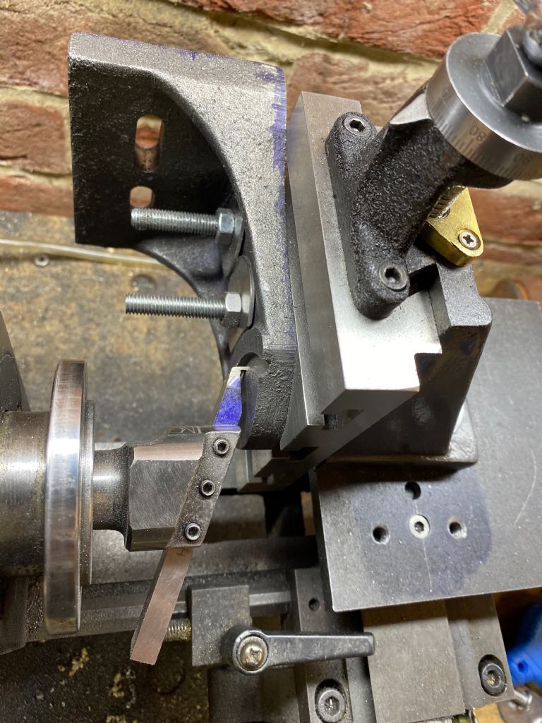

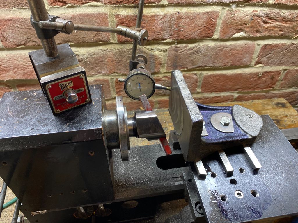

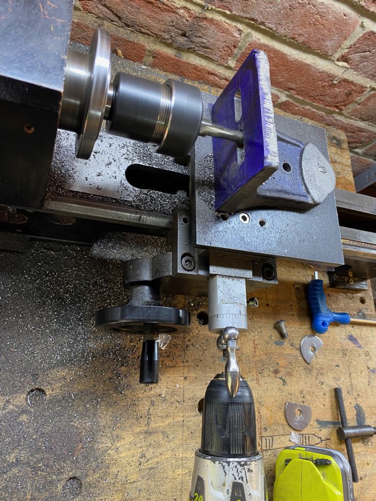

      Now I had the holes in place I could mount it on the cross slide of the lathe. Not wanting to drill holes into my cross slide, I made up a plate that I could bolt onto the cross slide and drilled + tapped M8 mounting holes into that. I also took the opportunity to make a quick saddle lock and a fly cutter for the faceplate.
      faceplate fly cutter
      My first attempt at fly cutting was a disaster, if I took a deep cut then the lathe stalled and if I took a light cut then the cast iron ate away at the (hardened) silver steel cutter.
      I then tried an HSS tool in a bought fly cutter (which I didn't want to use as it would have a smaller sweep).
      I found exactly the same thing with the HSS tool, any cut that the lathe could actually take just caused the tip of the HSS to be eaten away
      The last ditch attempt of an old brazed carbide tool in the fly cutter (I've no idea if this is recommended use!) cut really nicely.
      carbide fly cutter
      As the width of the piece was more than the travel off the cross slide, I bolted it to one side of the plate and then moved it to the other side (aligning it with a dial gauge). The HSS blanks under the standard are to pack it up to centre height.
      I had a few issues with the alignment as the base of the casting wasn't exactly flat and I couldn't get my packing pieces in exactly the same place after moving it, but I'll come back and clean it up after surfacing the base.
      Next job is machining a couple of slots.slots
      I pre-drilled the holes either end of the slot (and one in the middle for good luck) and removed the waste with an old 3/4" end mill. These were done in 3 passes, and it took no time at all with the power feed on the cross slide 😀
      Next, I've got to surface the other face of the standard. As this is much higher than the one I've just done and to avoid complicated fixtures I'm going to attempt to machine it on my little 3040 CNC router. Wish me luck!

              Neat solutions to the setting-up problems, and I like your faceplate fly-cutter holder.
              Regarding the HSS tools blunting quickly, Hemingway supplies good-quality materials but cast-iron normally does have a thin, hard surface. It is likely that the depth of cut your lathe could handle at that large fly-cutting radius, was insufficient to undermine the "skin".
              The carbide tipped tool you ended up using as a fly-cutter would have been hard enough to cut through that surface.

                Thanks for the encouragement, and, Nigel, yes that sounds like exactly what was happening – I'll now know for next time

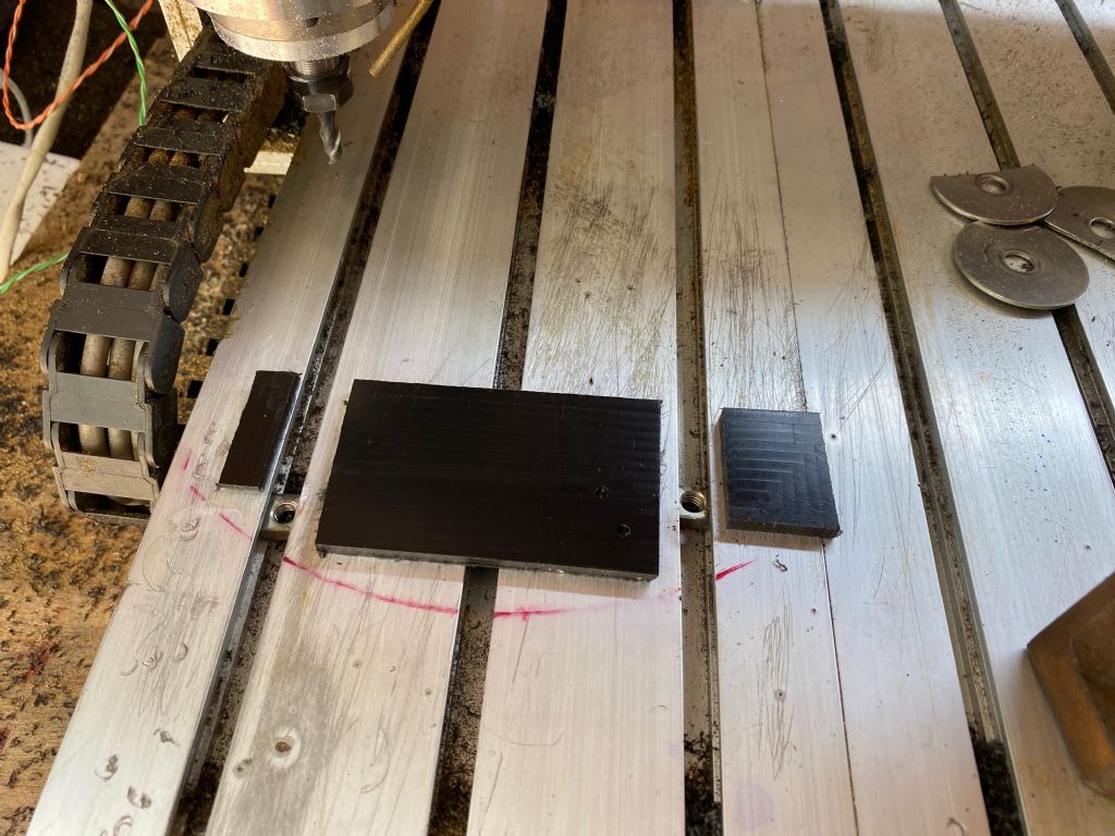

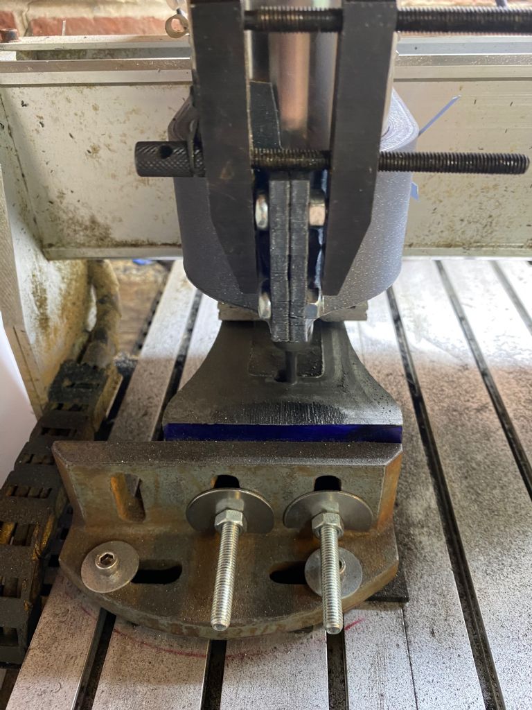

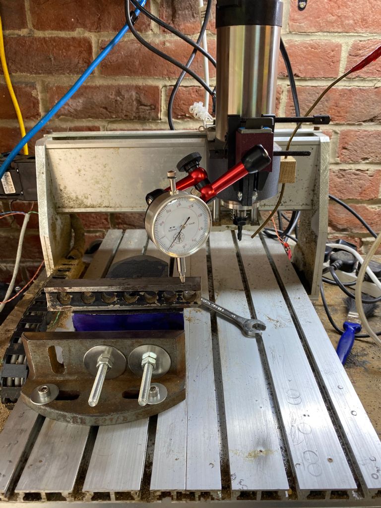

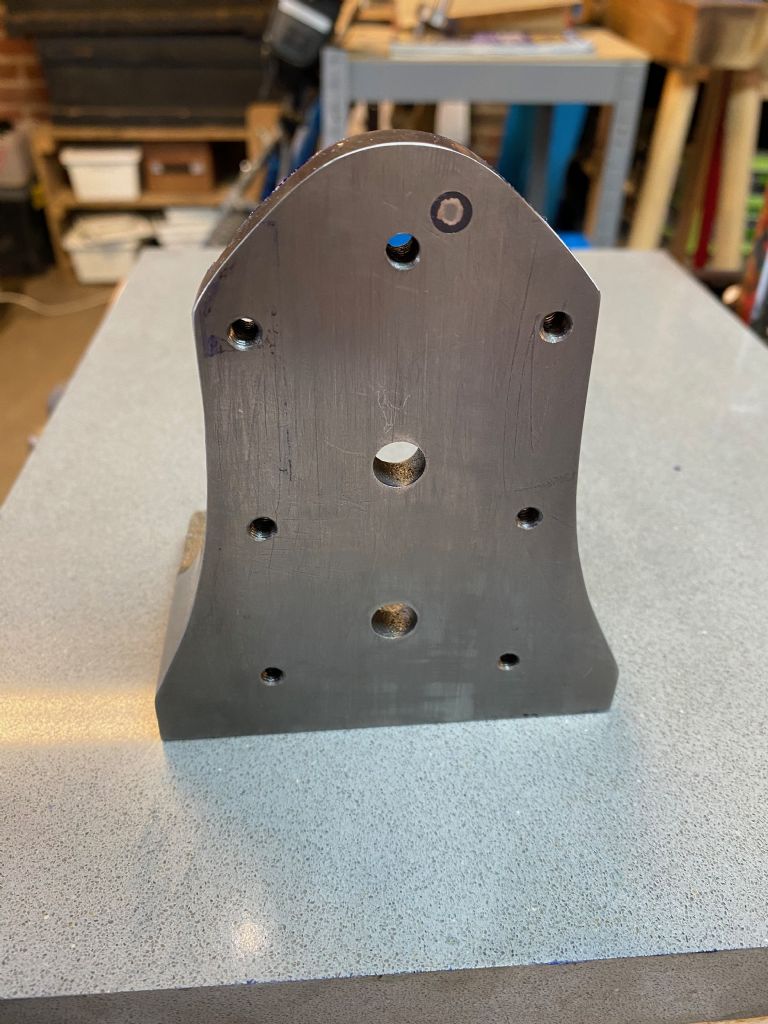

                Anyway, I had a couple of spare hours this evening so I thought I'd try machining the other face of the standard on the little router.
                Unfortunately the bed isn't perfectly flat so I superglued some delrin spaces in the area under where I wanted to mount the angle plate and faced them off flat.
                Next I bolted an angle plate over these and mounted the recently fly-cut face to that, As I couldn't get a consistent reading off the cast face to align it, I used a parallel over the top to take reading with the dial gauge. Is this the best way of aligning a rough casting, or are there better ways?
                I can only apologise for the state of the router – it is in desperate need of a good clean smile d
                I was dubious as to whether by little router would be able to cut the cast iron, but I found that by taking light passes it cut fine.

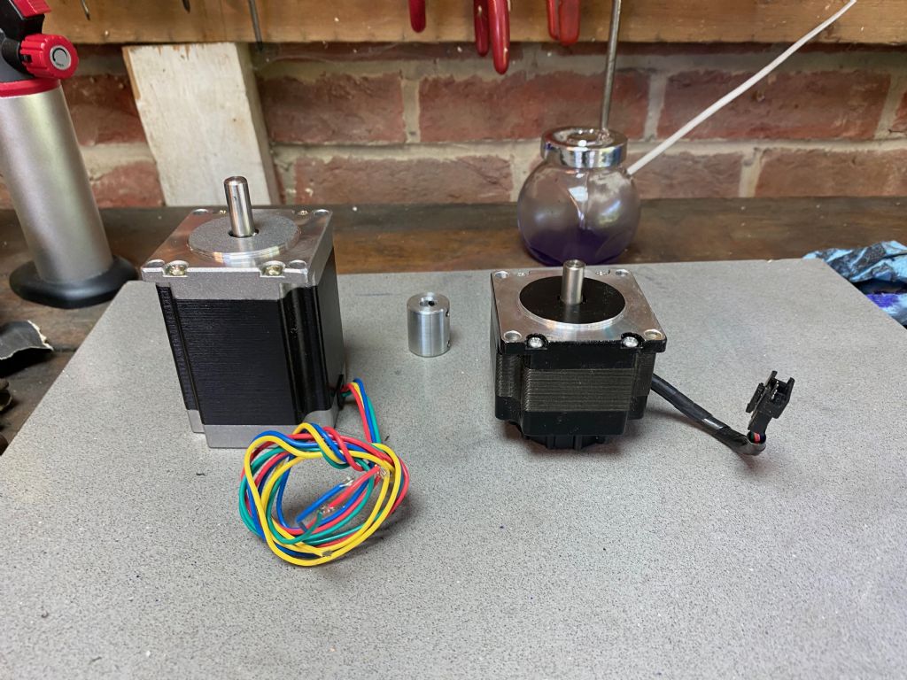

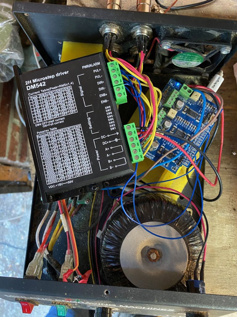

                I noticed though that the vibration was causing the Z axis stepper to lose/gain steps no matter what depth of cut I took. I think the holding torque on the stepper wasn't enough to keep the tool heigh steady. Luckily I had another Nema 23 stepper and driver lying around (for another project) so I swapped the old one out. You can see the old one on the right below, according to a web search it has a holding torque of approx 0.5Nm, whereas the one on the left has a holding torque of 3Nm.
                Spent a happy 10 minutes wiring in the driver and replacing the stepper – I'll mount it properly soon, I promise!
                The difference was night and day, no movement at all in the z axis when taking cuts.
                I was using a 6mm carbide 2 flute end mill on a 2D adaptive toolpath with stepover of 0.4mm and a depth of cut of 0.5mm at a feedrate of 2000mm/min.
                It took about 20 minutes to face the entire surface, and I'm very pleased with the result, the camera makes it look bad, but you can't feel any ridges and it is perfectly smooth to the touch. I just need to take another cut or 2 to get past the marks at the bottom.
                As you. can see, there is now an "extra hole" right at the top, caused by me pressing the wrong button and plunging the end mill straight into the casting.
                Does anyone have any bright ideas about how to fix it?
                I'm wondering about drilling all the way through and threading a piece of mild steel into it, but I'm sure there's a better way.

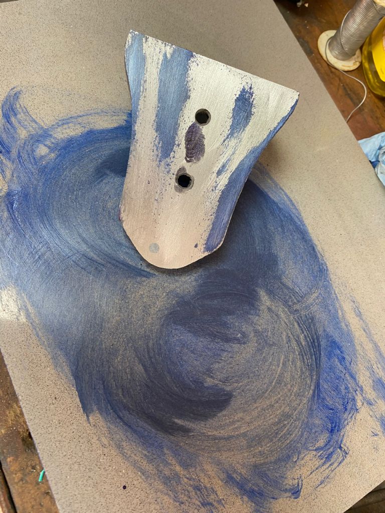

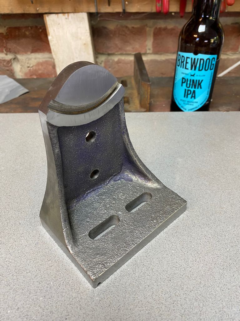

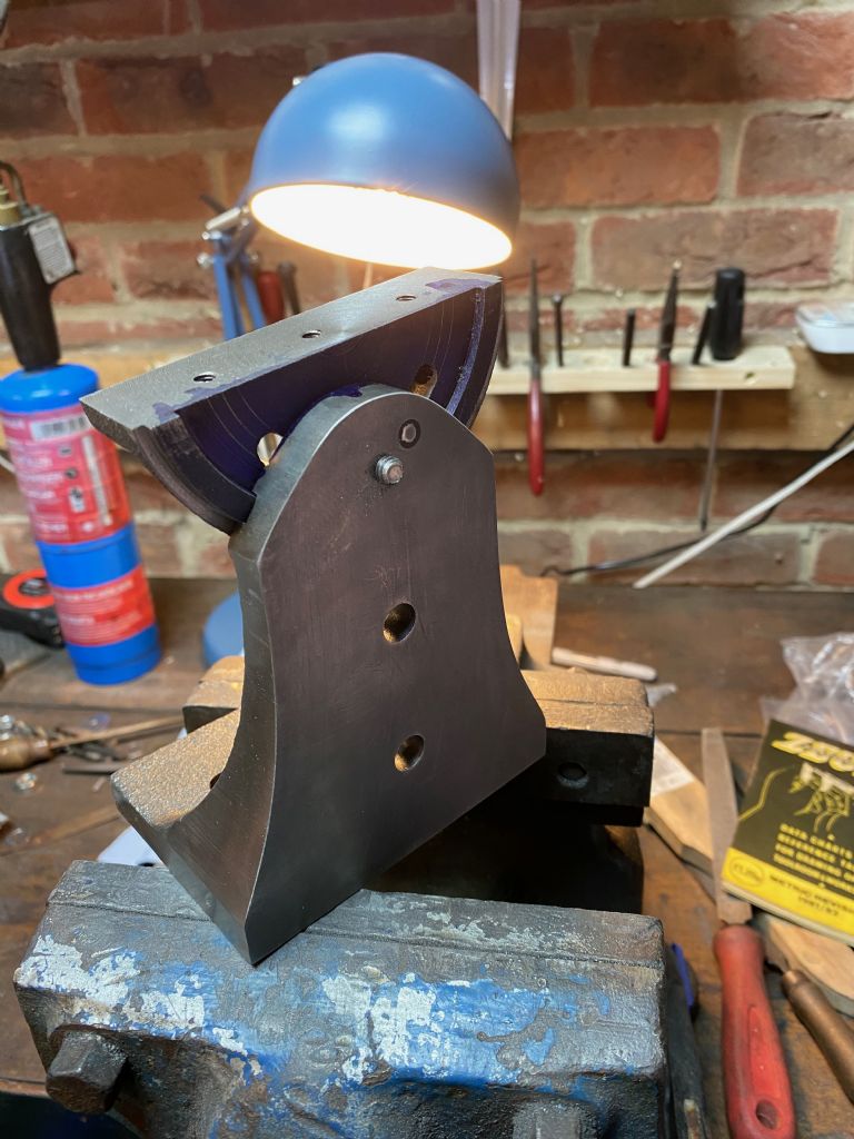

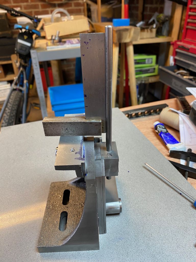

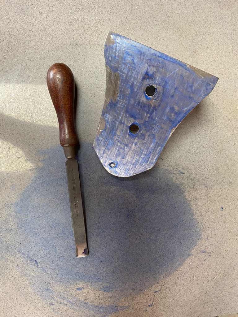

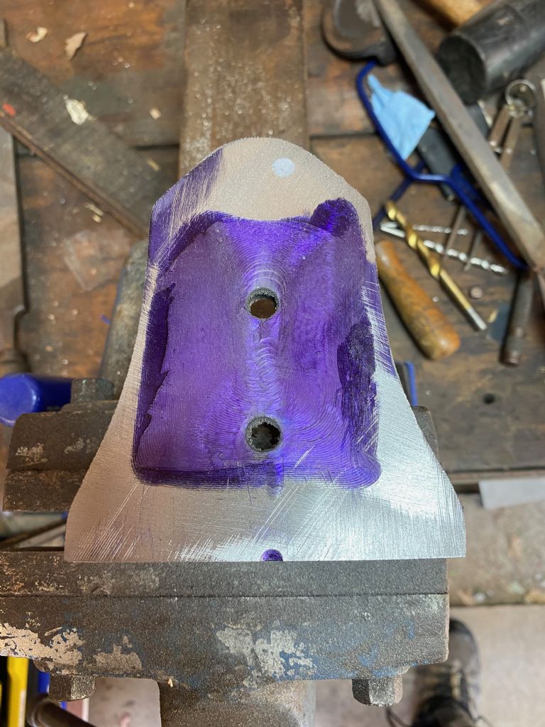

                        So I duly broke out the files and gave it a go. I started by covering the surface with blue layout fluid and then rubbing off the high spots with a (large and flat) diamond stone. This gave me a rough idea of where to file.
                        You can see the deep pocket in the middle where the little CNC wasn't cutting consistently.

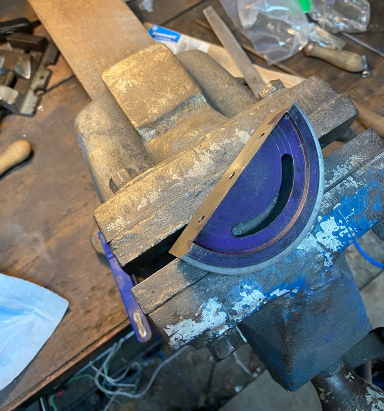

                        After what seemed like a lifetime of filing I switched over to using a thin layer of blue oil paint on the surface plate and a finer file:
                        Then, moved on to scraping it. I've never tried scraping before, but while the result isn't perfect, the low spots all seem to be outside of the bearing surface. I'm declaring it done.

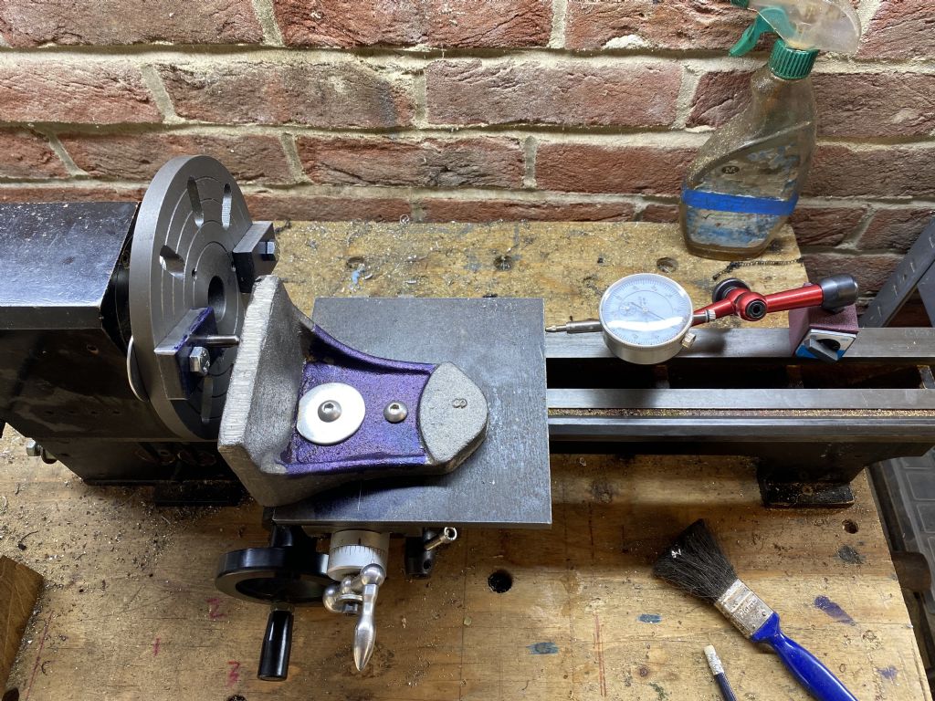

                        Next was milling the top of the other side flat. I had ordered a vertical slide from Arc Euro a couple of weeks back and this was my chance to try it out
                        It worked beautifully! Definitely less work and more fun than filing 😀

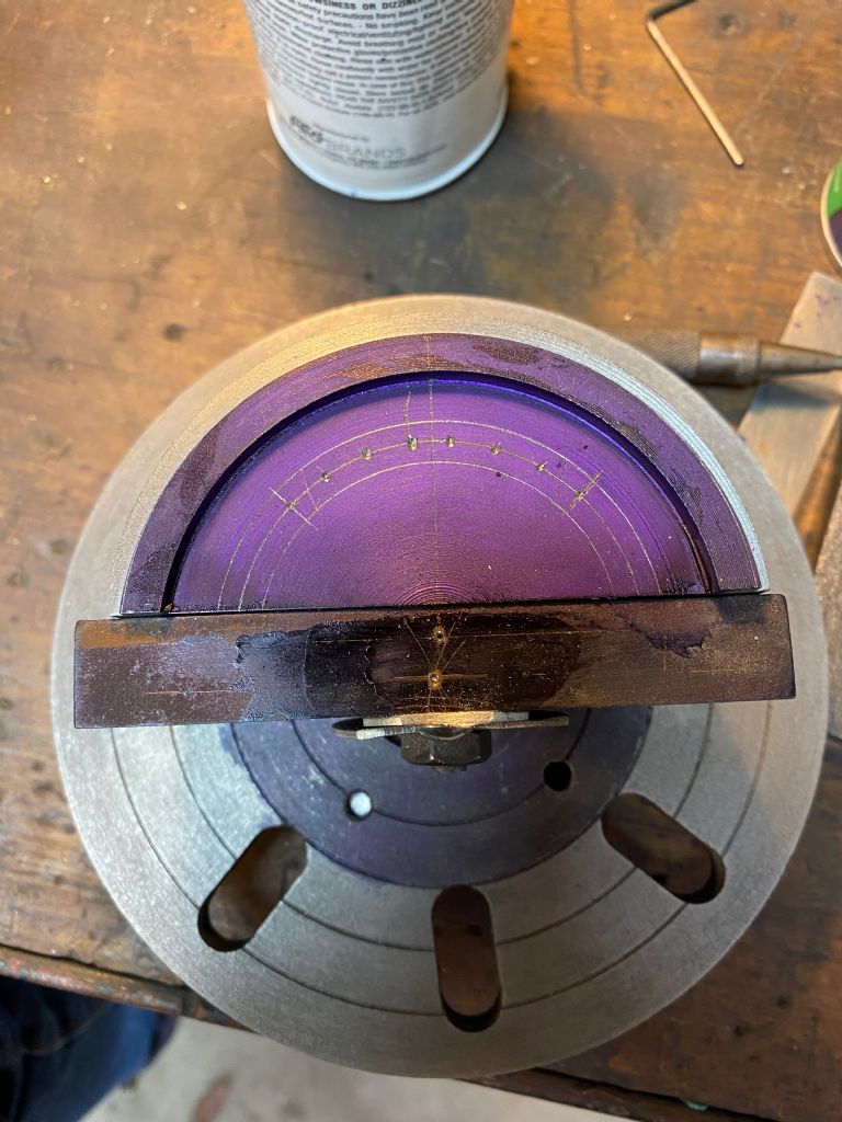

                        The final bit for the day was to mill a (semi) circular groove on the freshly faced surface. I ground up an HSS tool for the fly cutter and set up the workpiece.
                        It took a bit of experimenting with the grind and I had to run the lathe at the slowest possible speed, but in the end I cut the slot in 6 passes, adjusting the length of the fly cutter in between each one.
                        That's it for today. Thanks for reading!

                          Just a quick update:
                          Cleaned up the raw edges on the belt sander and lapped the milled surface.
                          I'm really pleased with the result of machining my first casting laugh

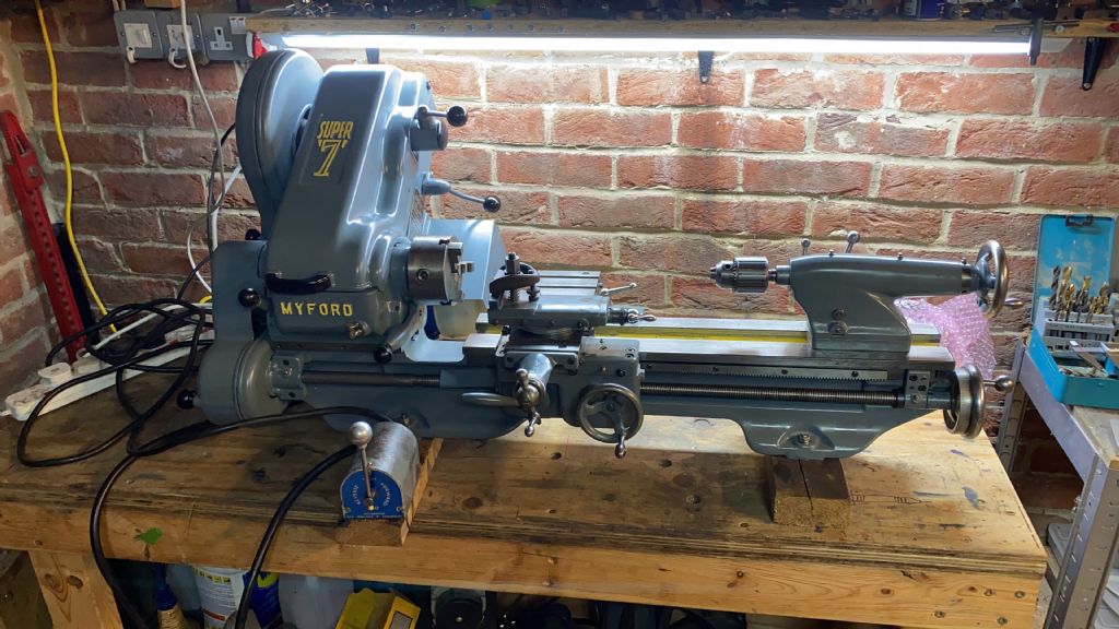

                              Well, progress stalled for a bit on this project, as work got really busy and also I accidentally bought a Myford Super 7.
                              I put a bid in on one on the 'bay thinking I couldn't get it for that price and ended up winning 😀
                              Here it is before I set it up and bolted it down.
                              It took a bit of getting used to, it's a very different animal to my mini-lathe, but I blooming love it.
                              Anyway, once I had sorted out tooling for the new lathe it was back to the filing machine. Next up is the swinging bracket that holds the table.

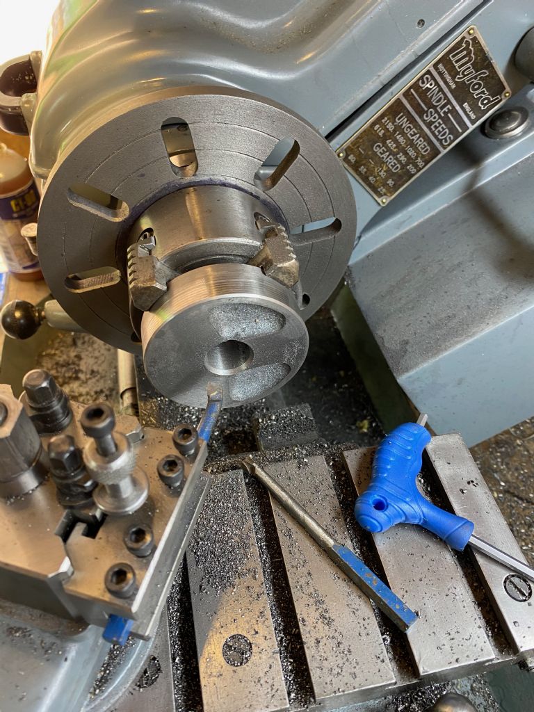

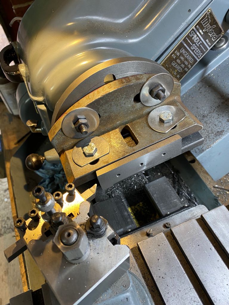

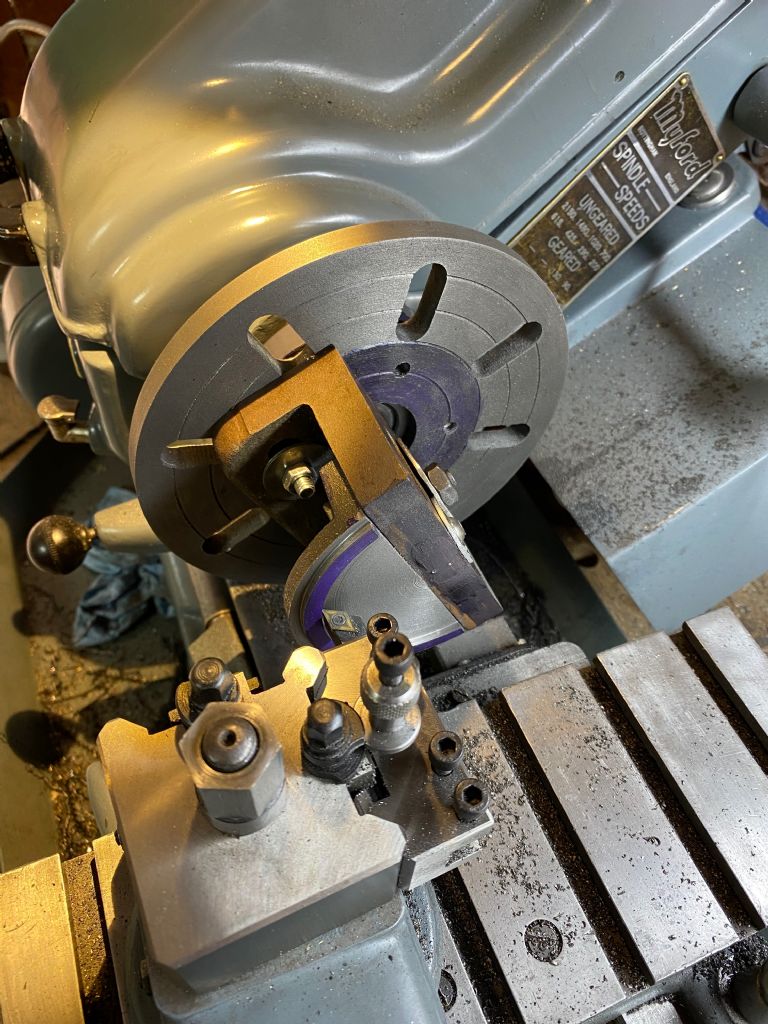

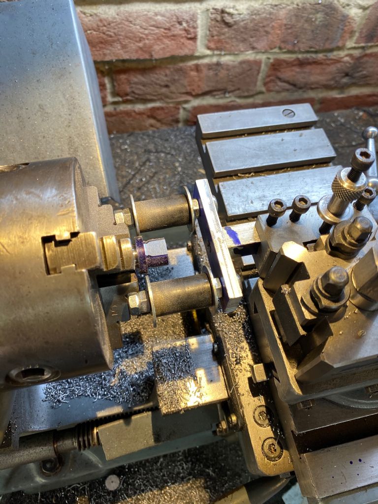

                              One side just needed facing off, so I clamped it to an angle plate on the faceplate and used an old carbide insert followed by a nice sharp HSS tool to finish it.
                              The other side had to have a ledge on it to fit into the slot on the standard, so I clamped it onto a smaller angle plate and marked the arcs for the ledge up. I centered it by lining the tailstock up to the center of the arcs and faced off each side up to the lines.
                              The last operation on this piece was to cut a slot for the bolt which holds it to the standard.
                              I couldn't think of a way of machining it on the lathe, so I ended up marking it out with dividers, chain drilling and filing it to size. This is where having a filing machine would be really handy
                              And finally, the 2 pieces fit together with a temporary bolt in place, next job is to make up the proper bolt and handle.
                              It's a nice sliding fit. Time for a celebratory beer

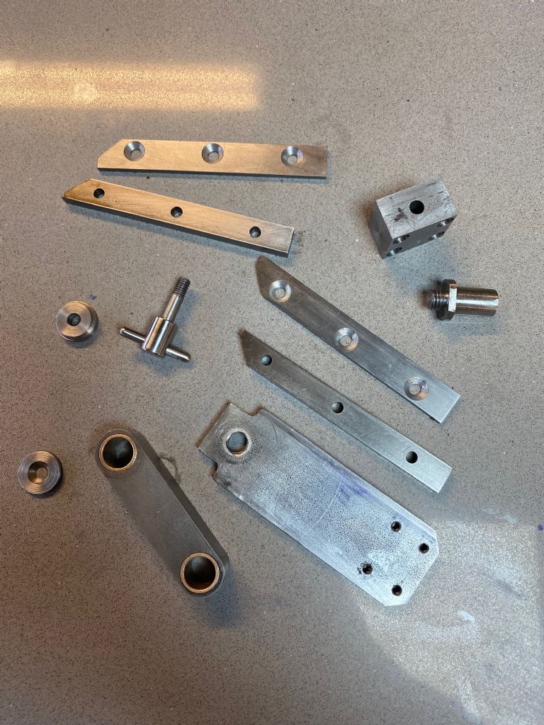

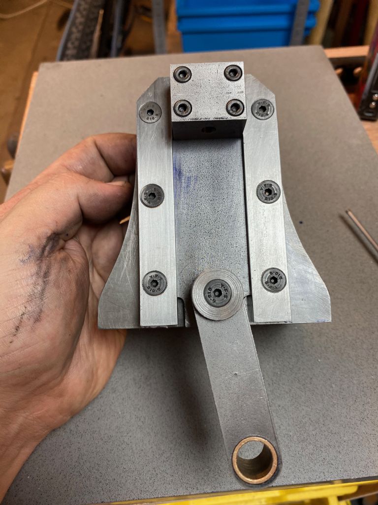

                                  Well, I had a fairly productive weekend in the garage. I needed to face a block of mild steel to make the file holder. Not having a 4 jaw chuck for the Myford, I mounted my mini lathe 4 jaw on the faceplate.
                                  The rest was all just simple turning, filing, drilling, more filing, a bit of threading and even more filing.
                                  By the end of the weekend I had completed the file holder, slide, cheeks, tommy bar, con rod and wrist pin

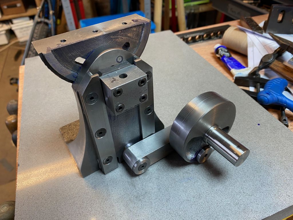

                                    Well, it feels like I'm finally getting somewhere with this.
                                    Spotted the holes through the cheeks and into the standard, drilled and tapped M5
                                    Put everything together and it all fitted first time! The slide has a nice, sliding fit on the standard.
                                    The only issue I had was that the hole in the file holder. wasn't perfectly square to the sides of the file holder. After a bit of filing and bluing/scraping I was rewarded with a lovely alignment between the.top of the bracket and a piece of silver steel inserted into the file holder
                                    Mounted the flywheel/crank in the bodged 4 jaw chuck turned the outside and bored a hole through the middle.
                                    As I was putting a chamfer on the hole, I realised I had cocked up. I had misread the drawing and bored a 3/4 hole instead of a 5/8 one. After turning the air blue for a couple of minutes, I decided that the only downside was that it was now a bit close to the voids (is that the right term?) in the casting as you can see below. I think I can live with that.
                                    The Crank pin was a simple turning job, but needed a square end on it, so i made up a quick ghetto filing guide for the toolpost and squared the end, indexing off the back gear.
                                    And, here's the crank parts all finished, the slot still needs a bit of tidying up, but it all fits fine.
                                    Obviously I couldn't resist putting it together.
                                    And (after oiling it) trying it out on the lathe. It runs!!!
