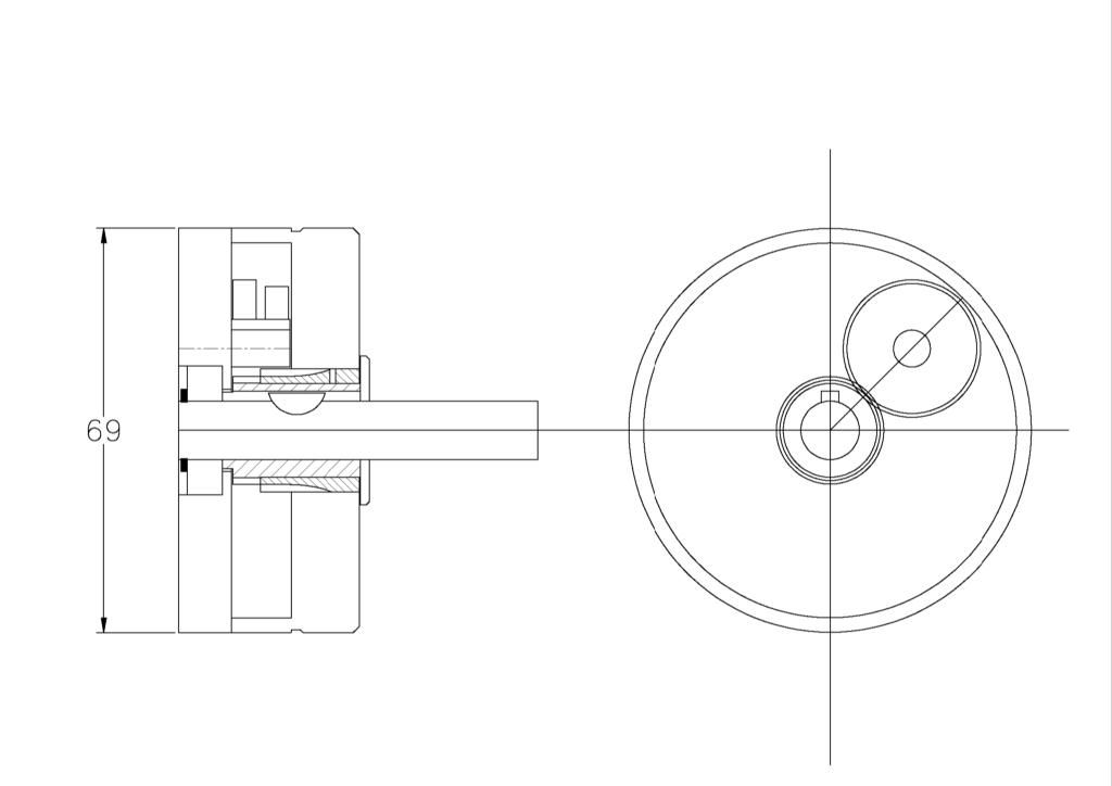

      For those who’ve had dificulty understanding or visualizing the mechanism being discussed in this thread, here is a sectional drawing of a version to suit the Seig C3 lathe.
      Best option is to click on the drawing, then download it for better study.
      Looking at the left drawing, on the left the feed screw passes through a bearing as it extends out through the dial. Immediately to the righ of the bearing is a sleeve keyed to the spindle of the carriage handwheel on which a gear is cut. The center gear drives an outer gear on a layshaft which, via a second gear at the right end of the layshaft, passes the drive back to a aecond sleeve running on the outside of the first one. This second sleeve is attached to the micrometer dial which surounds the mechanism and thereby also serves as the housing for the mecahnism.
      The unit shown is setup for metric readout but an alternative to read out in inches has already been engineered. Based on the gears provided the micrometer dial can be made to rotate faster or slower than the handwheel spindle so that instead of reading out revolutions of the handwheel it reads out distance traversed by the carriage. This can be built to read out in decimal millimeters down to 0.025 mm or decimal inches down to 0.001″.
      Very effective when doing precision work.

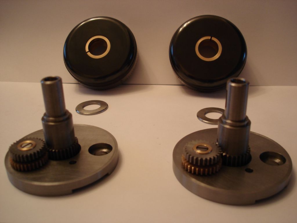

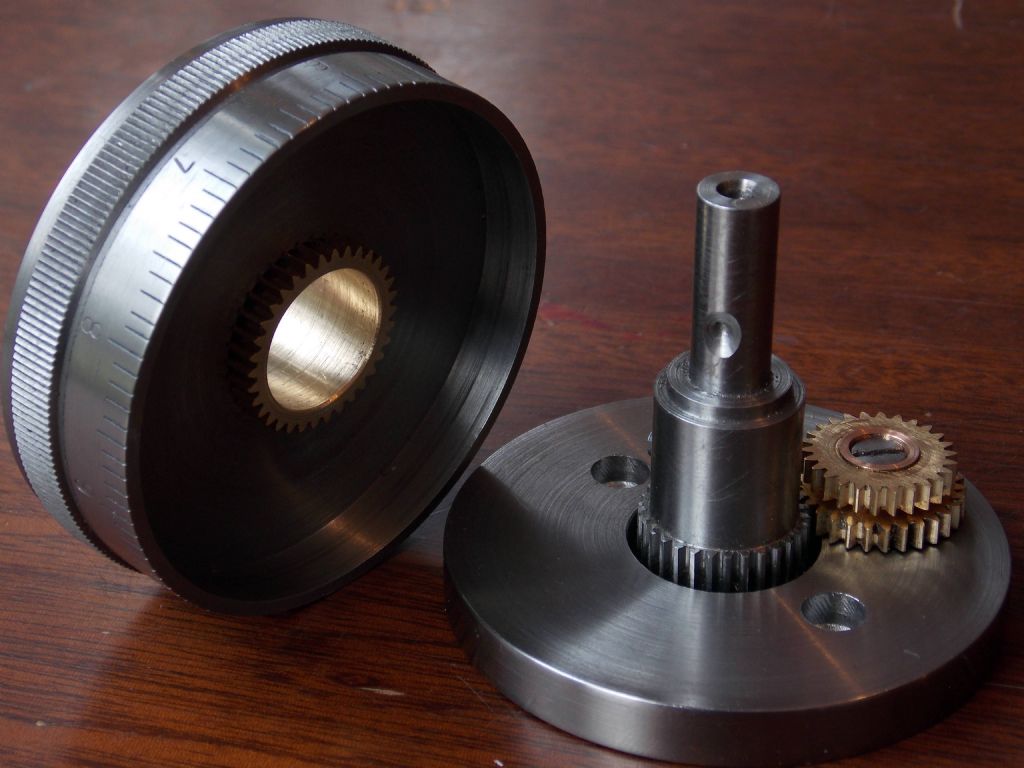

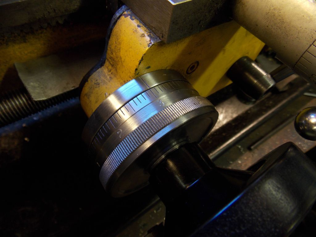

                            With Gray's drawings, and advice I have just finished and fitted the C3 version of his handwheel dial to my Clark CL300M, one of the 'generic' mini lathes.
                            Important things to note for anyone trying this version are:
                            • The handwheel spindle is 8mm diameter (Gray warned me to watch for this, but I missed it!)
                            • My rack was pitched slightly differently at 0.766" for a turn of the handwheel (five teeth on the rack) but by increasing the gear pairs to be 30:30 and 34:26 I was able to get a theoretical accuracy of two thou over the inch.
                            • The extended handwheel just fouls the end of the cross-slide ball-ended handle. I took a 0.3mm cut off the outer surface (which then covered all my beautidful work with black dust). A fine foam backed abrasive block brought back a neat finish, but somewhat speckled compared to the original!
                            To my astonishment (given that I changed the gear ratio, not becauise I doubted the design) it works just as it's supposed to, with 1.002" of saddle movement for 1.000" on the dial.
                            Here are a few pictures, but first I'd like to thank Gray, not just for his support and great design, but for encouraging me to acheive a level of fit, finish and accuracy a step up from my usual. It's not quite toolroom yet, but I think it looks OK.
                            The working parts in place:
                            Leadscrew dial in two parts
                            My first attempt at a sraight knurl(!) – I cut away the numbers and re-stamped them after this was taken (the bad ones are hidden):
                            Knurling
                            And finally, tehdial on place on the lathe:
                            Leadscrew Dial  in place

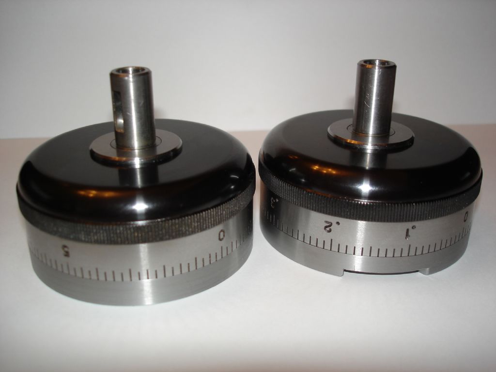

                                    Here are three photos of my efforts at Gray's dial for the Myford 7 lathe. There is an Imperial and Metric version here.
                                    Steve.
                                    Handwheel dials for Myford 7 lathe
                                    #117510
                                    Steamer1915
                                      @steamer1915
                                      Thank you Gray, not only for your comments but the excellent design also.
                                      Steve.

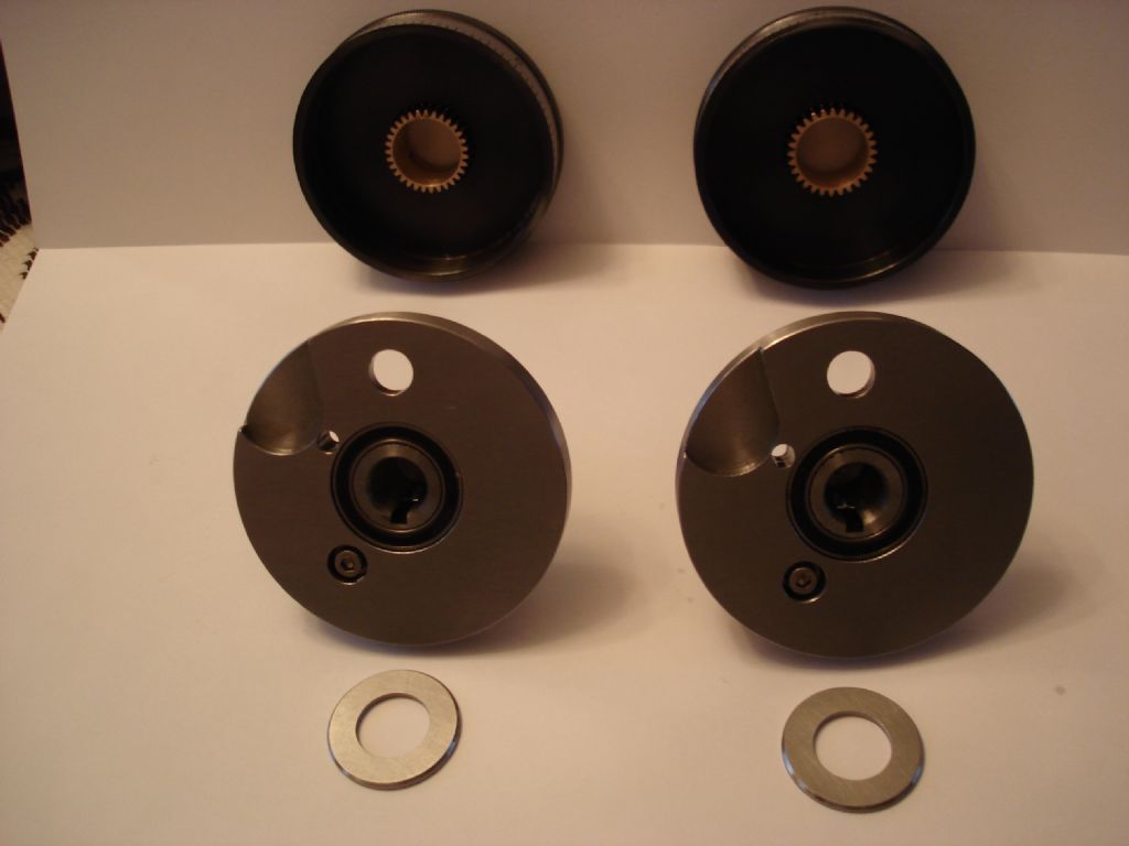

                                              I'm now waiting for a new gear cutter (40dp) But still work in progress.
                                              Difficult to make, but it is a nice practise to learn to work with my (Myford S7BXF) lathe.
                                              here some pictures of my work piece.
                                              On this picture carving the lines with a  dividing attachment, a multi stop and a rodney mill,(using a internal screw cutter)
                                              Sometimes it went wrong…
