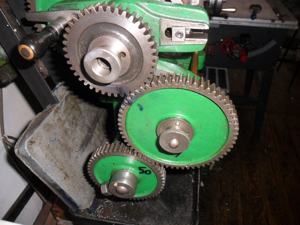

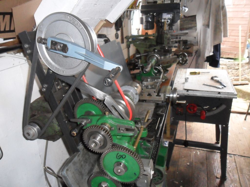

                                            #75272
                                            Nobby
                                              @nobby
                                              Hi Andy & Guys
                                              The gear train was no problem 40 – 60 idle- 50 leadscrew as photo .When engaging screwcutting lever photo on a test peice After disengaging lever the the 2’nd cut did not line up . On my Exe lathe I sold there was no problem . I know i can use the revering trick I have no reverse on this lathe . I suppose if I put the pedal back on I could use this trick Can I add a threading indicator some how . ?
                                              Regards Nobby
                                              #75290
                                              Anthony Rhodes
                                                @anthonyrhodes37318
                                                Posted by Nobby on 22/09/2011 11:49:54:
                                                Hi Andy & Guys
                                                Regards Nobby
                                                Nobby,
                                                For the dog clutch to pick up all threads reliably it has to be before any changes in ratio and have a single dog. This is how the Exe is setup and is not how the Drummond is setup.
                                                Reversable motors are common, reverse pedalling would work, and a hand crank you insert in the back end of the spindle is another solution.
                                                Yes, you can install a threading dial. Look at any Myford or Boxford or most other lathes to see how they are set up. Most are for 8 TPI, does have to match right hand or left hand leadscrew thread. Usually mounted on right side of apron, needs to be able to be swung into and out of engagement with the leadscrew and hold in either position. When mounting you may have to shim the dial away from the side of theapron until the graduations on the dial line up with the witness mark when the split nuts are closed.
                                                Anthony
                                                #75305
                                                Nobby
                                                  @nobby
                                                  Hi Andy & Guys
                                                  It was only a short thread about 5/8″ so I fitted a crank handle As Andy suggested NobbyIi
                                                  Edited By Nobby on 23/09/2011 00:43:14
                                                  #75306
                                                  Anthony Rhodes
                                                    @anthonyrhodes37318
                                                    Posted by Nobby on 23/09/2011 00:42:31:
                                                    Hi Andy & Guys
                                                    Nobby,
                                                    Try “Anthony”. Thanks for the photo.
                                                    Anthony
                                                    #75623
                                                    Nobby
                                                      @nobby
                                                      Sorry Anthony
                                                      Great idea saved me some trouble.
                                                      Nobby
