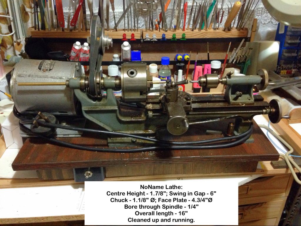

      Another machine into the Workshop from the shed.
      It needs the chain oil cleaned off, as I covered it with the stuff before it went into the shed.
      No name visible, but it appears well made.
      The screw feed for the saddle has a RH thread, so if was case of "OH" when I twiddled the knob after oiling up surprise

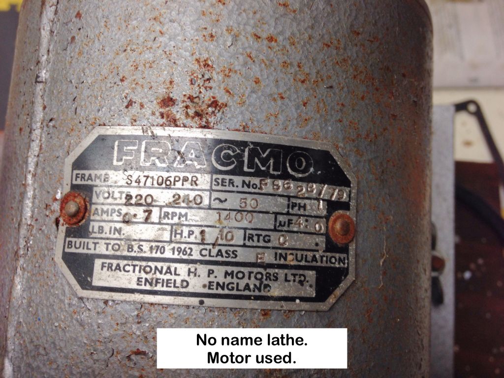

      There is a capacitor under the base.
      Had to make a chuck key and need a set of turning tools.
      Any info about it would be appreciated.
      Geoff – No wind! End of the World is nigh crook

        Does anyone have any info on it please?

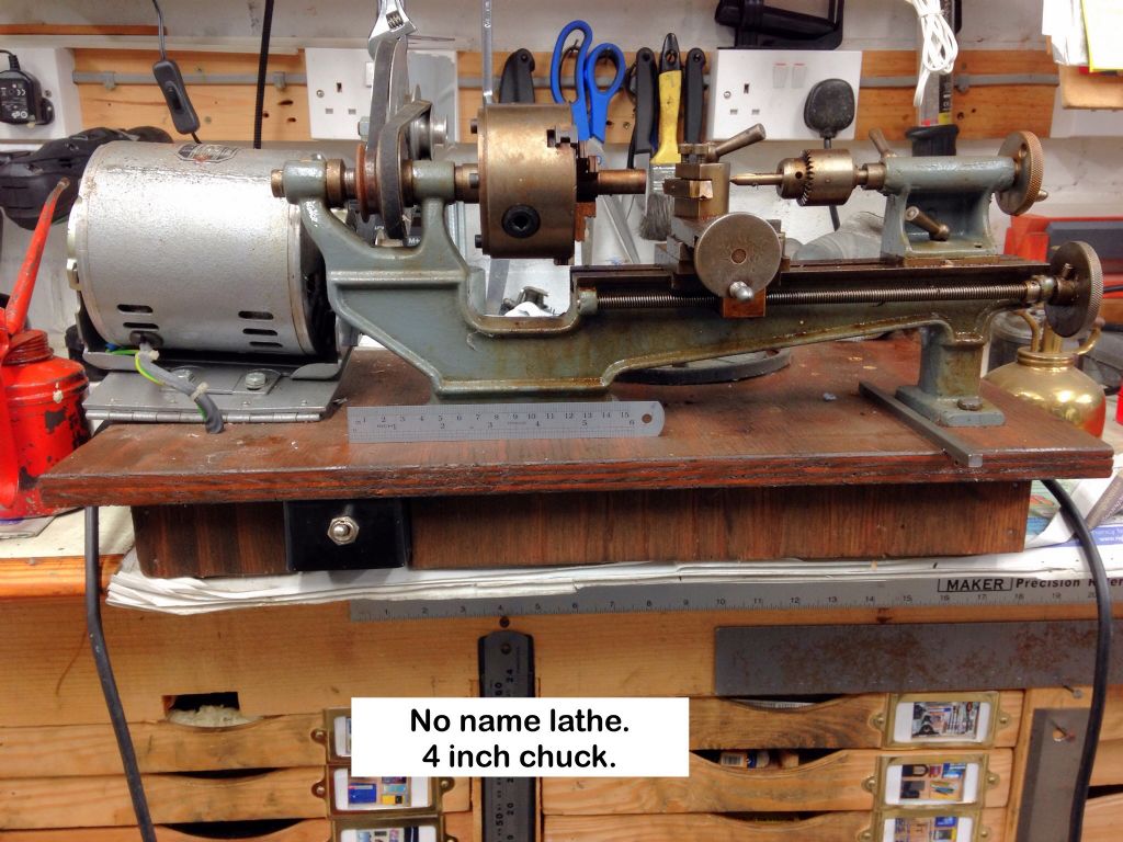

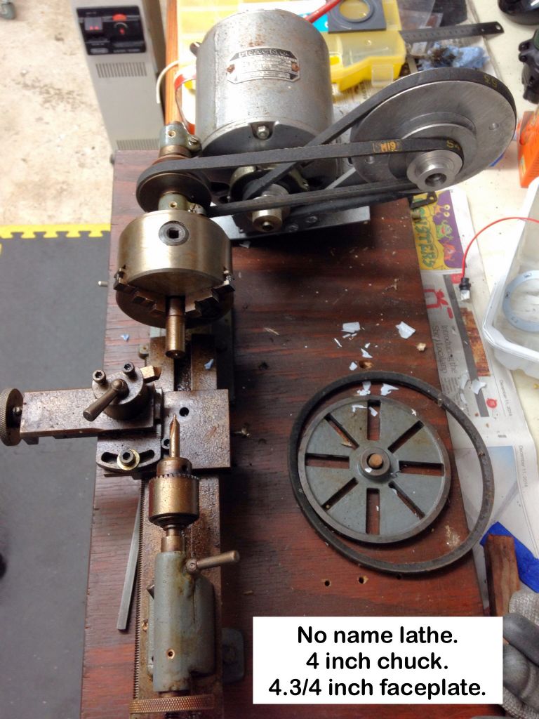

        Ralph H
          @ralphh
          Looks very much like one of the small lathes marketed by S.Tyzack's (Zyto's etc.) after the war or one of the Adept series by Portass from just before. There were several models in those series' that all looked slightly different.
          I'd hit lathes.co.uk under one of those names. Your lathe looks very much along their lines.
          #185316
            [assuming that it's original equipment]
            That toolpost looks sufficintly unusual to be a good identifying feature.
            … Happy Googling
            #185391
              Centre height about 2 1/2"?
              I bet that 4" chuck isn't original…
              Working through THIS list should keep you happy for a few minutes.
              The bed resembles the Flexispeed, but is obviously bigger. It may be one of Brian Perris' designs.
              Edited By Neil Wyatt on 03/04/2015 14:48:23
              #185394
              Clive Foster
                @clivefoster55965
                The bracket supporting the end of the lead-screw just short of the gap and the rather nice swivelling top slide should be diagnostic as to the maker and suggests the lathe was originally sold at a relatively high price for this style of machine.
                Generally the top slide only, lead-screw shorter than the bed lathes were bottom of the range machines made a simply and cheaply as possible to be affordable by impecunious purchasers. The extra lead-screw bracket and nice top-slide on this one must have pushed up the cost somewhat. Most makers felt that full length lead-screws permitting screwcutting and / or incorporating both cross and top-slides would be more attractive to a customer able to spend a little more.
                Cllive

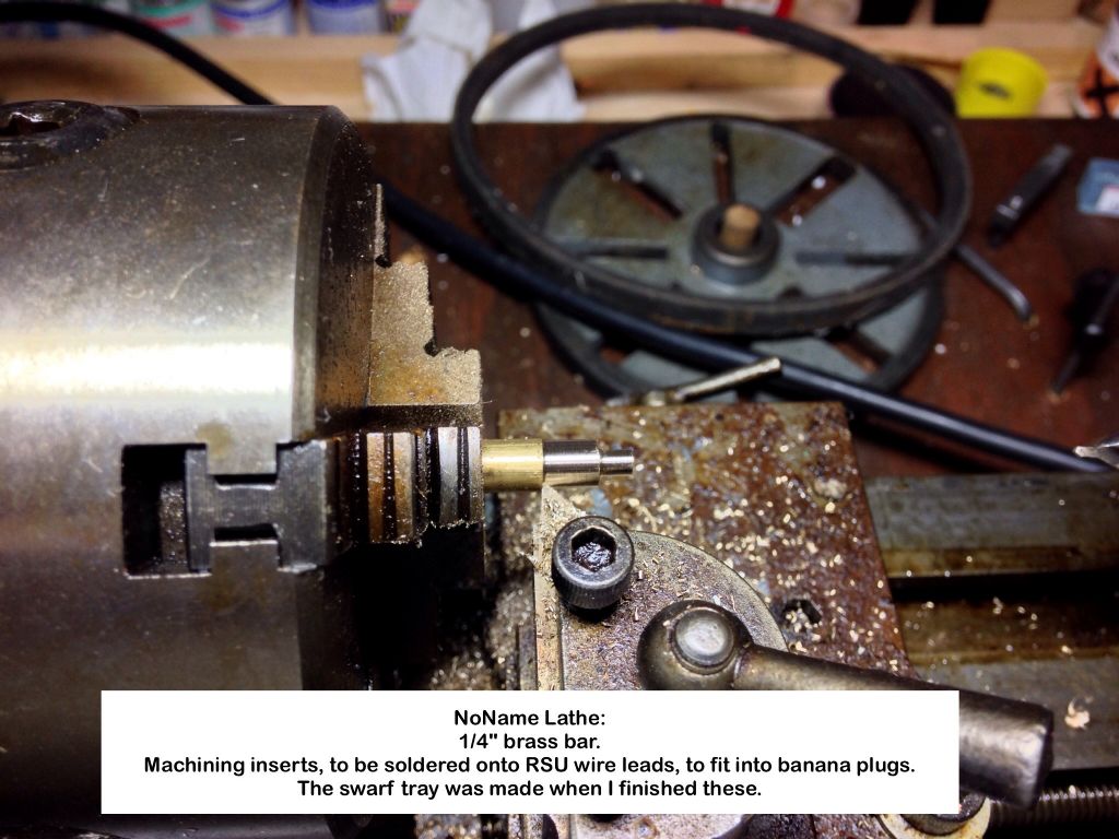

                  More details:
                  NoName lathe.
                  Used it for the first time last week, making brass parts for the RSU.

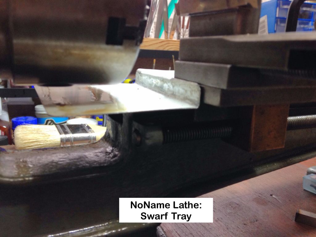

                  Swarf where not needed so made a suitable tray yesterday.

                        Ian S C
                          @iansc
                          A lathe like that probably came with a 3" four jaw chuck if any, maybe a 4" face plate. Looks a useful little machine.

                          OuBallie
                            @ouballie
                            Ian S C,
                            Having used it now to make parts for the RSU tweezers, and can confirm it's a pleasure to use.
                            Far better than my first 'lathe' an Emco Unimat, that I now wish I kept in order to use it as a Toolpost grinder.
                            Did have a wtf moment when the centre drill just would not do as designed, and kept heading off to the right of the brass.
                            I checked everything, tried a larger centre drill but that did the same.
                            Being seated whilst machining, I couldn't see the tool bit. See where I'm going
                            The taper on the centre drill was coming up against said tool bit, and being deflected!
                            I had kept the Cross-slide at the final setting for the brass plugs, to save measuring each time.
                            Small has limitations.
                            Geoff – What a relief to find it wasn't something serious.

                              It's a Flexspeed.
                              http://www.lathes.co.uk/flexy/index.html
                              You owe me one now, Geoff – how about writing an article for me

                              Muzzer
                                @muzzer
                                Posted by Neil Wyatt on 15/09/2015 19:53:54:
                                It's a Flexspeed.
                                Hmm. None of the machines on that page have a foot under the tailstock and other details differ. It' certainly looks as if it's got some Portass / Zyto / Tyzak genes in it though, so probably from that neck of the woods (Sheffield?)
                                Murray
                                #204419
                                Roderick Jenkins
                                  @roderickjenkins93242
                                  More like this Portass S type:
                                  **LINK**
                                  Rod
                                  #204429
                                  Muzzer
                                    @muzzer
                                    …which is pretty much identical to mine.
                                    Again, quite a few differences like the split head bearings, tailstock design, carriage and slide, even if you overlook the lack of back gears, banjo etc.
                                    #204491
                                    Ian S C
                                      @iansc
                                      According to an article in an old ME, casting for lathe beds were available at many small foundries around the UK in the 20s/30s, there was a story of one chap riding his bicycle a number of miles to collect his, so maybe this is where it started life. There would be similarities in the bed, but the fittings may vary from lathe to lathe as each builder put in his own ideas.
                                      Ian S C
                                      #204502
                                      Ralph H
                                        @ralphh
                                        Britannia in Colchester used to supply beds and all other lathe parts separately in all different sizes for people who wanted to build their own. This continued up until the last war.
