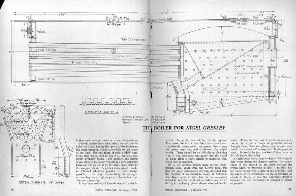

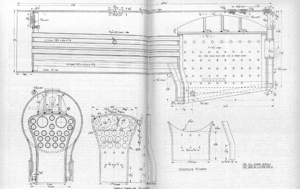

                            There are two designs for the boiler one with a thermic syphon and a simpler one with out and I'm part way through building “Nigel Gresley” so I have all the drawings and articles
                            Bob

                              Bob Brown 1
                                @bobbrown1
                                Martin,
                                I've put some pictures/drawings of the two types of boiler which may help, for a 5" loco it is a big boiler.
