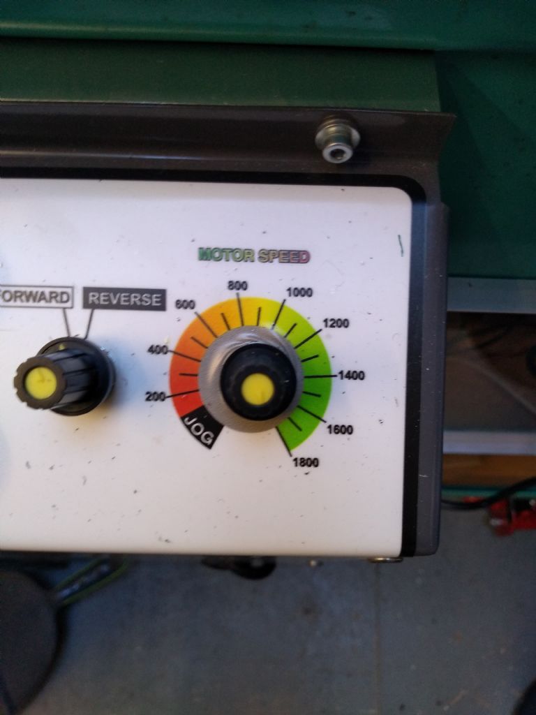

      If you have a Newton Tesla Speed controlled motor on your lathe can you tell me if the RPM read out on the unit is directly proportional to the machine speed?
      What I am thinking hear is, can I use a formula to work out the actual vs. displayed rpm or do I need to fit a rev counter on my lathe?

                The read out on the vfd is frequency, but machine speed depends on belt ratio and back gear settings, so you'd need a chart with 6 lines. If you can fix a magnet to the mandrel somehow you could make a tacho like I described some time ago. PM me if you're interested. Or does anyone know of a sensor which would detect gear teeth (Myford size)

                  The quick answer is yes, there will be a relationship from which you can estimate the RPM.
                  But this will depend upon the type of VFD, (vectored or not), the various loaded parameters and likely only valid for no load or constant load conditions.
                  The other question is WTF do you need to know lathe RPM to any degree of accuracy?- it tells you nothing.
                  The approx speed is usually more than adequate if you don't want to fit a spindle counter.
                  This was achieved in my case by using a linear control pot and setting the min and max frequency of the VFD to give the desired min and max motor RPM in line with manual belt speeds at min and max pot positions (usually 1400 to 1500 for a 4 pole).
                  Then print out a 0 to 100 dial for your control pot, so the approx spindle speed can be determined by the dial percentage times the max speed at any particular belt setting, plus or minus say 10%. Therefor if your pot setting is 40% and the full speed would be 600 RPM at the given belt setting, then 40% of 600 would be about 240 +/- 20 or 30 RPM.
                  As a caution, I would not drive the motor for high load operations at any less than about 20% of full pot deflection. If you have a fancy vectored thrust unit, you may be able to go to lower frequencies without cooking your motor.
                  I would add, that my experience has been the lower the frequency, the larger the range of  speed variation under load. But then I am partial to the cheapest and nastiest VFDs money can buy, so your mileage may vary.

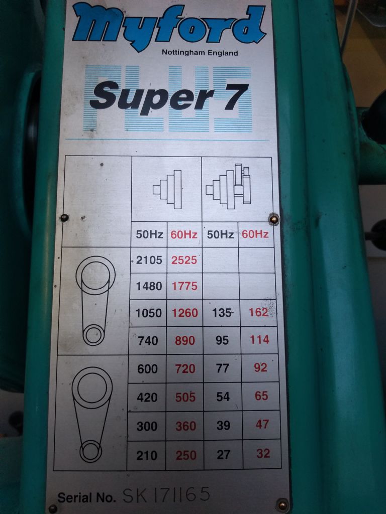

                      Data from my just fitted NT unit on my Myford S7. Dial is calibrated in rpm, from just below 200 up to 1800. However this would be rpm for a synchronous motor – actual max frequency from the unit is 60 Hz (from the manual).
                      The lathe plate gives spindle speeds for different pulley combinations for 50 and 60 Hz.
                      Actual measured speeds at max frequency are as follows for the lower speed range..
                      Actual Plate
                      288 250
                      396 360
                      542 505
                      748 720
                      These speeds were measured by Mach 3 from the spindle sensor.
                      Obviously if you have a lathe with different pulley ratios the numbers would be different but basically if you increase the maximum speeds in each "gear" by 20% (i.e. 60/50 – 1) and scale that by the dial setting/1800 you will get pretty near.
